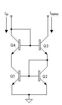

From Wikipedia -
(Adding a fourth transistor to the Wilson current mirror (as shown in the diagram to the right) improves its linearity at higher current levels. It accomplishes this by equalizing the collector voltages of Q1 and Q2 at 1 Vbe. This leaves the finite beta and voltage differences of each of Q1 and Q2 as the remaining unbalancing influences in the mirror.)
You are correct about the output impedance of a cascoded mirror being higher.
Regards
Jam

Thanks for posting the paper about current mirrors. I add the emitter resistors also because the current in the two legs is better balanced when the transistors are not well matched. There is a plethora of other current mirror designs but actually your solution is working well too.

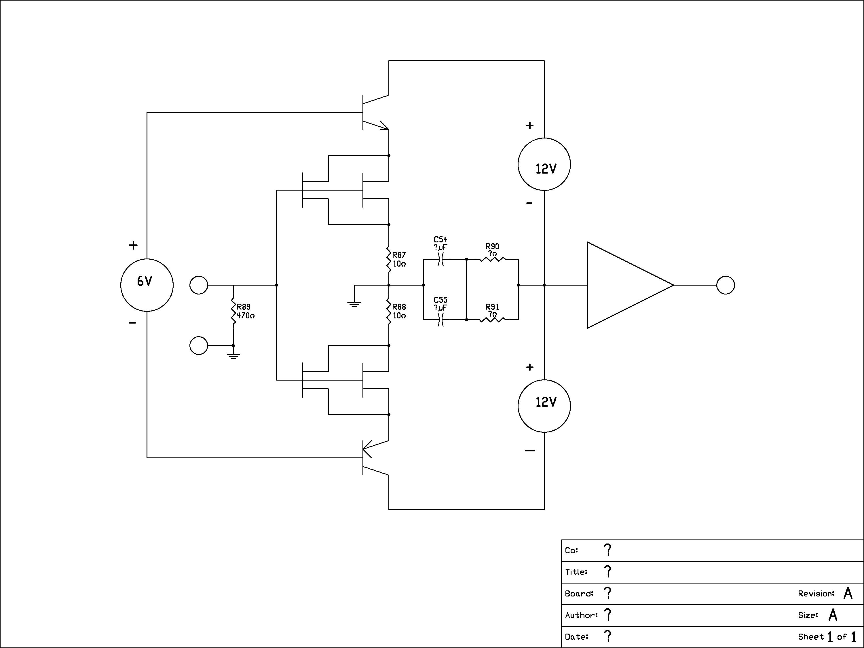

Hello Joachim,
Once again thanks for shareing all the schematics and ideas.
Returning to the Hawksford topology, the use of fets as input devices simplyfies things considerably, not shure how much gain could be had from the circuit.
Any comments?.
