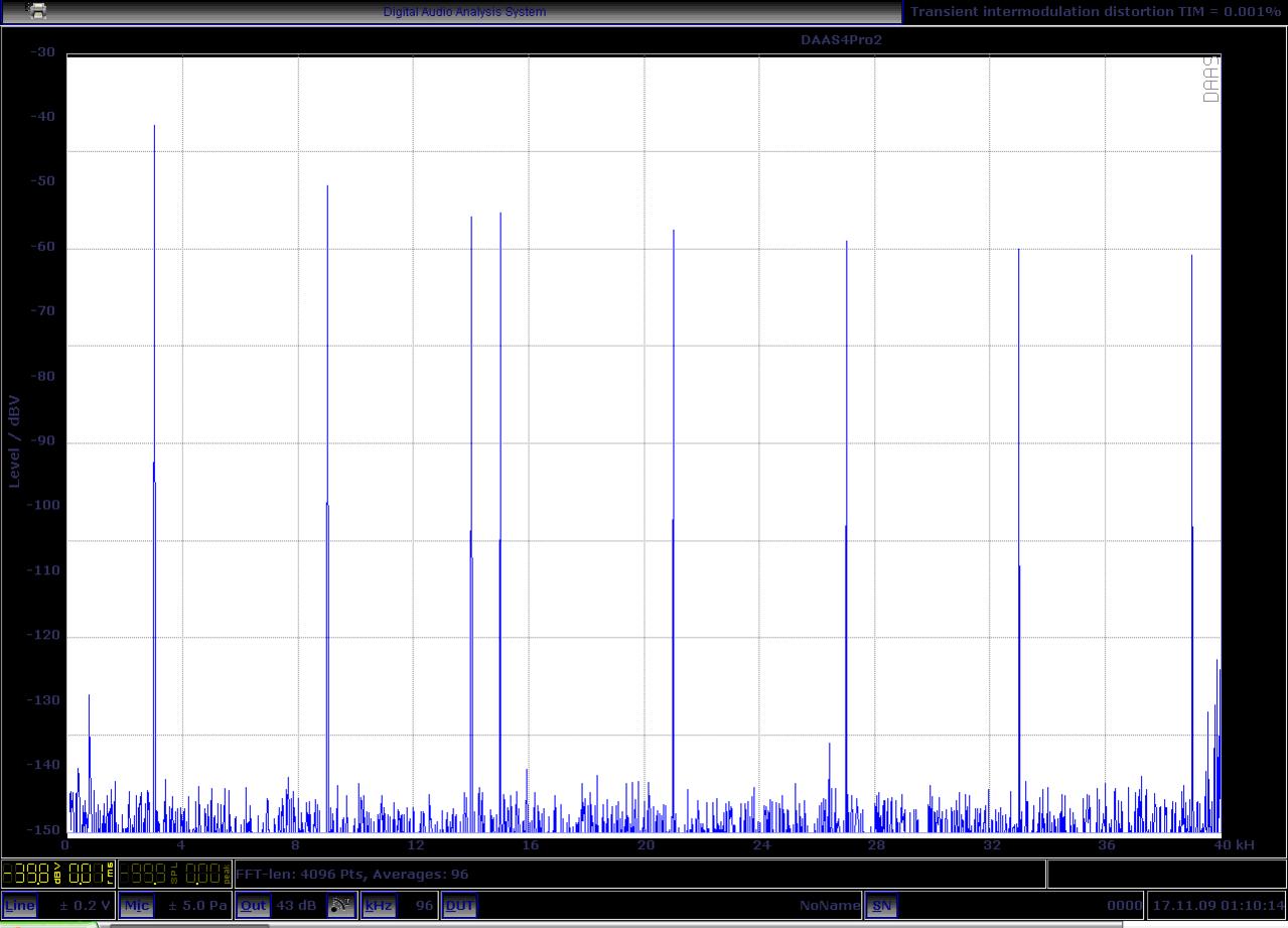

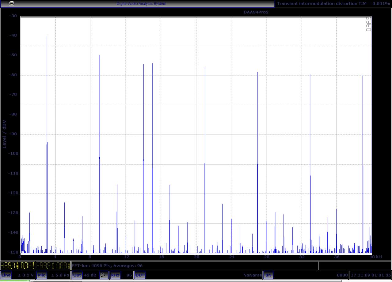

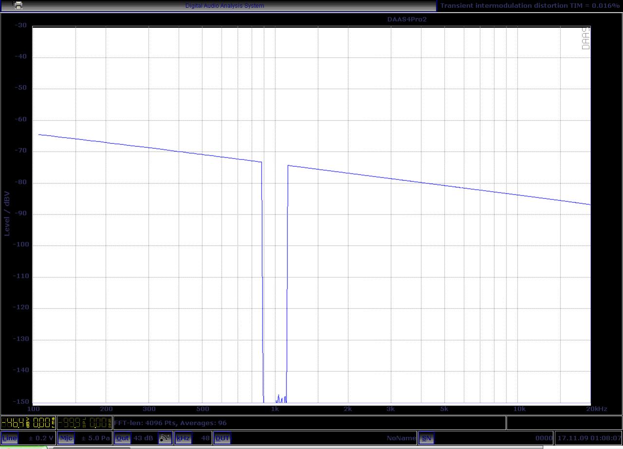

here comes the squarewave TIM measurement of the Goldstandart.
I show the Paris here again for comparison (2nd picture from left)
the picture on the right shows the MPP output stage.

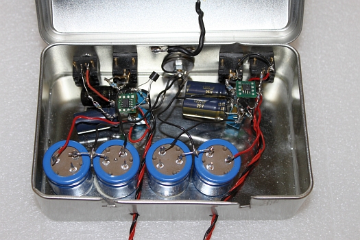

So the MPP works now. What to do next ?
If i whould build it the next time i whould certainly thermocouple the input-stage because there is still a little bit to much DC fluctuation. the servo is quite slow so it can be up to 10mV at the ouput at times. Today i tried a DC adjustment on the cascode stage that can minimise DC offset from the input stage but the cartridge has to be connected and the amp warmed up for say 20 minuts to do the adjustment. a servo could be used on the inputstage but i rather would like to avoid that for simplicity sake. and i really whould like to spare me the discussion if a servo could do any harm at that point of the circuit.
also i may not use the MAT02-03 in my next build because i fried an expensive set during experimentation. i also have the SSM parts that are also low noise matched pairs and they are considerable cheeper although some people claim that they do not behave the same (they are not so easy to source any more but with some patience you can get them). If you are prepared to pay a premium take the MAT02/03 for piece of mind. they are excellent and have prooven to work well in this topology. there is a THAT chip that has 2xPNP and 2xNPN on one chip and could be interesting too. i also have a big collection of low noise bipolars from ROHM and Toshiba so i should have some luck to find well matched octets.
I plan to build the unballanced version next and will eventually make a stuffed and tested PC bord of that version availlable in different quality levels.
it will be interesting to compare the two versions soundwise. the unbalanced version certainly has a 3dB noise advantage and much simpler topology but my reference is the Goldstandart that has a balanced input and is sofar the best sounding device i made.
i also started to look at a powersupply for the MPP and Salas is helping me here.
for the time being i used 9V alcaline batteries buffered with Low ESR Elcaps. Today i switched to a low noise supply from LC audio that works well too and is not expensive. i think they charge around 57,--€ plus tax and shipping for a +- 12 V supply (actually it is adjustable) and it comes with transformer too.

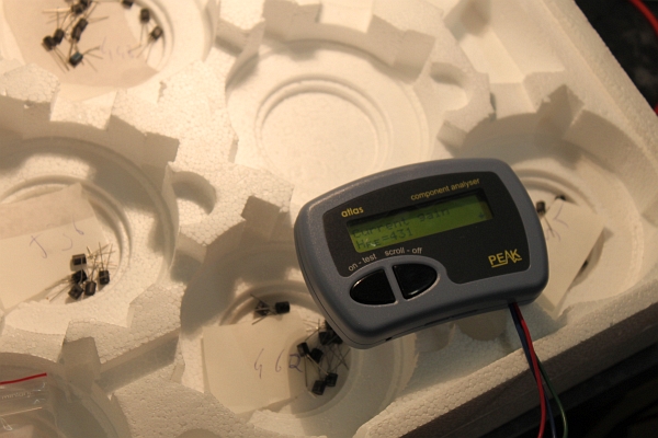

When i build the next version of the MPP (unbalanced) i will use ROHM transistors that have a much better Gain match of NPN and PNP devices then the MAT02/03 combination has.
You can bet on that. Because of the manufacturing process, all ultra low noise devices (ROHM, Hitachi, Toshiba, Sanyo) have little spread of beta and it's even better if they come from the same batch. I recently got a small stock of ROHM devices and, while they are not in the highest beta class, they match within 5%. Sorting for 1-2% is a breeze.

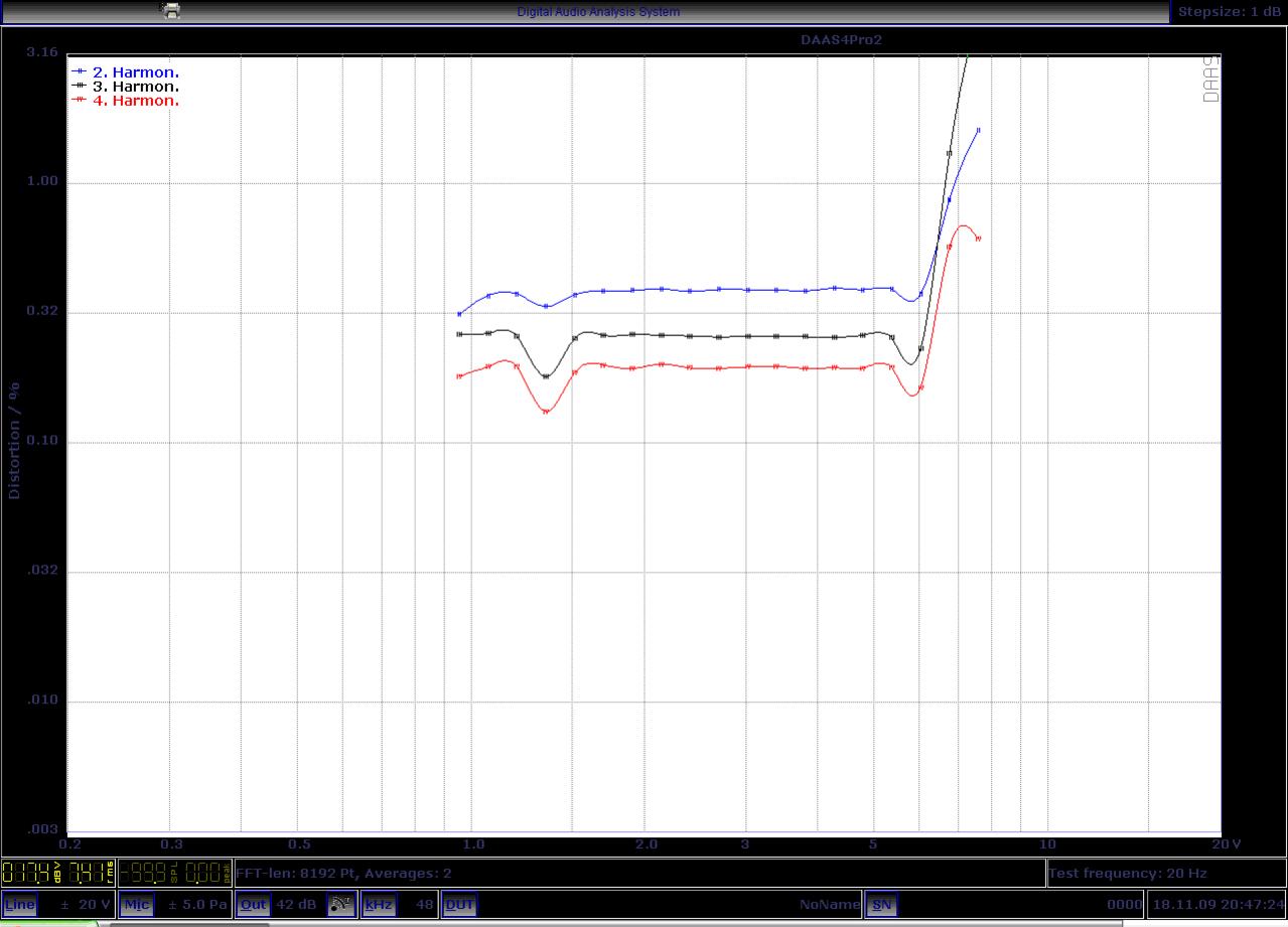

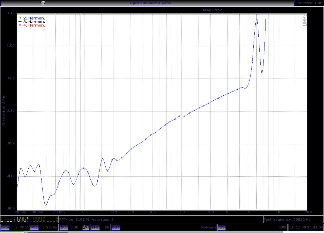

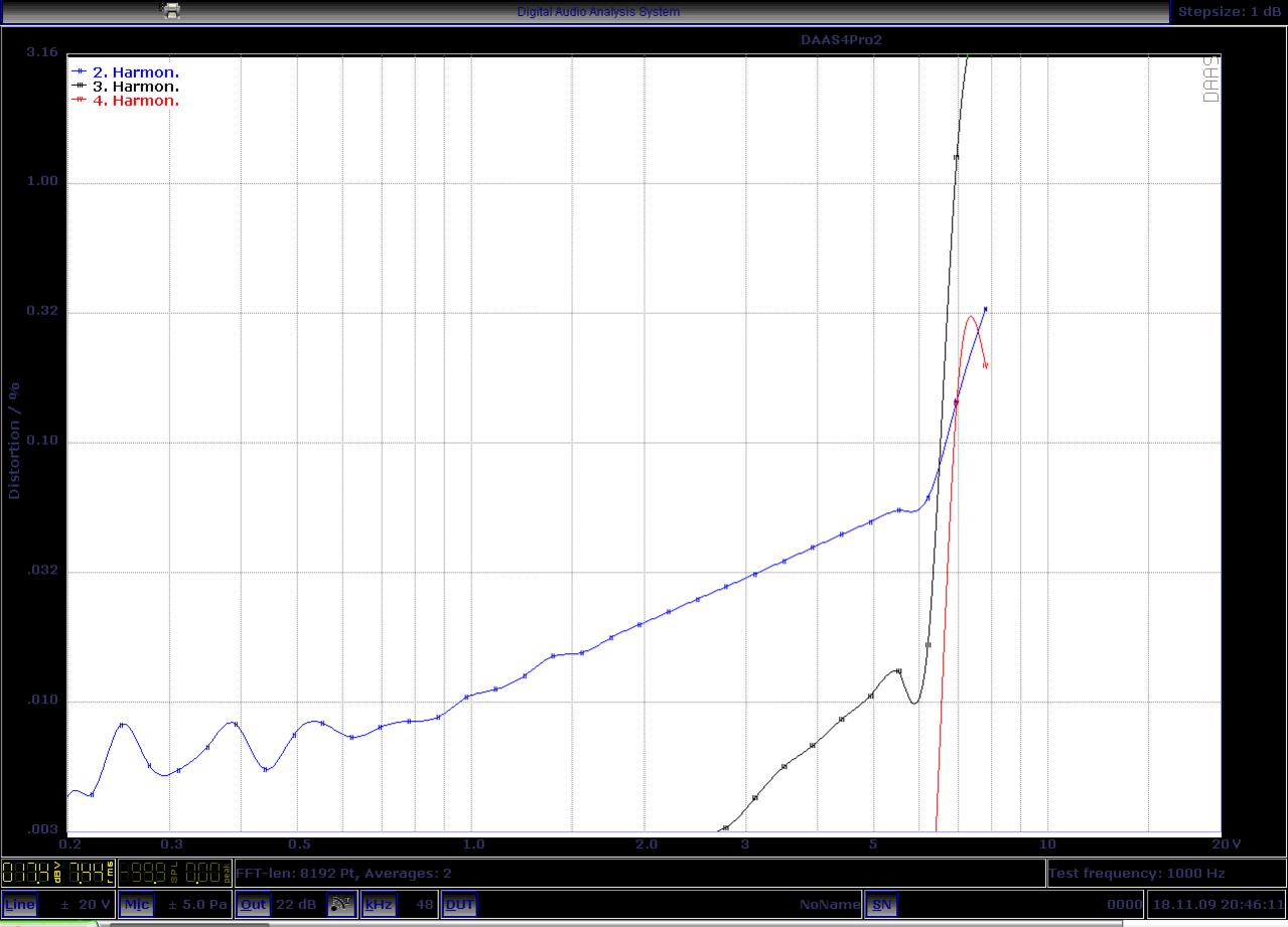

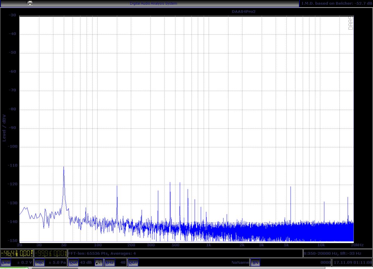

Here come some more measurements.
I measured the MPP at 20Hz, 1kHz and 20kHz with varios input levels.
The RIIA in in action with these measurements. I do not have a passive inverse RIAA at hand momentarily but i plan to build one and then do the measurements again. Gain is very high in this measurements at 20 Hz (+84dB, e,g. 64dB plus 20dB RIAA) and i could not reduce the output voltage with the equipment that i had on hand spontaniously, so take this measurement with a grain of salt.
What do this measurements show?
Basically that the MPP can not swing much more then 5V cleanly at any frequency. so overload margin is around 20dB with a cartridge that puts out 0.5mv at cruising level. distortion is only 2nd harmonic at low level and rises with level. higher harmonics are showing up monotonically at higher levels. i found this typical with open loop designs. designs with high feedback seem to behave a little different in my experience because they stay clean until a certain level and go into overload more suddenly. if that is a disadvantage or not i do not know. i think overload has simply to be avoided. Does that lead to the conclusion that open loop designs have better low level resolution and feedback desigs have a resolution boundary ? i think that is much to early to say and neads more reseseach.
If good enough is not good enough the remedy whould be simple if you want more overload margin: the gain structure in the MPP could be changed for example giving the intrumentation amplifier more gain and build an outputstage with more voltage swing unburdining the inputstage. distortion in the MPP (high level distortion, that is) comes mainly from the inputstage. this is contrary to the observation that in other designs distortion comes more from the following stages that have to swing more voltage.
by the way i ran the MPP including the op amps on a +- 12V supply.

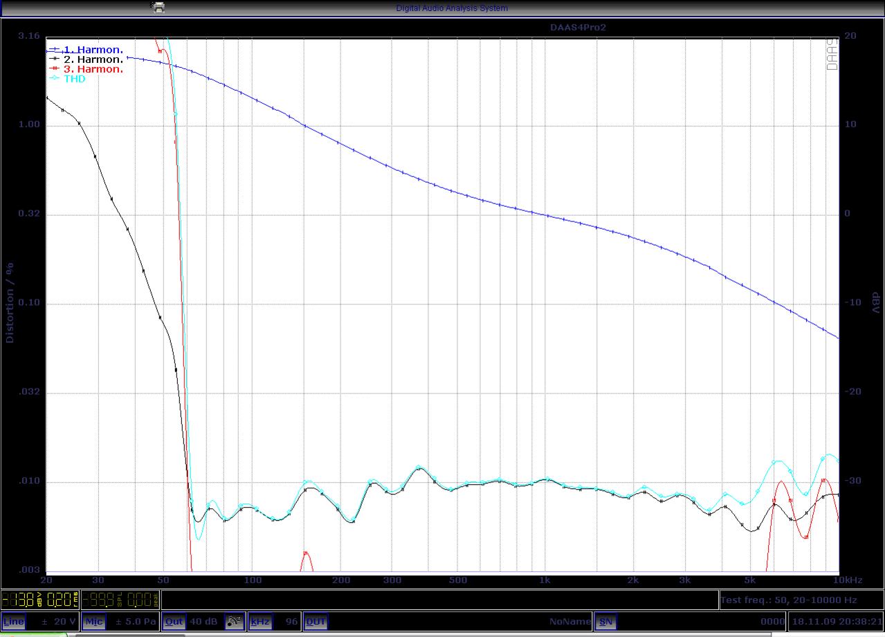

at last i show a sweep from 20 Hz to 20kHz of a level of 1V RMS @ 1kHz.
The MPP runs out of steam under 60Hz because the output voltage is over 5 V. this will not happen in reality because low frequencies are suppresed on the record.
distortion is mainly 2nd again. some 3rd harmonic is intruding over 6kHz due to the ballanced-parallel symmetric nature of the design. i hope it is high enough in frequency and low enough in level to not be audible. lumba will of cause complain that the bad nature of this circuit will bite it`s horrible teath into his delicate ear tissue.
you may wonder why the 3rd harmonic does not show in the 20kHz overload plot. it is because my 96kHz-24Bit A-D converter simply does not capture it. this tone is at 6okHz so it is suppred by the steep 48kHz anti aliasing filter, not to talk about the Shannon theorem.
I wouldn't be happy with this kind of performance, but for open loop it's about what one can expect.
I would be more concerned about those 20dB headroom. To my experience, that's totally insufficient. Try and build one with 26dB (that is, 10V swing) and give it a shot. Play a used record and you'll hear a huge difference out of the bat.
I take your comment serious and will try the improved version. Thanks for contributing.
