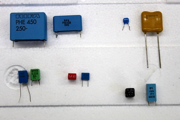

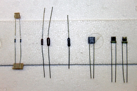

i get a lot of requests about passive parts i am using so i will post some pictures and will explain them later
The first picture on the left from top shows resistors for low level work:
from left: 1:small metalfilm from cechoslovakia (maybe Vishay), i buy them in the hundreds and they are dirt cheep and sound good. i use them for prototyps until the dust has setled. 1%, magnetic
2,3: Dale RS55,RS60, 0.1% , low TQ. make shure you get the nonmagnetic. The smaler one is my standart resistor. this is an absolute classic and still not beaten in the medium priceclass.
4: japaneese Tantalum resistor. nonmagnetic. hard to source. i use it sometimes for cartridge loading if i want a liitle bit warmer presentation
5: Caddock metal foil recommended by Borbely. gives somewhat more clarity and resolution if that is desired. Caddock makes even higher spect resistors with even lower TK and closer toerances but i do not have experience with thoose yet.
6. Charcroft Z-Foil naked with Vishey bulkfoil resistive element. Specs are amasing.
TK:Zero, Tolerance 0.01%, very low inductance and noise. If you need the ultimate in stability or improved CMR in differential stages this one is unique. they are made to spec and cost a wopping 25 pound each. I use them in critical places and can build them into my designs if the customer is prepared to pay a premium.
Second picture on the right: capacitors for low level
1. from top left: Rifa PHE450 : i use them for coupling often bypassed with a smaller value when a servo is not posible or not desired. the closest to direct coupling i have heard, very transparent to micro information. does not have the "special" sound of some butique offerings. Also very good for decoupling in power supplies or in speaker crossovers. for crosover work i slighly prefer the Mundorf RFX. They have even less ESR but not by a big margin. I could imagine that teflon caps are even better but i have not tested them in detail yet.
3: top right: blue silver mica from Reichelt Elektronic. I was supprised that the are nonmagnetic and close tolerance. very affordable. i use them for RIAA trimming and miller compensation.
4. top right: Cornell Dublier Silver Mica. Magnetic, availlable in bigger values. They make a lot of different silver micas. I buy this from Farnell. Medium price. They are ultra stable. I use them sometimes in RIAA stages when i want a very dynamic but somewhat bright sound. great for analog filter stages in DA converters where they give a very "fast" sound that fits perfectly well to good digital.
5: low left: Röderstein-Vishey MKP (blue) and Wima FKP : both of them availlable with 1% tolerance. Good for RIAA stages. I usually parallel some to get even closer tolerances and lower loss. Again i did not try Teflon but i plan to do that.
6: Wima MKT (red) they are small and availlable in quite high values. I use them for servo work and as coupling capacitor in more affordable equipment. Epcos MKT: designed for EMV suppression in cars. i use them for cartridge loading, decoupling and of cause to suppress HF. I know they are not of fancy PP but i like them nevertheless.
7: LCR extended foil Styroflex. i use them in RIAA stages as an alternative to Röderstein MKP or mix both. Bigger values Röderstein, smaller values LCR. they have 1% tolerance but one in 10 is maybe slightly of so i measure them before i insert them. i have heard strange things about their sound on the web but found it is ********. they are very good.

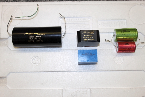

post 132, components for speakers, first row top:
1: left: Drahloric Wirewound, i used them in clasic Audio Physic speakers like the Avanti1 for tweeter padding.
2: right: Isabellenhütte Isaplan, i used them in Audio Physic top models like the Kronos
second row:
1: Sfernice Wirewound. my favourite for soft dome tweeters
2: Welvin Wirewound. an alternative
3: BI components thick film resistors in various power ranges, TT and Ohmite make similiar types. Vishey make thick film too but they are in a plastic case with terminal lugs. sound is neutral, some may say analytic
third row:
Mundorf Supreme nonmagnetic wirewound. the best combination of resolution and musicality in my experience. not inexpensive though.
Second picture:
1. Mundorf Supreme. I use Silver-Oil and Silver-Gold-Oil. Can not sell to Japan without them
2. Mundorf RXF and Audyn MKP. RXF is my favourite. RXF combined with Audyn is an alternative
3. WEGO flat foil eectrolytic. they make bipoar electrolylics longer then i can think. surprisingly close tolerance (5%) and extremely reliable. some speakers i build with them 30 years ago still work today. i use them in resonance circuits where i need big values. they produce caps for other brads too. they are all the same.

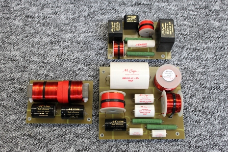

right picture: Mundorf crossover for current Sonics speakers. I am very happy with the new woofer coil they made me (pictured on the left). they are bobbinless wound directly on a bar of transformer sheet metal. very compact, low distortion, low ohmic loss.

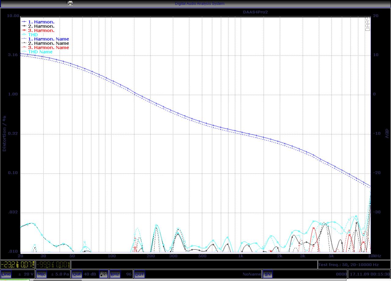

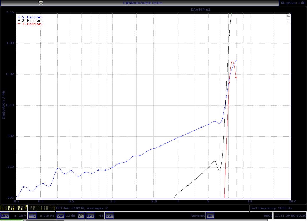

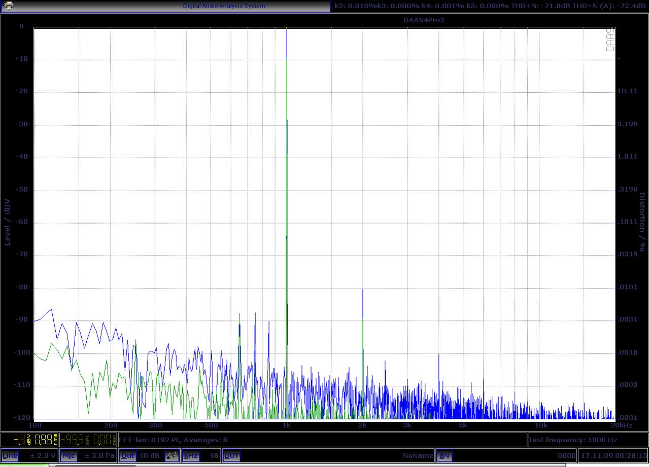

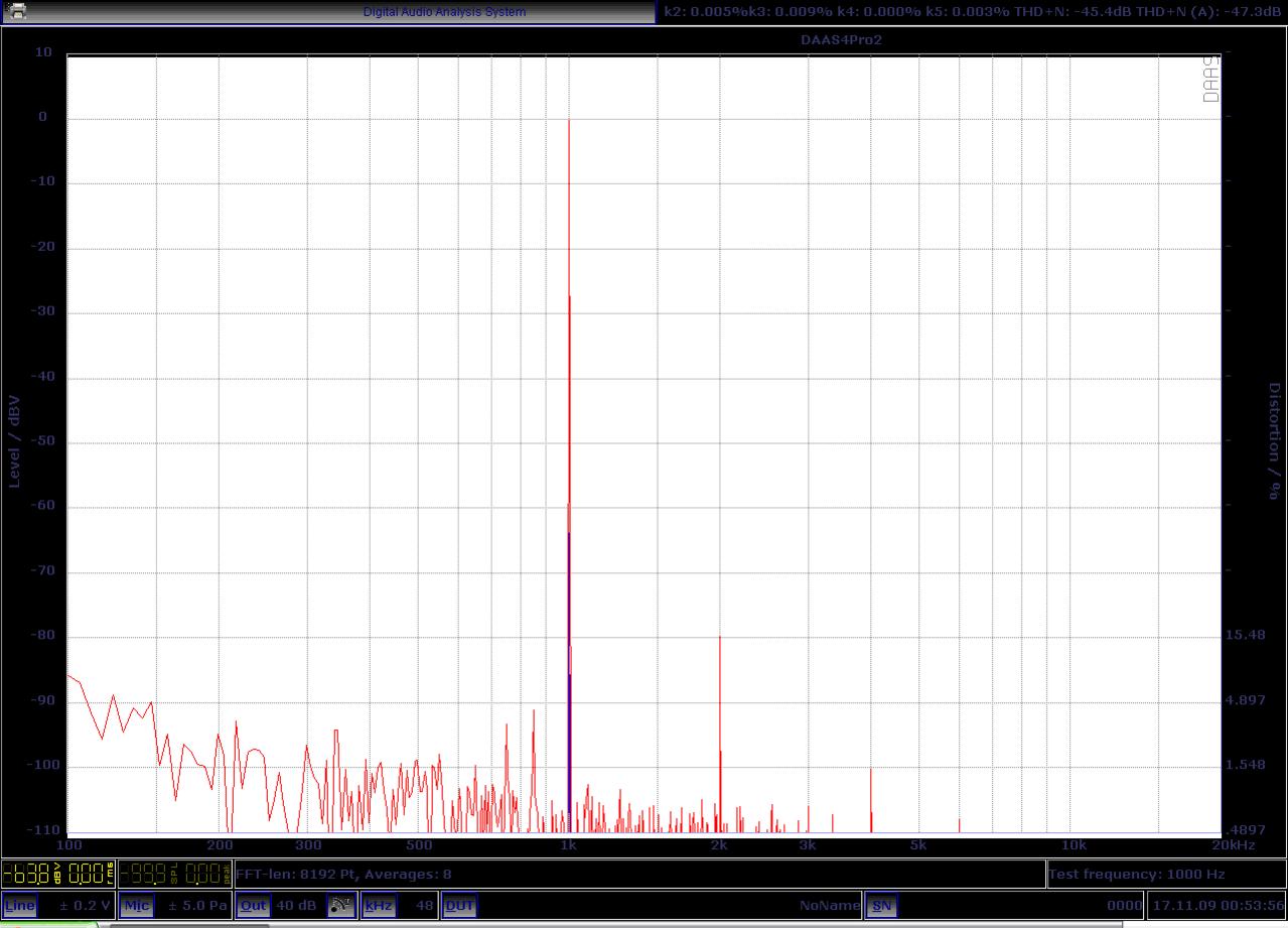

Today i got an awful lot of things done and i am happy to tell you that i succeeded big time. i had to disassemble everything and that was no fun. it really gets jammed in there.
First i got the DC offset problem solved. When i first build the circuit i got around 10mV offset from the input stage. the following stages have around x 900 DC gain so the servo was JUST able to capture. it seems that over time the offset got a bit worse so the servo could not track the DC any more. It is not "mighty" enough as we say here. So i changed R11 and R12 to a higher value to lower DC gain. That has also the advantage that distortion from this stage will be 3 times less and bandwidth will be 3 times higher. I would not make those resistors any bigger because the circuit will get noisier. to compensate the loss of AC gain i added an output stage. I just had developed an input stage for my new preamp so that circuit came in handy because it was already build and had the right properties. This has the benefit that the overload margin got up.
with +-12V supply the MPP can now deliver +-8V RMS without distortion. In the treble it is rather better because i do the 75 usec EQ in the first stage. So no trouble John with miss tracking cartridges. The output stage adds virtually no distortion and is not so stupid as it seems on first sight. I use a precision transimpedance amp with good current delivery (100mA) and great speed (50MHz-3dB). input impedance is set to lower DC gain and reduce common mode distortion. I bias the output into class a with a 7mA constant current source to the minus supply. the next stage of my preamp has quite a low input impedance of 4.2 kOhm so that makes shure that the output stage of the MPP stays in class A all the time. One advantage of the new arrangement is that i can drive long cables very well now. my turntable is 4m from the system so for me that is a good thing. i also found that an added buffer can improve the sound in terms of dynamics and
slam in the bass. If you lower the output resistor to say 10 Ohm and ad a potmeter it also makes a great Headphone output. So here we have the new gain structure i am happy with (all at 1kHz). First stage 24dB, second stage 10dB, third stage 20dB, output
stage 10dB for a total of 64dB with a 5 Ohm cartridge. Idle current in the input stage is 3.5mA per transistor, the folded cascods are running on 2mA, a compromise for optimum noise on a 220 Ohm resistor and class A drive on the 680 Ohm resistor. I give two circuit diagrams that now have also most of the correct values and types. the first is what runs in my lab because i have the outpiut stage in a seperate box. 1: the Servo is not tracking the output, that is no big tragedy because of impedance matching in the output stage. Is has a maximum of 10mV but hovers aroud 3mV most of the time. 2: servo wrapped around the output. should give around 1mV with the AD711 i use. this is not an optimum choice i just had them lying around. the OPA134 or OPA132 is better and for the freaks there are other op amps that are even better specked DC wise. i doubt that they sound any better though.
Next i show some measurements.
from left : 1:distortion with and without output stage at the same level over frequency
2: spectrum of 1kHz tone with and without output stage
3: overload margin at 1kHz

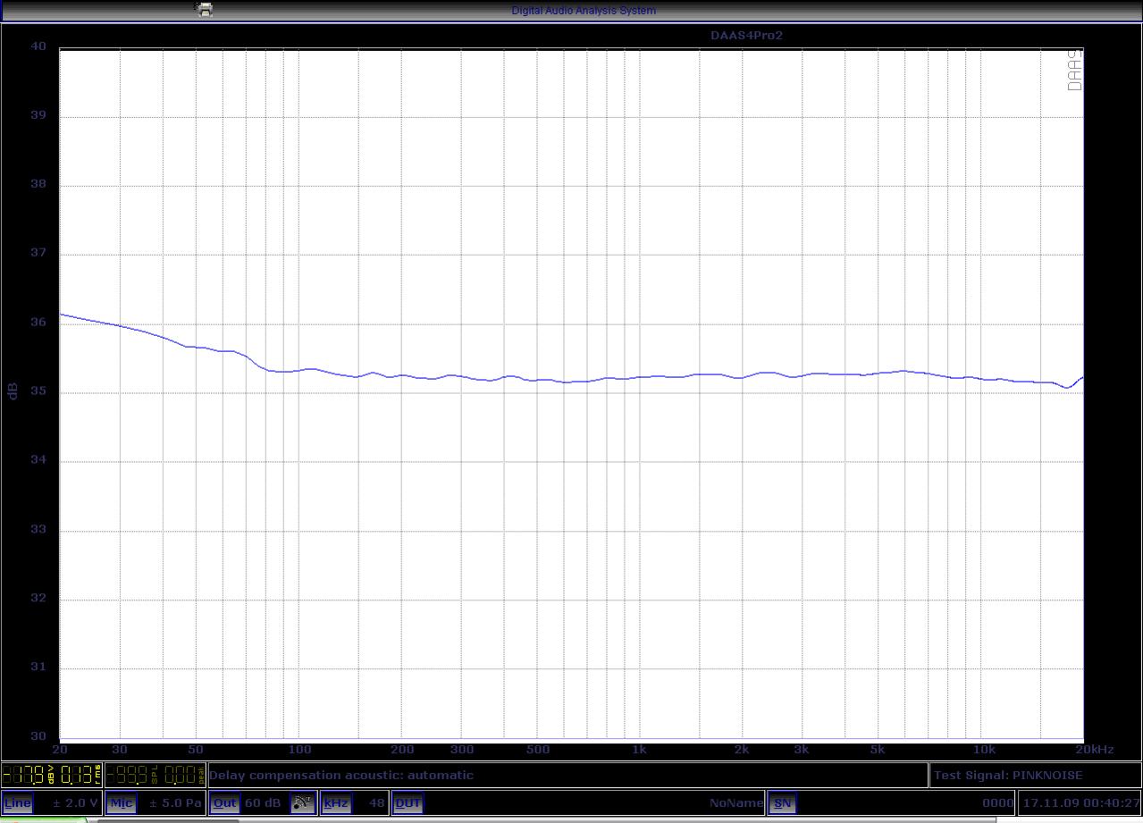

this files show the gain (+64dB) anf the RIAA curve. I had worked on it a little and put 320kOhm resistors in instead of 330kOhm. There is still a 33kOhm in the circuit that should theoretically have 31.8kOhm so at 20 Hz there is a gain of 0.8dB. i keep it that way for listening on the wekend. i like powerfull bass and have an adjustable subwoofer.
basically the result shows that mathematics are correct.

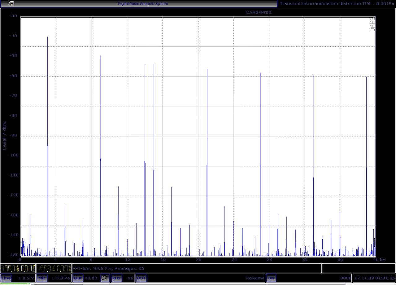

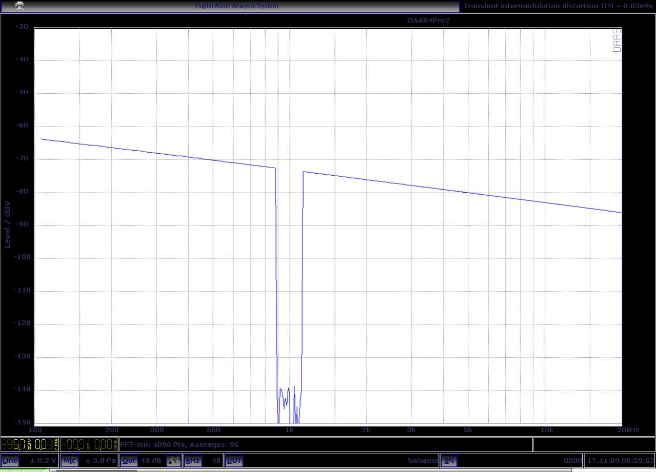

You will not beleave it but i found the time to make some TIM measurements on head amps (or pre-pres)
I find a lot of concern here on the web about TIM problems in circuits with Negative Feedback so first i measured an open loop circuit. It is the AKSA Paris. A single ended fet-bipolar cascode design with no source degeneration. The amplitude is -40dB/U (10mV RMS) as a compromise between low level resolution and dynamic range.
From left to right:
1: TIM measured with noise methode. A pink noise signal is fed into the stage and part of the spectrum is suppressed. the residuum is shown and should ideally be zezzo
2: TIM measured with the squarewave method. a sinewave mixed with a squarewave is presented to the stage. intermodulation products are shown
3: the infamous Belcher test. a multi spectrum of tones spread around the audible range is put into the amp. tones are choosen in frequency to not intermodulate with one another. tones are then digitally suppressd and the residuum in shown. this test is known for good correlation with subjective soundquality e.g. the better the spurious signals are suppressed, the more "transparent" the amp is
