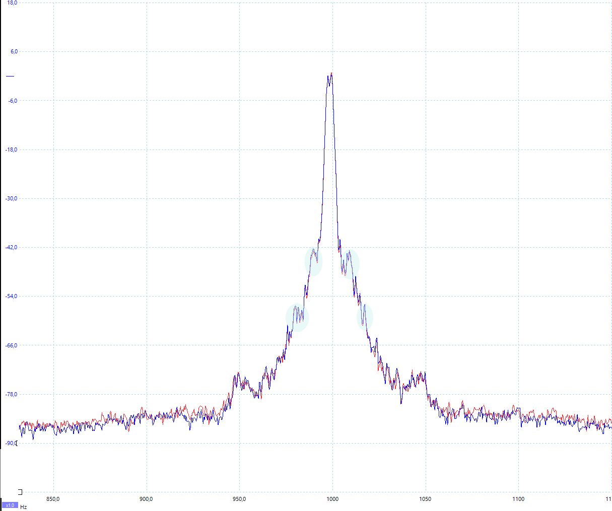

We are discussing two completely different things:
1:rumble caused by warp, which can be removed with a rumble filter
2:IM products caused by Fres of arm/cart combination, which can never be filtered.
But the more below Fres below 10Hz, the stronger these IM products become.
In the image below, a 1Khz test tone is recorded with my PU, clearly showing all multiples of +/- Fres.
Hans

Hans, can you please explain why?But the more below Fres below 10Hz, the stronger these IM products become.
Dimitri,
I have never really tried to find an explanation, but it may have to do with the fact that the lower the frequency, the larger the excursion.
I read this for the first time in a B&K test that was performed many years ago, and came across several times after that.
If you want I can retrieve the original B&K paper and post it here.
Hans

The reason for this is that the rumble filter almost always comes after the EQ amp - by that time the damage is done and the Fres components have been folded up into the audio band. There are some clever (but probably not too quiet) circuits that incorporate the rumble filter into the RIAA that may address this issue.
The original breakpoints (3180us, 318us and 75us) were set out in IEC 98 (1964). The 7950us breakpoint (20 Hz roll off to suppress arm/cart resonance and other LF anomalies) was only introduced as an amendment in 1976. I don't know when the B&K paper was published, but it may have been before this so this is why they say it is worse the lower Fres
However, the IMD components are very low level, and probably well buried in the noise floor once the stylus hits the vinyl.
There is a lot of material out there supporting the c. 10Hz Fres frequency - this was discussed in the thread with LuckyDog, George, Bill Shurv et al. I only use the rumble filter for cone flap and, when switched to 45 Hz (40 dB/decade) to suppress the acoustic rumble on classical recordings. It will not for example fix off-centre record introduced LF anomalies because those come through as frequency modulation of the music signal (maybe this was also covered in the B&K paper?)
Exactly right
Typical record warp frequencies peak around 5-8 Hz, so a cartridge - arm resonance near that range is pretty much a worst case scenario.
Actually, this IM is a mechanical phenomenon. Once the record groove modulation has been modulated by the warp frequency, that’s it. The location of the rumble filter doesn’t matter.
Shure recommended an arm resonance above 10 Hz , 10-12 Hz. B&K, even higher.

ok got it - so once its happened it's game over from the IMD perspective. There's nothing you can do about that in the electronics if the source signal is already corrupted.
In my opinion that is absolutely wrong.
If you ask me I would say that the rumble filter should be placed as soon as possible in the chain.
Correct.
Two different topics.
I was addressing the effect that location of the rumble filter will have on IM sidebands. Clearly, it doesn’t matter.
With respect to headroom it would be helpful to filter out LF below the audible range, but it’s not clear to me how that could be done in the front end without comprising noise, especially in an MC pre-preamp.
The best solution is, of course, to use an arm cartridge combo with a sensibly high resonance.
