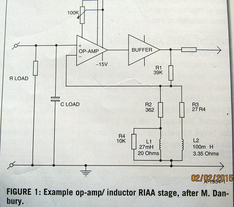

BTW. Darcy E.Staggs has also explored an opamp LCR. No caps are used here.
Where did you find this one? Thanks.
The picture in http://www.diyaudio.com/forums/analogue-source/154210-mpp-1041.html#post4209548 10401 says M. Danbury, your text has Darcy E.Staggs.
Some more information would be useful.

Darcy E.Staggs article credits Michhael Danbury as the originator of the design.
Here's what I have
Here's what I have
So this is from AudioXpress 2-2003 written by Darcy E.Staggs .?.
Sorry I don't have this magazine.
Biggest problem with circuits like this is to get the coils. I see your
picture of the small Sowter inductors, but what about the 100mH?
Most of the time you have to wind yourself or beg somebody else
to do it and the result is not easily predictable especially if an air-
gap is required.

Sorry for the confusion.That inductor is for JG's Inductive Riaa, post 1762.See attachment.
