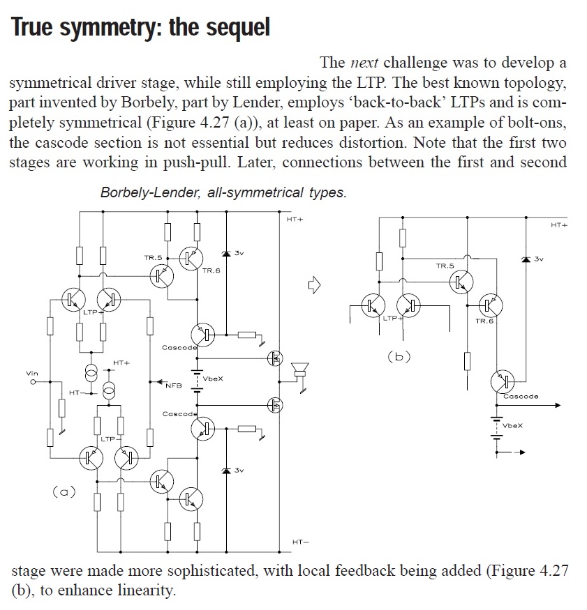

Here is the Borbely-Lender fig. b
The Supra is a bit similar and the Borbely-Lender can be improved too.
