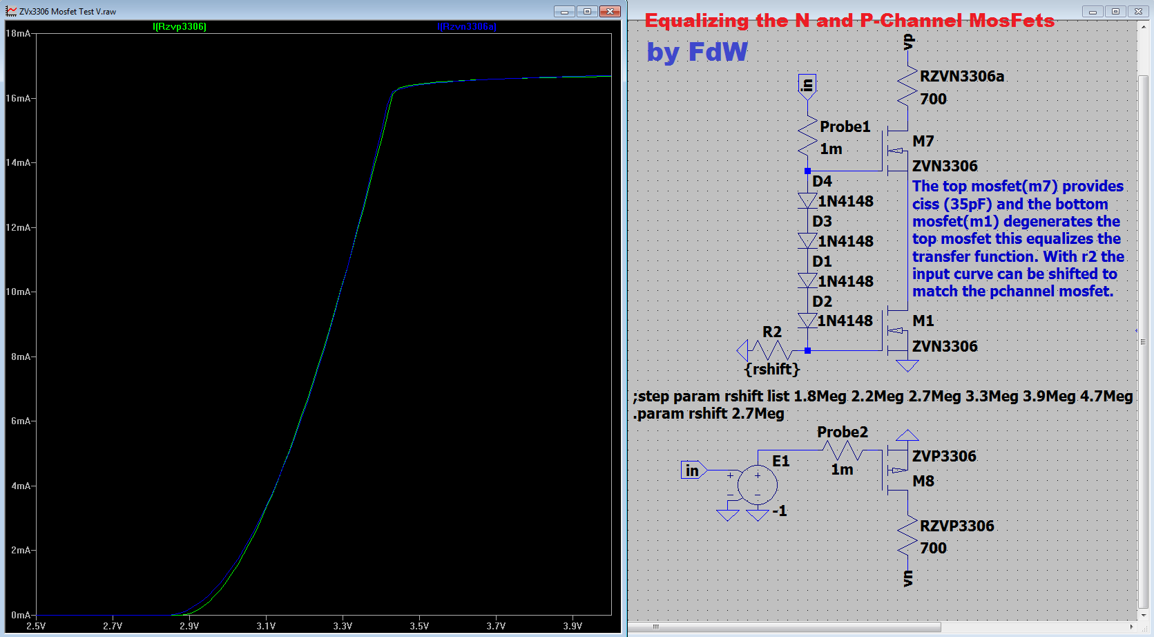

What 'blanket' is too short?
A situation of this resistor being the right size to adjust for opposite gate potantial, is too big and degenerates the mosfet too far.
And if you select a resistor that brings you to the same gain slope for opposit devices, you end up short on the VGS off.

Equalizing the N and P-Channel Mosfets 🙂
P.s. If equal input (gate) impedances are important then use a Rgate resistor on the P-Channel mosfet equal to {rshift} 🙂
