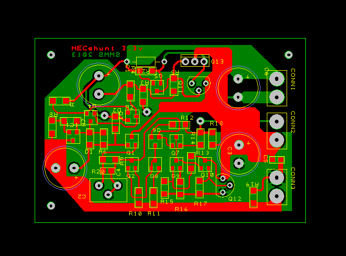

One way or another, I have already made a lot of modifications at the circuit from post #9211 , now the voltage reference is feed by the output voltage insted of the input voltage (Frans suggestion), now the PSRR is even higher.
And now I have two versions one is a shunt other is a serial regulator. The serial regulator also has very good PSRR better than 130dB at audio frequencies.

Today I made a test PCB of the regulator. Maybe tomorrow will be done ... Maybe. 😉

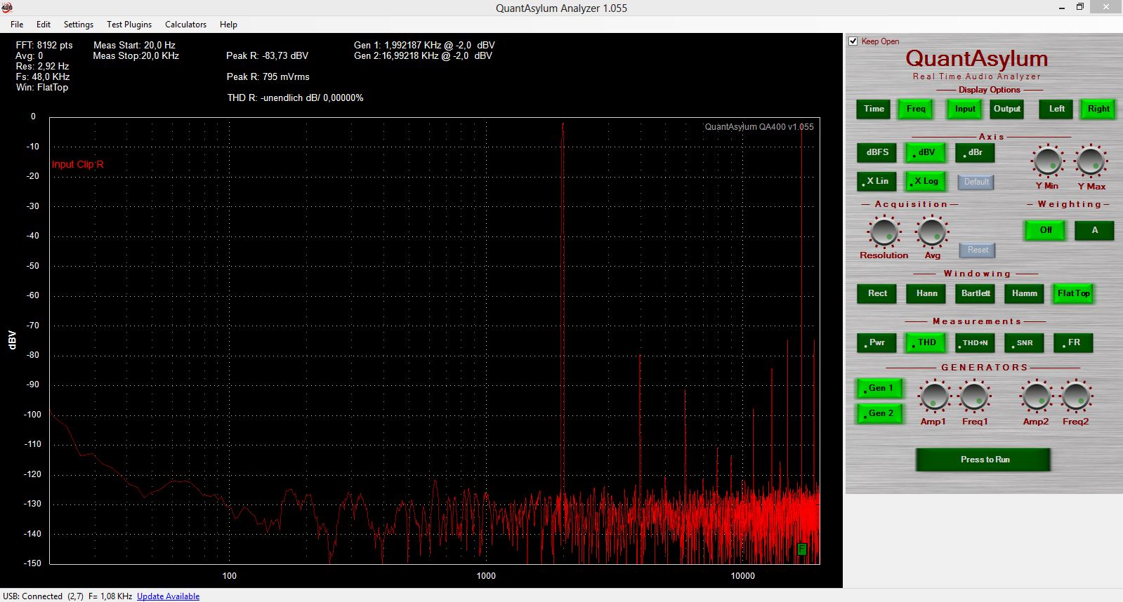

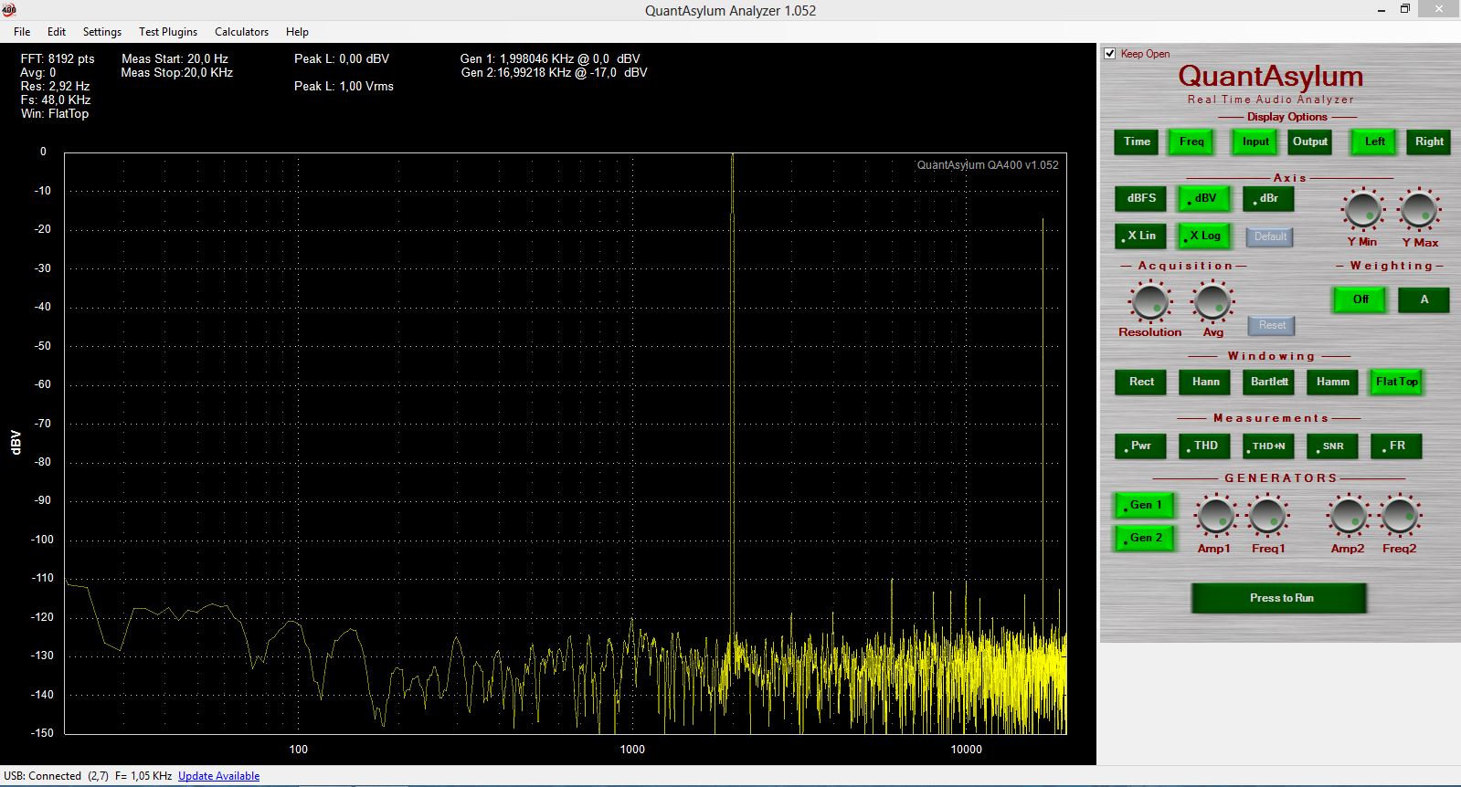

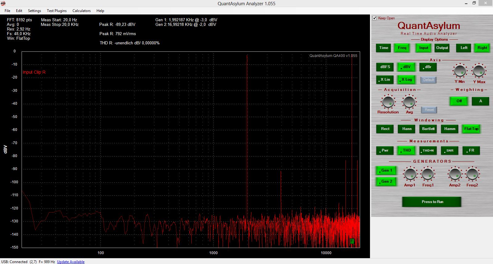

I measured distortion and i was a bit disappointed.
1V RMS into 10kOhm gave -80dB second and -110dB third.
The Piglets Dad is better in that regard. - 90dB second and no third.
The Calvin is even much better then that. I can measure no distortion at cruising level and i had to load it down really bad to see something.
I build the Mr.Evil without selecting the transistors but i thermo coupled.
