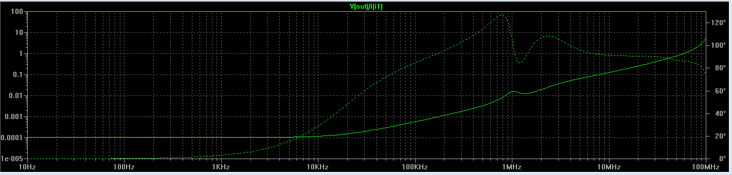

Normally I use a time step of 1ns to test for stability.
And You are right, added the inductances made the circuit oscillate. to stop I had to increase the smd cap to 10uF.

Just for curiosity, I have tested like you said other shunt regulator that I have build on the breadboard and tested with several capacitors, and I assure you that is very stable.
And it happens the same, added the 100nH in the simulation and the circuit start to oscillate, 100nH is a litle higher, normally the inductance is between 10nH.

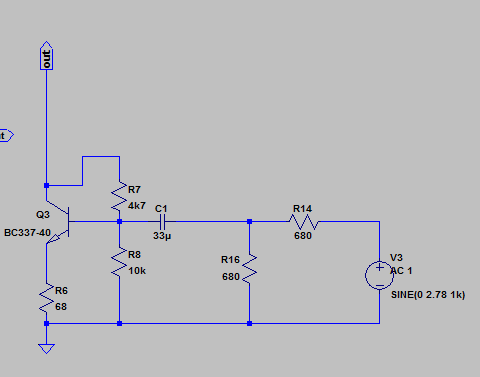

Ok. made a test to try to measure the output impedance, I have injected 16,2mA/1khz rms in the output of the regulator with 20ma DC . The output impedance on the breadboard is between 100uR and 150uR , I was not expecting such low values in a breadboard, in a proper pcb will be lower.
Even with such a low output impedance, 16ma can create visible noises in the power supply rail, that is the reason that I want low output impedance.

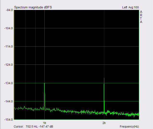

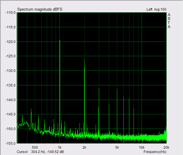

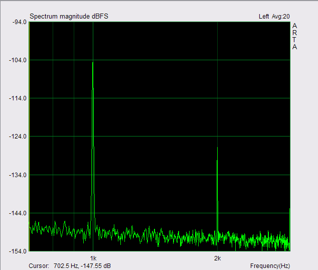

New test with a better common point, the output impedance with HEC is less than 20uR .
the first image is the output without the HEC loop ( to desactivate the HEC loop is only need to shunt a resistor ). 900uR
So the HEC loop improves things by 30dB.
the 2khz band is because the input signal is not a sin wave.
This demonstrates that such a low impedance is possible and practice.

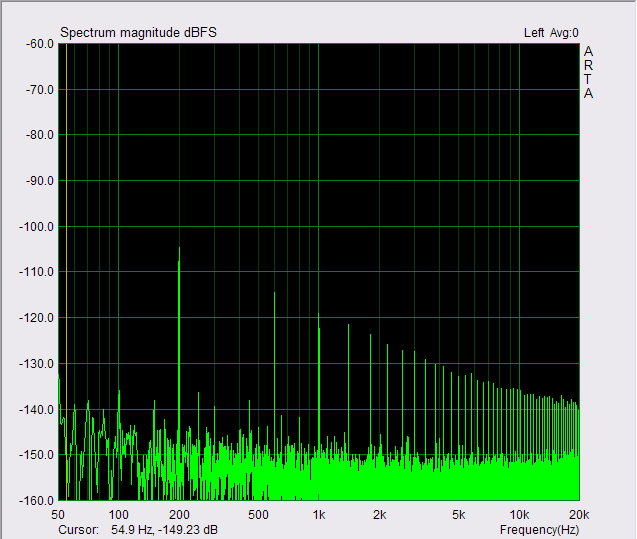

I use the circuit in post #9230 for injecting a square wave 200Hz and 2KHz of 0mA to 30mA in the output of the regulator and the signal at the output near the common point is barely visible at a scale of 2mv, there is no instability or spikes, My oscilloscope is a Fluke 100Mhz ,
Later on I have to test without the HEC loop and with a faster signal , but not now, its 105º F outsider :flame: , and is very Hot upstairs where I have my gear.
Using transistors with lower parasitic capacitances , expecially the base to collector , in nodes were the impedance is higher will increase the gain at higher frequencies.
I use only BC327/337 because is the only transistors in this moment that i have in smd version , and I want to made the test board with smd´s this week. But in future will try others , Do you know any transistor with very low parasitic capacitances and low VCE saturation?
The image is the FFt of the 200Hz square at output. Next time will take fotos of the oscilloscope
