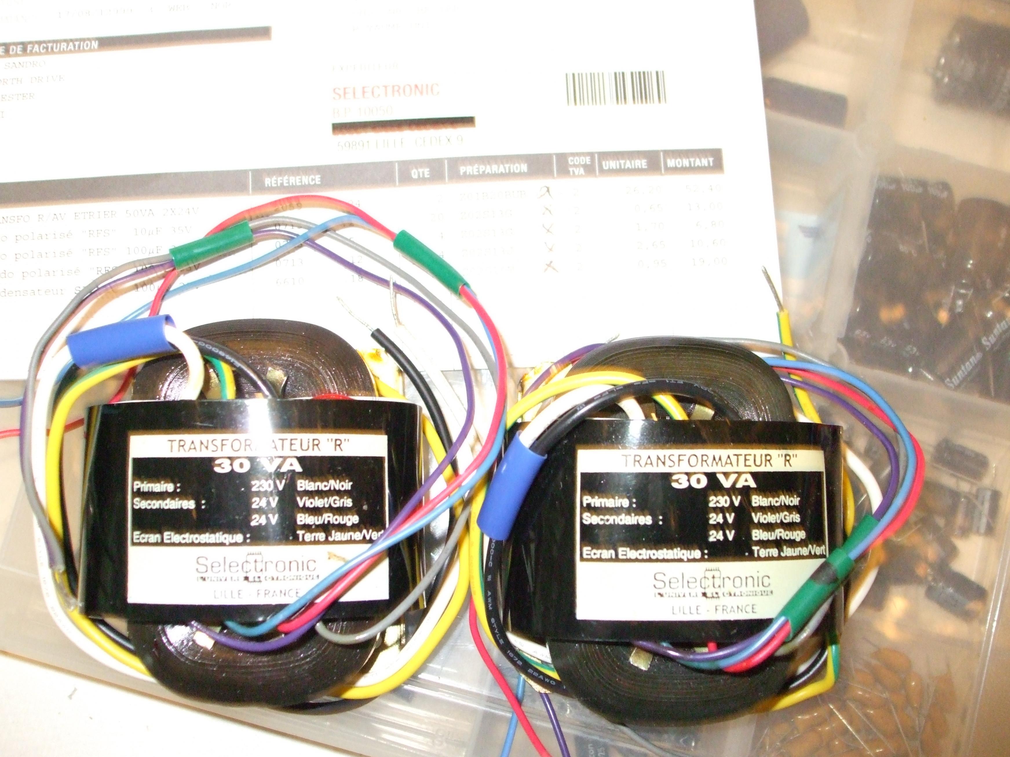

Hi Kksabath,
did anybody give you an answer on your question???
"Will 2 off those 24 V 50 VA be ok for pardise V3 "
Because I'm not that deep in DIY I would order the same Transformers to be on the save side ...

The short answer is 'yes', a (somewhat) longer answer can be found here http://www.diyaudio.com/forums/analogue-source/154210-mpp-647.html#post3110294 #6462
In my preregulator I am using a 2x24V, 80VA transformer. Out of lazyness I use the same preregulator for Paradise R1 and R2,noting that R2 has a slightly lower current consumption (110mA vs 140mA).
The power consumption in the chassis is the same, wheter it is dissipated in the amplifier or in the heatsink does not exactly matter. Yes, the heatsinks will get hotter, as long as you don't exceed the maximum temperature of the transistors you should be fine (it will decrease lifetime though). Best to run it cool.
So in my humble opinion, 2x18V, 80VA, should be plenty. Double mono using two transformers and two preregulators is even better.

Oh, you mean a bare minimum of 20VA per channel.
Any transformer 18VAC(5VA(min)) x 2 up to 24VAC(8VA(min)) x 2 will do, to have some 'head room' use a transformer of 20VA (or so) and it will work beautiful. I do prefer toroid’s and most available will be bigger that the 20VA needed, this is no problem. As Jacco noted 🙂
When building double mono you need 2 transformers of 10VA(min) each.
Any transformer will make a slight contribution on the sound. On the other hand the Paradise has an extremely high quality PSU plus pre-regulator plus very good PSRR from the circuit itself ( cascoding and mirrors ). We are talking here about a suppression of -160dB in theory.
I think what is most important is going double mono and keeping the transformers far enough away from the circuit so that no stray field is coming into the sensitive parts of the Paradise.
An opinion about R-Core ?
I'll go Dual Mono with 2 x 50VA, 18 or 24V...
As far as I understand, 24V will generate more heat, correct ?
I have no experience with R-core, I'm sure they are fine. The reason for me to use toroids is 'low external magnetic field'.
Higher VAC's will give more heat 🙂 IMO 20VAC would be the best choice, giving head room and not to much heat.

normaly they sound better than Thoroids but as FDW say paradise suply is realy good.
Have a look at the post by Salas that folow it could you please go a bit more in depth with explanation ?
Any way
Go same from Seletronic I have ordered 50VA but they posted 30VA
no problem there then apart that I am due refound.
PS they got Silmic2 a decent price.:cloud9:
