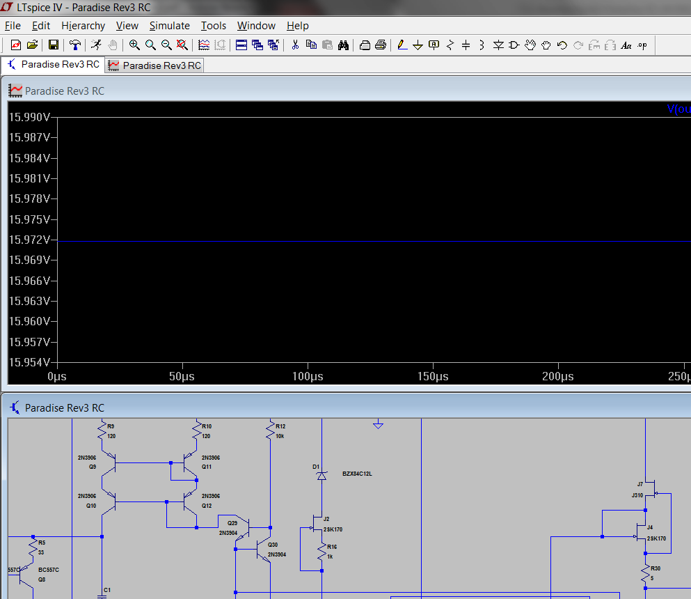

Just finished and fired the Paradise... Not again !!!
I have got one channel working perfectly and the other one outputs 15V
Where should I start ?

Changing opamps does not alter the situation.

Found the error.... Now time to listen 🙂
The holes for the k170 are so small, I inadvertedly caused a short between Drain to Gate in the output buffer k170.... result 15V out offset.
