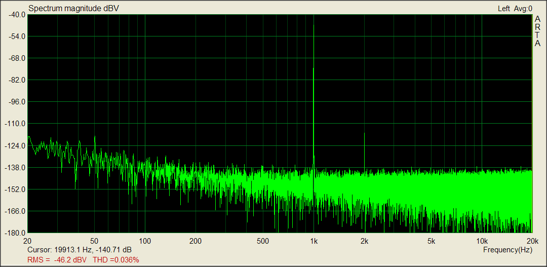

The floating battery gives freedom from ground loop possibilities but its not an unsolvable issue with electronic PSUs also. I have shown this in another thread recently, its the FFT of a no PSRR JFET 20dB MC pre-pre (one high mS part only) driven by 5 Ohm Zo voltage divider. 5mV signal output, 0dB=1V. No 100Hz ripple or harmonics, 50Hz hum well suppressed for a 2m long single ended measurement loop. The PC was mains supplied. Although a battery can be a quick and sure way to avoid the hum headaches, it takes a major maintenance and control effort to really do it nicely. Gonna end up with Arduino like stuff if SOTA.
