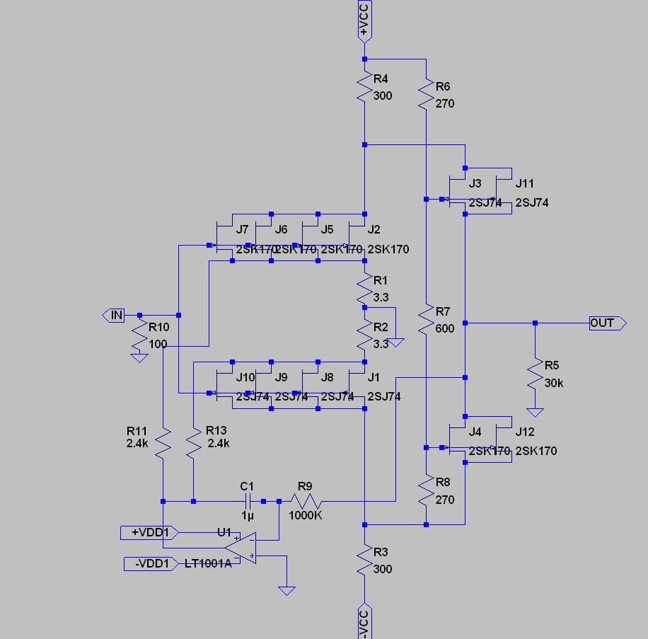

Joachim,
I tried to simulate the circuit you posted a couple of pages ago (the vendetta type).
Nevertheless, the simulator shows that the servo's circuit is not working which makes me think at this point that there is something wrong with my model.
Maybe the spice model I have for the J74 and K170 are not correct and are causing these issue with the Servo.
Could you or anybody here post the a valid model that has been used with success for the K170 and J74?
For simplicity I am attaching my simulation file for reference.
Thanks everybody.
  • Vendetta.asc
    Vendetta.asc
  • Library.txt
    Library.txt

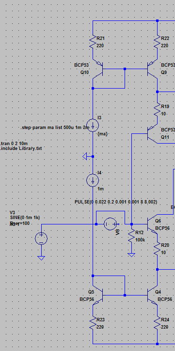

Joachim,
I am still working on simulation for servo gain stage and buffer.
Does the servo look good?
In this case it is not on the signal path, but I am not sure it could work in practive.
It simulates just fine and with an input offset it acts and zeros the output out.
Would you mind comment it?
Thanks,
The offset is almost not influenced by the current in the current mirrors, try the simulation below. To correct an offset of 12mV a current offset of 500uA is needed. The current source is not the place to use (to control the offset).
I see what you are saying.
Where would you then control the offset otherwise?
Also, why not even the simulation for the vendetta's offset control seems to properly work when in the reality that is a proven circuit?
One way to find that out is to use the simulator, use the ".step param x list ..." command and inject currents/voltages at different points. Find the spot where the 'injections' have the largest influence and you are near a solution (also you will gain some deeper understanding of the circuit).
Joachim,
Thanks everybody.
Hi Stefanoo,
in your schematic, the servo is only influencing the upper half, so if the offset falls into the other quadrant it cannot influence it. you could try connecting it to the input for testing, or to the midpoint of R7 and see what happens...
