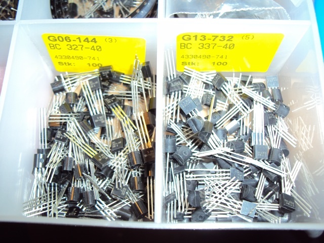

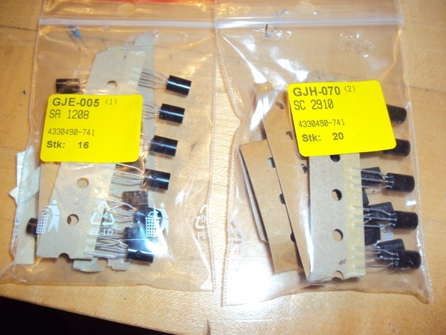

The BC327/337 and the ultra low noise Sanyos have arrived. I measured Hfe in some random chosen BC´s and it is around 300 in the NPNs and 500 in the PNPs. This is a rare case that the PNPs are stronger. When i look at the printing they are from the same manufacturer.

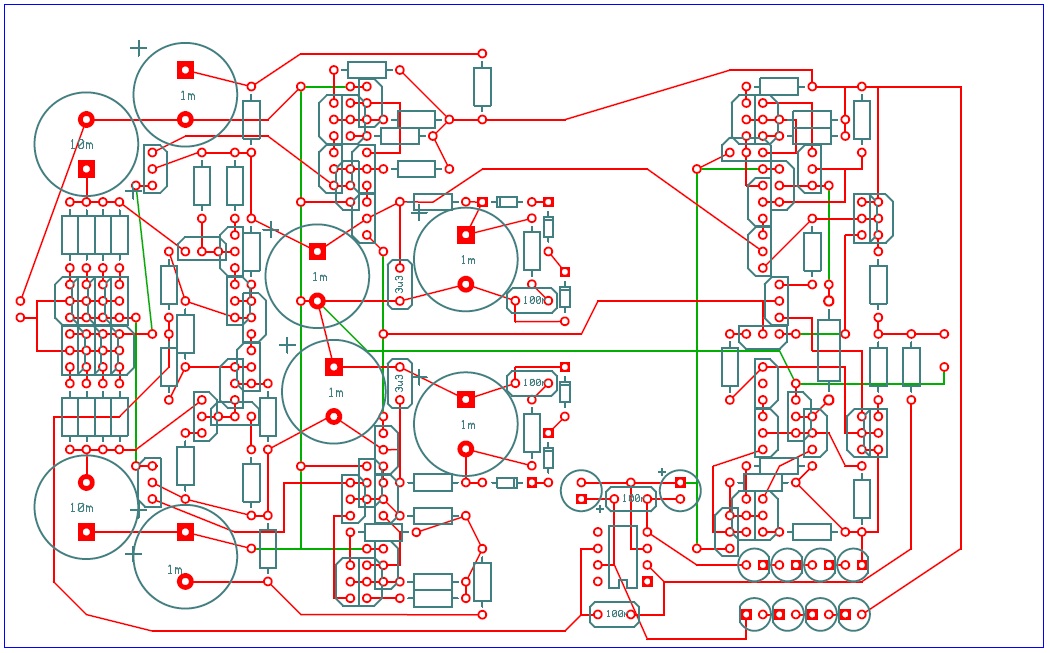

I am still working in my layout but as I only have small veroboards and due to the extreme complexity of the design I guess I will not be able to do it p2p before the boards are ready...![]()
Hi Ricardo,
thanks for posting your layout, looks good and inspiring! on perfboards you do have some degrees of freedom that dont exist on pcbs, especially for ground and power routing. in fact, I am looking into the ground routing right now, goal is to have a star ground at the input, to not ¨contaminate¨the ground returns from the caps and the RIAA network so those will have separate return paths. if i find the space i will put add`l connectors for external power supplies, but don`t bet on it. also, with these current mirrors the impact of different power supplies should be far less than in single-ended topologies for example....

I would route the pcb with two groundplanes one that includes the powersupply and the internal 15V area and one where the sigal is. The two planes can then be jumper connected...or gnd resistor connected...this will create the star on star youre looking for...and at the same time make the layout much simpler...

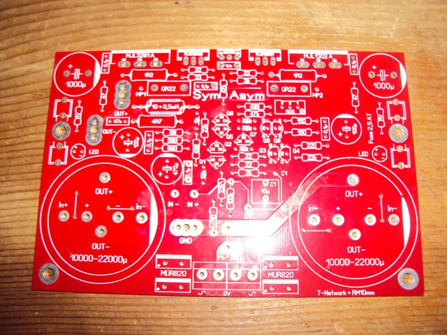

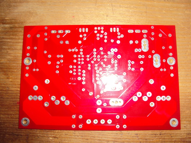

Yes, it is for Mikes Symasym. I would like to make the Paradise PCB that way. Red with tinned tracks.
