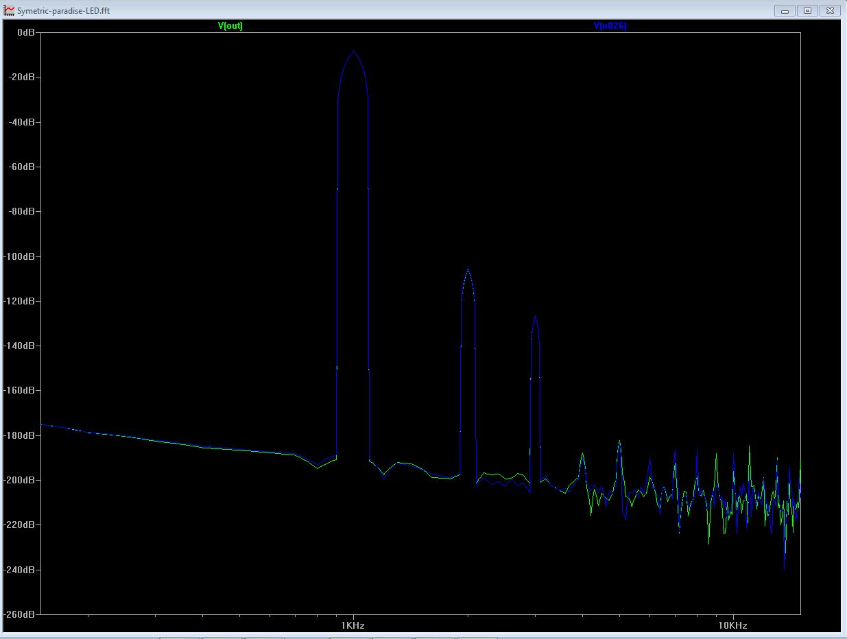

Hi Michael
Maybe you have already done it somewhere in this very fast growing thread, but could you please post the THD simulations of the buffer alone?
Preferably with various load and output voltages.

I have not made the buffer as a stand alone,,, But i believe performance would be great.
Here you can see that it has very very low distortion and no high-order elements.. and on the distortion plot it almost invisible...blue trace is pre-buffer and green is after...
It does have an offset of app 15 mV that has to dealt with if used as a standalone-buffer...

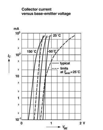

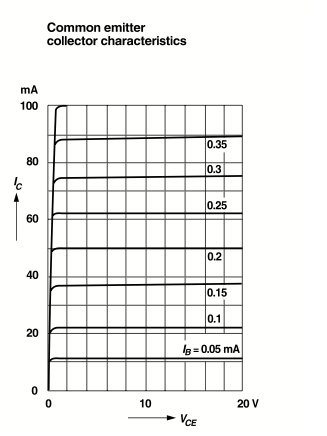

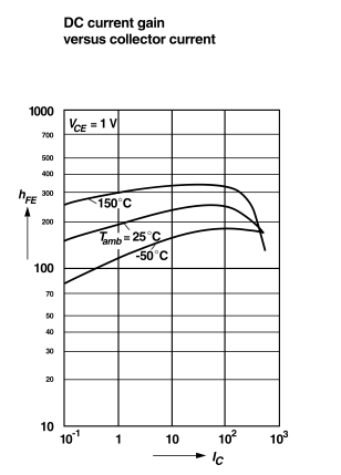

The buffer works well because the modulation of the 3 most important distortion sources is small. I already mentioned Early Effect. That is modulation of base current over Vce.
The chosen BC327, 337 are superb in that regard. The base current does not change much with varying Vce. We see a nearly straight line. Then we have casdoding and then we have a stiff supply. Second is modulation of Hfe over collector current. First the BC327/337 has a relative straight Hfe curve and then we have tremendoes current regulation from the precision current mirrors. Third is modulation of Ube, the voltage that appears between base and emitter, over collector current. That is in this buffer direct in the signal path. First we stay under 10mA where the curve is rather steep and then again the current mirrors hold the collector currents steady. The driven cascode transistors are a bit harder to explain : the input transistors drive the gates of the output transistors and the gates of the cascode transistors. Should any undesirable modulation happen the driven cascodes give that information to the input transistors in anti phase. One could also call that a bootstrap. This is a mighty fine buffer.
