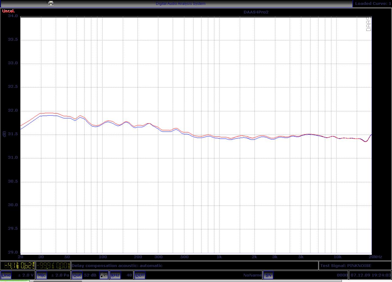

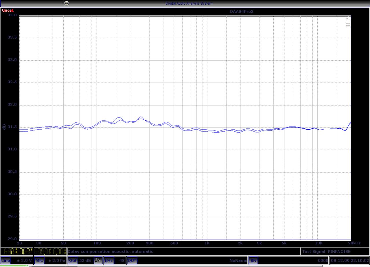

i wrapped it only around the input stage, that was sufficient to reduce the offset to under 0.5mV with a randomly chosen AD711. the servo is very slow so should not contribute to distortion in the audible band. i will show the RIAA curve of the AC and DC coupled version. the AC coupled version is an inconsequencial 0.5dB up at 20HZ due to the aditional pole at 7Hz. the DC version is superbly flat with + - 0.15dB and virtually identical in both cannels and all this with only one coil and one cap. groupdelay and phase ( not shown) where quite flat too. i wonder what all this hastle is about with complicated PI filter inductive RIAAs. in the next post i will show some pictures and talk about the remaining issues.
the second stage has the 25mH coil that does the low 50Hz breakpoint. by 20kHz gain of that stage has rolled of by ca.40dB so presents the outputstage with a constant velocity signal that is quite easy to handle. the outputstage makes the 75usec breakpoint active parallel. that circuit arrangement has a lot of advantages that are not obvious on first look. the coil is superbly low in ohmic impedance and adds virtually no johnson noise. that input stage is also quite unsensitive to Op amp choice because at higher frequencies (aka 20kHz) where op amps run out of gain the amplification is just 20 dB leaving even the wimpy OPA134 with 30dB of feedback. OPA827 and ADA4627 do 10dB better still. the second stage does not load the first stage much. the choosen LT1468 has a differential input impedance of 100kOhm and 10Mohm single ended. this is also the reason i tried class a biasing of the first stage in the DC version but that did not give any measurable difference. the OPA134 has only 0.3mA class A positive and 0.56mA negative but with that high impedances it does not leave class a differential until 30V. the second stage is also interesting with a maximum gain of x 4.2 leaving the LT1468 with a wopping 63dB of feedback at 20kHz. first i ran into some problems that i expected. at first i had tried a DC coupled version without Servo and a bipolar input amp (the LT115) and offset was all over the place. DC gain in the input stage is over 1000 x so better to use a FET opamp. after substituting an OPA134 (not my favourite but i did not have DIL versions of the OPA827 at the moment) it dropped to under 1V. time to make the first measurements. the unusual structure of the inductive RIAA made that stage instable and i solved that with a 33pF silver mica over the 10kOhm resistor dropping the gain at very high frequencies to x 1. everything fell so easy into place that i wondered why inductive RIAA is so rare. to reduce DC even further i came up with two solutions : first was to simply insert a big (4400uF in that case) elcap in series with the coil. i used a 105° Jamicon (2 x 2200uF) , nothing special but i could not measure any difference in distortion with or without the cap. voltage over that cap is only 2mV and the big size should reduce ESR to inconsequential levels. leakage current was low two and i got less the 3mV at the output of the outputstage. the outputstage has low offset anyway because it has zerro DC gain. because i do not like elcaps in the signal path (out of totally subjective reasons) like most of you is was obliged to design a servo.

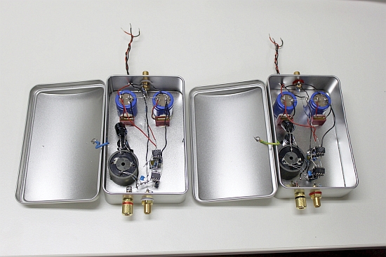

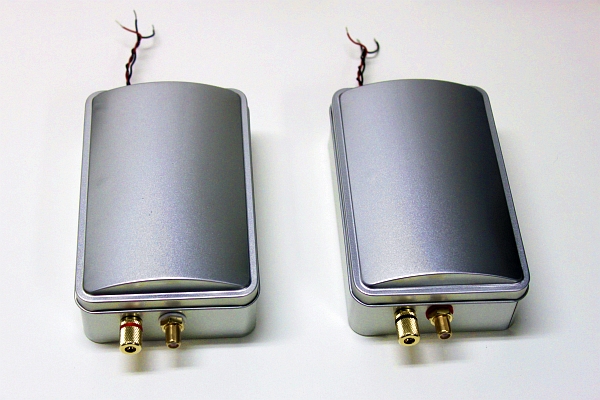

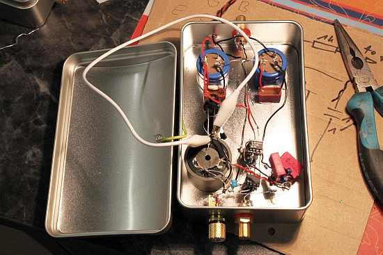

the coils are quite sensitive to hum and influence each other. i used that to advantage by placing the boxes for hum cancalation. i did some succesfull tests with a copper cap over the open end but that changes the value somewhat. i think i will place them externally in shielded boxes. if i succeed i keep you updated. listening tests have to wait for tomorrow, the family is already sleeping. the photos show the AC and DC version and the total look. what i heard in the morning (AC version) was already very promissing and natural sounding. no more lazy treble and deminished speed but the fluidity full intact.
as SW theorytiesed there is an inrush current. nothing that hurts the ear but a muting sitch whould be good. i keep the stages on current all the time so no problem for me.
