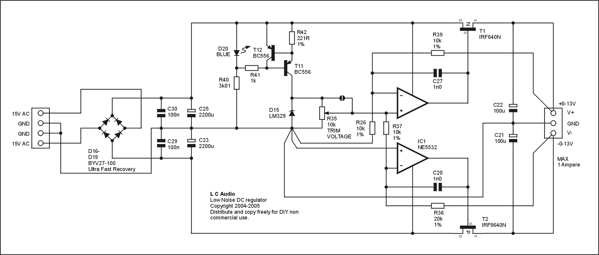

i plan to build the Salas shunts now. the powersupply i am now using is the LC Audio Low noise supply in double mono. seperate supplies for the input and outputstage. i have the input and outputstage in seperate boxes. i will ad the circiut diagramm of the LC regulator in the attatchement.

Hmm, looks certainly very nice, pretty similar topology as in the Vendetta input stage except for the BJT cascode transistors. Is there no way to create a JFET transimpedance input stage, similar to your BJT version? Just an idea, but if you closely match N- and P-Channel current there should be very little offset voltage when running the input stage in common-gate mode?
You would not want the 6R series impedance of that choke on the B+ after employing a very low impedance regulator that you plan of, I would think. It defies the purpose IMHO.
After it being prefiltered with chokes for incoming gremlins and then regulated, if the Output Z of the reg is say in the 5mOhm area and flat up to several decades of kHz, just a 0.01uF COG/NPO (better it be SMT) or other good enough types with short legs and sizes that you can actually see for that matter (N.Pass TM speak), is all you need for locally decoupling the power receiving ends. A large electrolytic even if alone there, as the one you have now in LC configuration is going to interact and worsen the very high frequency Z of a remotely sensed shunt regulated B+/- voltage source.
It will be insignificant interaction between stages over a preserved very low and flat Z reg impedance even if its common between stages. Simply because there will be no Z to speak of for the different current demands to dance on.
Of course you could plan more regs for stage separation, maybe there will be other benefits in that, but you can safely run the whole thing initially on a common +/- shunt, given that your receiving ends and grounds are going to be arranged in short & symmetrical star fashion, for the sense wires to transfer meaningful interaction at the reg's error loop nodes.

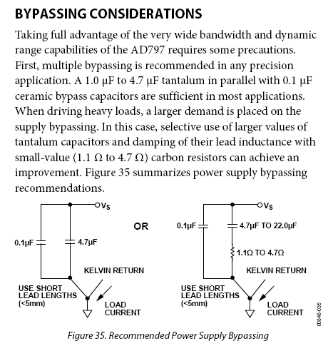

so you whould also not decouple the OP amps with lokal electroytics plus foils ?
I would decouple them with the COG/NPO initially. If there is a benefit for specific op amps to get something more substantial there, surely would not be too big or slow, and it would be chosen upon trial.
EDIT: Scott's AD797 has some recommendations to check out on its datasheet, for instance. Its a most capable op amp that I would not leave out of my subjective comparisons in such a phono BTW.
