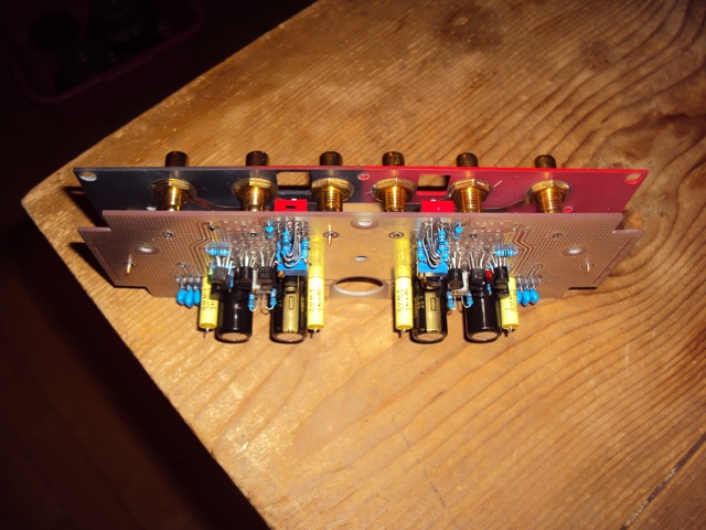

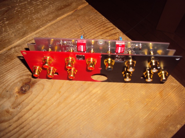

Benedetto, actually most of the equipment i use i have designed and build myself or it was given to me from manufacturers in exchange for work i did for them. I could not afford my current system if i had to buy it now ready made with my big house to care for and my 18year old son consuming a lot of patients and money. Actually the DL103 and the INA103 are not bad at all. What you can do to the Denon is mainly mechanical. That plastic case is not that good but the generator and needle is of excellent quality.
Pick up the pieces ....

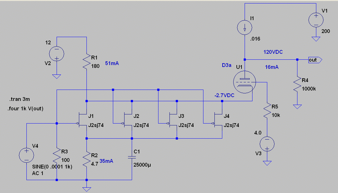

I found an interesting circuit by JC Morrison that is a Fet-Tube folded cascode. It can be used as an input stage for an MC pre-pre. He claims that it sounds better ( less Hifi, better for classical ) then a series Fet-tube cascode ( Arthur Loesch circuit for example ). He reasons that the idle current can be set more optimally and independently in the Fets and the tubes. Running a series Fet-Tube cascode on 35mA would certainly cause some trouble and lots of heat. With 200V that would burn 7W.
