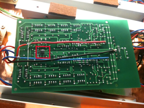

Use LEDS instead of Norton Vref if better drift is desired, but it can be inconsequential. You skipped capacitor filtering the Voltage reference resistor and trimmer on purpose? That could be an important aspect. Your build works well for Zo in its simple form, congrats.
Hi Salas,
the reference voltage really is the voltage across R4+R5, and Q4 compares this to the output voltage just like in your reg. But when the VBE of Q4 varies, so does the output voltage, and since it is not corrected by feedback the impact is large.
Yes, no cap on the reference since it is fed from a supposedly quiet voltage, the JFET isolates further, and the "regulating" action of the JFET would just be slowed down if a cap were present at that node. I think it would be better to put a lowpass filter before the base of Q4, but then I would have to deal with the base current. (I think John curl went to great lengths explaining the use of JFET current sources and resistors as reference voltage sources in the Blowtorch 1 thread somewhere).
Thank you for the flowers! I would not have ventured there if it weren't for your designs over in "your" thread, very interesting what can be concluded from such a simple arrangement.
Hi Salas,
LEDS or LM329 string would not vary as much as a direct I to V converter as the Norton resistive ''Zener'' does. The drift with the Norton is due to either the TC point of the JFET (what type you use?), or the Vbe bracket's stability it nests in as you mentioned, or both. Given that a small drift can be inconsequential to some application, the Norton is cheap, easy, quiet. Surely there is good PSRR in the JG circuit, because no filtering over R4+R5 certainly is noisier than filtered, showing on the reg's final output. Anything noise source there gets amplified by the error amp BJT. An RC filter makes it higher impedance, and impacts the base current, hence OLG, PM, Zo, on the other hand. This is a custom build non the less, and since you found the application's noise floor total to spec, there is no need to slow it down.

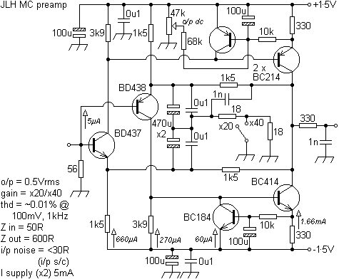

Any time soon i am planning just for fun to build the JLH MC pre-pre. Some time ago i ordered the transistors. The reason is simple. I learned a lot by his books and articles. I must say he was one of my strongest imfluences. He never showed any extremely complex circuit i see here sometimes but what he did was beautifully clear and clean.
I ask myself the question recently how complex something must be to sound good. Sometimes complexity is the only way to get the job done. See the fully symmetric FPS.
But simplicity has it´s own charm. The other reason is that i whould like to know how far we have come in the last 20 years. His circuit is a good example what was state of the art back then . I will compare it to my recent designs and i am very curious if they sound any better.

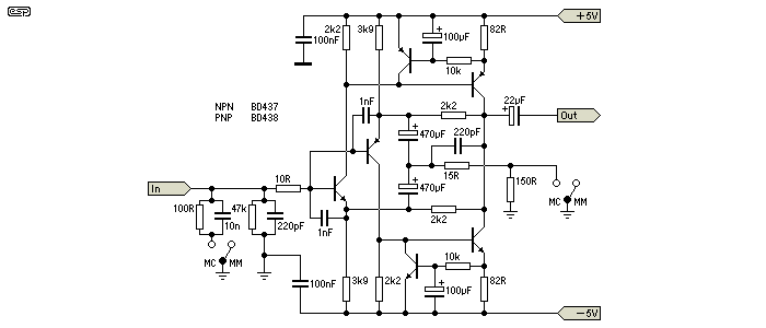

I have a small problem with the schematics i got. I found two schematics that differ somewhat. One is DC coupled but that is not what striks me. What i find a litttle stange is that one schematic shows a supply of plus-minus 5V and the other plus-minus 1.5V or does that mean "from 1 to 5 V". Maybe anybody knows. I whould prefer the 5V anyway.

I use that circuit with some mods as a headphone amp, it sounds great. I use cfp s as output transistors to lower distortion to very low levels. The best characteristic is that this design shows absence of high order distortion products at low to medium levels.
For MM/MC the results may differ though.
A copy of the original design can be seen in Ben Duncans book if you have it. I have the book but unfortunatly not a scanner.
Homemodder, so you use a Szikley pair at the output. I use that sometime too. Did you had any stabilty problems? Anyway, i will build the circuit as is although with other transistors at the output because i do not have that old Motorola BCs. I have the correct input trannies though.
Lauret, when i look at the idle currents, 5V is much more logical.
