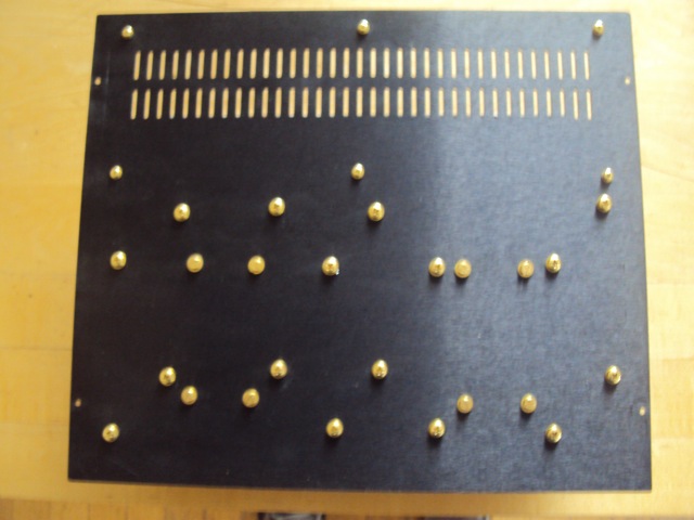

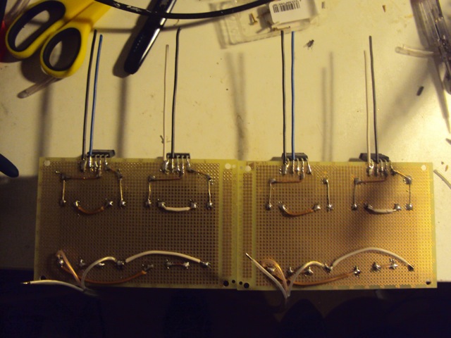

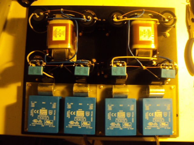

I have now fitted the bridges and the Teflon x-caps. I use 1,5mm diameter virgin copper solid core for wiring. The trick is to push down the cable during soldering and make sure that several "eyes" of the perf. board are in contact for good mechanical stability. Otherwise they can come loose over time. The solid core cables are quite stiff. I wired the high power part separate for each channel. Maybe i do even two separate power outlets so the Pre-Regulater needs 2 power cords. I straightened
the solid core cables and made sure that the inner cables of the high voltage sections are not cut to prevent short circuits or oxygen penetration.
See also a photo of the underside. Looks kind of good too. I do not have any fancy tools so drilling the holes with the required precision needs a good eye and a steady hand.
Photos next time.

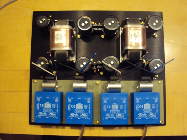

Again an attempt to upload the Pre-Regulator pictures.

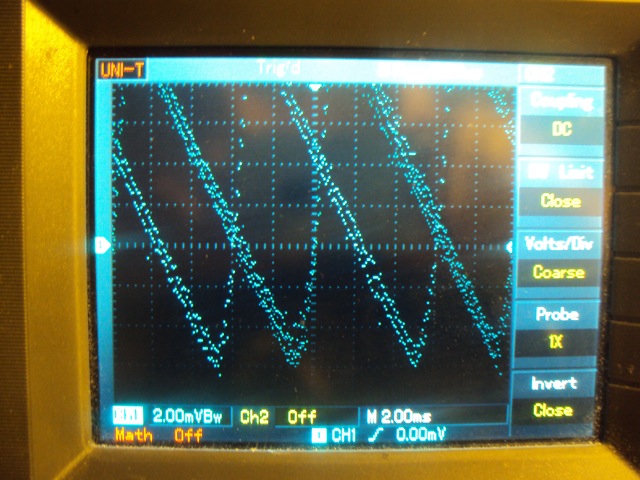

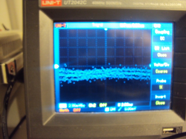

I have now wired the pre-regulator board. I am very satisfied with my build. DC voltage at the output is exact 38.5V on all 4 channels. I think that speaks volumes for the quality of the inductive parts and the low impedance wiring. The common mode chokes are very effective. See the waveform before and after the chokes. Resolution of the plots is 2mV, 2msec. I will build at least another one. This time for me. I have chokes and the slit foils but may not use Silicon Carbite diodes and teflon snubbers so this build here will be unique until the day comes and somebody totally crazy orders one more.
You got the DSO on dot display mode? Effective pre-filtering result. The weird hash stuff is capable of intruding almost any layout, and no CCS is a better firewall than a resistor load for such gremlins. So a good filter is going the extra mile indeed. An expensive mile non the less.
Yes, it is on dot display and i get double traces at that low voltage. I could try to improve the triggering but i am used to that view. One square is only 2mV and this is not a high end scope by any means. I have much better equipment in my professional lab but this is DIY and i do not want to bore and frustrate people by showing of stuff they do not need and they can not afford. I could not afford that stuff for privat use ether.
In the tubes section and in the photo threads there have been very expensive passive PSUs with common mode chokes, very expensive OPTs, etc. Don't worry, its nice to show concepts and builds.
Yes, the tube guys tend to take great care with all things that coil. Since opamps got popular in the late 70th this know how got lost in commercial manufacturing. Even the most wimpy PSU can drive an OP and sound comes out of it. Even i was sceptic but this build convinced me ones and for all that R-C-L filters is the kings way so to say. You will be surprised what comes after that. 4 Sjöström super regulators plus 4 on board shunt regulators by Sigurd Ruschkowski plus constant current sources, precision mirrors and triple crossed cascodes. The only commercial company today that uses big chokes in SS equipment is Viola i think. Cello had that too.
