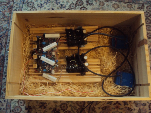

Here is the "Problem Child". It is basically an MPP Summer 2011 2 Stage with two Salas regulators with yet another output buffer. Curiously it worked with only one regulator. With two it gets hot and the sound is sharp. See my humble effort to damp with series resistors.

That one is special V1 for DCB1, has 100uF lytic cap as output termination. Has plenty of phase margin, and uses its output cap's ESR as damping. If the rails at the load side have small fast caps across to grounds shorting the outputs ESR, series inductors, reactive whatever, margin could have been eaten out, maybe one could just take it, but two could have formed some damping impedance drop path beyond their phase margin handling. Hot and sharp is tell tale oscillating. Try higher ESR output caps on the PSU boards, see what can be adding complexity on the load's rails, have nothing in series on the rails. What can be common and suspect between channels on the rails? Keep the scope on the rails looking for a flat line when AC coupled scope input is selected while trying. This one you got its very seldom it oscillates, had been used widely by people with very diverse circuits, surely you will find a way to apply it better even in an odd situation I trust. One working solo properly already is a good sign.

Hi Joachim,
I think I see a blue and a black mouse, IMO they are the culprit !
