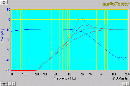

It works. 😀
The MOX board is good to go. I won't have the discrete opamps verified until tomorrow as I...mmm...blew up the only one I built so far. :hot:
Note: the LP filter appears to cut off after 10k, but this is simply crosstalk in my soundcard.

Looks very nice, would you mind giving us a bit more info about the graph? What were the curve chosen, the Q of the filters, the target frequencies, etc...
Also why is the level at -10? What was the gain configured in the buffers?

The graph shows the curves for HP and LP @ 2kHz with Q of 0.5, 0.7, 1.4, 1.7 (on the HP).
Don't pay attention to the absolute gain; I needed enough headroom to show the high Q peaking.

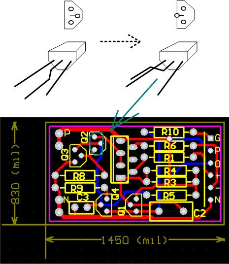

Moamps, I have the sinking feeling that you are right. I traced my layout against yours, not thinking that your red traces were problably bottom signal for a single layer board. :bawling:
Time to fix. :smash:
tiroth said:
.....not thinking that your red traces were problably bottom signal for a single layer board. ...[/B]
It's my fault too, sorry. OPAMP PCB is designed at the first time for BC550C and BC560C (diferent pinning). MPSA transistors are later placed on board (mirrored), but I didn't made changes on PCB board picture I published in MOX thread.

EDIT: The Q values I listed may be wrong. It was rather late last night when I finally got to tracing the curves and I replied from memory. Comprehensive tests are coming tonight.

You could use BC or MPSA parts without modification (you must bend the center lead anyway for the inline package), only the silkscreen is wrong as-is for the MPSA (in proto only). I too have a few hundred MPSA42 and 100 MPSA92 on my desk. 😉
The question is, should the PCB be changed for production?

here is MPSA modification example.
Regards

You missed it Brian. I was mistaken, the leads do not need to be crossed. It is only that the center base lead is offset toward the flat ("front") of the device instead of the round ("back"). Look closely at Moamps' picture above.
