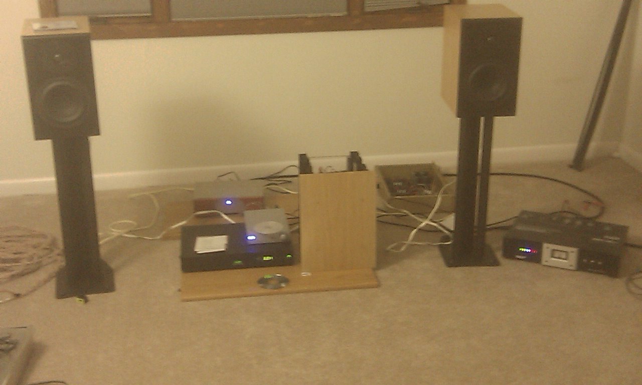

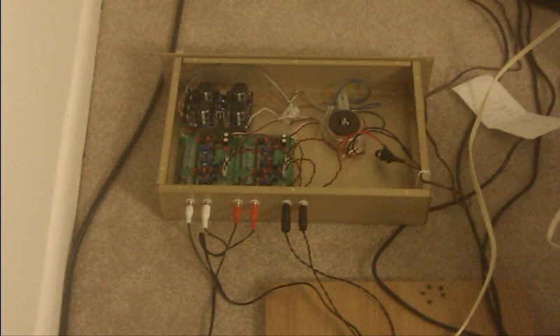

My working MOX!
After some time soldering, I finally have an active crossover! Very happy with it so far. Still testing it and need to finish the power supply, but it's operational.
Still learing how to use it too. It so versitile, that it's easy to get confused.
Vince
