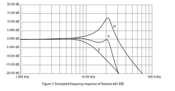

I am also intrigued. I know that many MM show a dip around that region with a 47k||C load but I don't think its due to frequency selective behaviour.

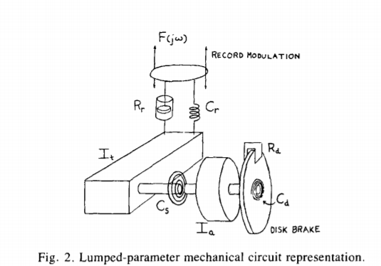

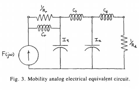

An article in the JAES from 1986 for an MC cartridge, move around the parameters for a MM cartridge:

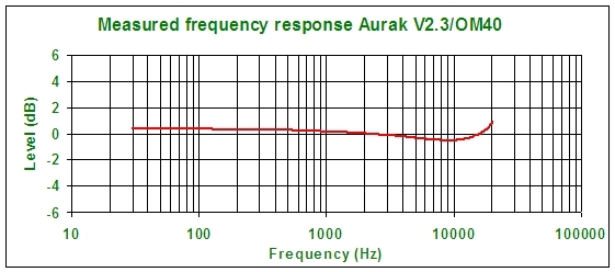

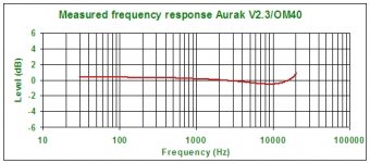

Not sure that helps explain it. The dip is shown on many measurements but not on others (for the same cartridge) but the the only model that matches it is the van Raalte one from linear Audio (image courtesy of LA). But that model fails to explain the attached FR plot done with a transimpedance load on the cartridge which is flat to 100kHz or so. I would like to get to the bottom of it.
I think you would have to look at the exact measurement set-up to decide where the mid-range dip came from. Tone arm resonance? Head shell resonance? Was the response measured using a reference disc? If so, was the EQ ok etc etc.
The HF resonance within reason is easy to understand (cart L, cable C, input amp C if discrete JFET un-cascaded for example. On single ended discrete EQ amps with feedback to the 1st transistor emitter, I would imagine the load moves around a bit as well.) Some of the plots however are pretty horrific - I struggle to see how the measurement could be accurate or well conducted.
I measured it (IIRC I posted it here) with a CBS labs unequalized constant velocity 500-50kHz sweep and flat pre-amp. Some day I'll bring it over to Kevin's and try it with his strain gauge carts and fancy schmancy styli. It might help if we had more measurements on completely magnetics free cart systems.
