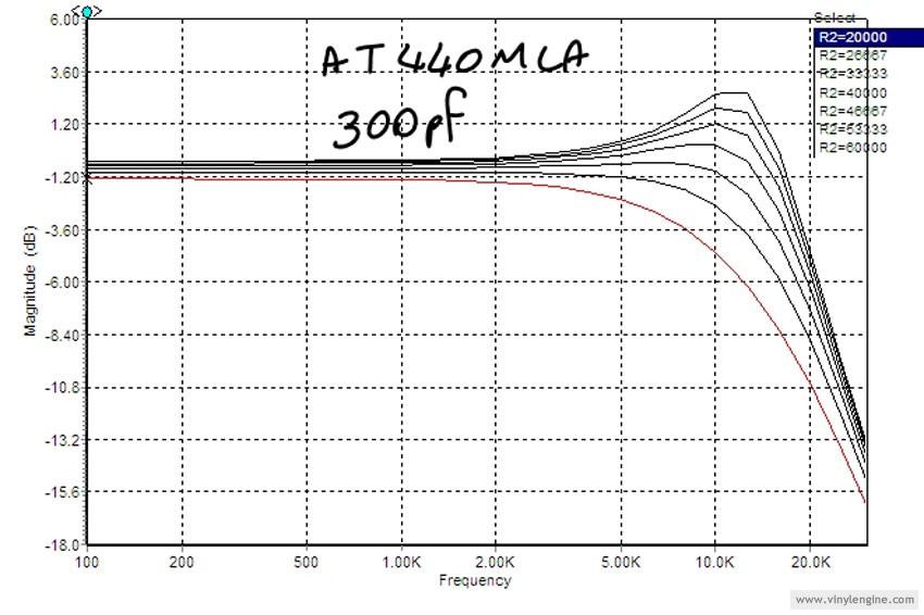

I'm also designing a PCB where I can populate components to match the head amplifier to a specific cartridge, rather than have lots of switches or a volume knob. Rather than variable capacitance, I'll just have a single capacitor that is ideal for my cartridge. When I get a new cartridge, I'll just populate another board with the appropriate components. Accession makes a big deal about steel shielding, but what about the DIP switches that connect to those loading caps?
How will you know the capacitance needed beforehand? It's the whole faff with loading to get the required frequency repsonse that moved me to start down the road of using the cartridge inductance as the L in an L-R filter.
I've not tested this but reading on what other people have done it's worth adding just enough to kill the ultrasonic noise but not enough to mess too much with the HF rolloff. I need to try and capture this, but like an idiot when I re-arranged my system to get it out of the way of little ones I haven't allowed space to get a scope hooked up for this sort of testing.
With standard 47K||pf setup you end up with a 4th order rolloff somewhere between 10kHz and 25kHz. IMO this is on of the big reasons that people like MC more that MM as too much capacitance in the phono stage gives you a tone control. Even loading to give an 8kHz pole (which is what Bob Cordell did in his vinyltrak) removes most of the problem.
That's an excellent question. I'm starting with Ortofon's spec, but that's fairly wide at 200 pF to 600 pF for one specific cartridge.How will you know the capacitance needed beforehand?
I'm making several boards, so even if desoldering is a lot of hassle, I can always build a second board with a different capacitance installed. I don't want a switch because I assume that I can dial this in and then dedicate one head amp to each cartridge (some carts have identical specs, so I don't really need many variations).
I like your advice, if I understand where you're pointing, so maybe I'll start with the minimum load of 200 pF. I might try to use SPICE to simulate the input stage with a basic model of the cartridge, and see what sort of response that predicts.I've not tested this but reading on what other people have done it's worth adding just enough to kill the ultrasonic noise but not enough to mess too much with the HF rolloff. I need to try and capture this, but like an idiot when I re-arranged my system to get it out of the way of little ones I haven't allowed space to get a scope hooked up for this sort of testing.
I have a couple of 'scopes, but no test records with known frequencies. I suppose that I could generate test signals, but then my source would need to simulate the inductance and resistance of the cartridge.
I think this might describe what went south with my passive solution. I had capacitors in there for a while, and the setup "sounded" flat. But then when I switched to another interface, it sounded dull, so I removed the capacitors. Now I'm back to getting unpredictable results.With standard 47K||pf setup you end up with a 4th order rolloff somewhere between 10kHz and 25kHz. IMO this is on of the big reasons that people like MC more that MM as too much capacitance in the phono stage gives you a tone control. Even loading to give an 8kHz pole (which is what Bob Cordell did in his vinyltrak) removes most of the problem.
It's like night and day when the passive adaptor doesn't work. Once I get past that, though, I'll probably obsess with perfection that might not be so readily audible.
As I mentioned, I assume that the active circuit will be less variable when changing the final output load. I might not be able to predict the capacitance needed beforehand, but whatever I use should at least be consistent from one playback to the next.

You might have 50pF from the tonearm cable and 150pF in the connecting cable to the preamp. Attached is a simulation Luckythedog did some years back for an AT cartridge. Now reality as measured often seems worse but the more I see the more I realise that a lot of test records are not as accurate as we hope. In reality you often see a midrange dip before the HF peak.
Of course most commercial phono stages don't even quote their input capacitance. Holmann had realised this in 1976.
If you can get you flat amp stage as close to the TT as possible then I think you have a plan, but a dip switch with some capacitors works well so I would not hamstring yourself.
Or just resistivily load until C is no longer and issue, which is the way i have gone.

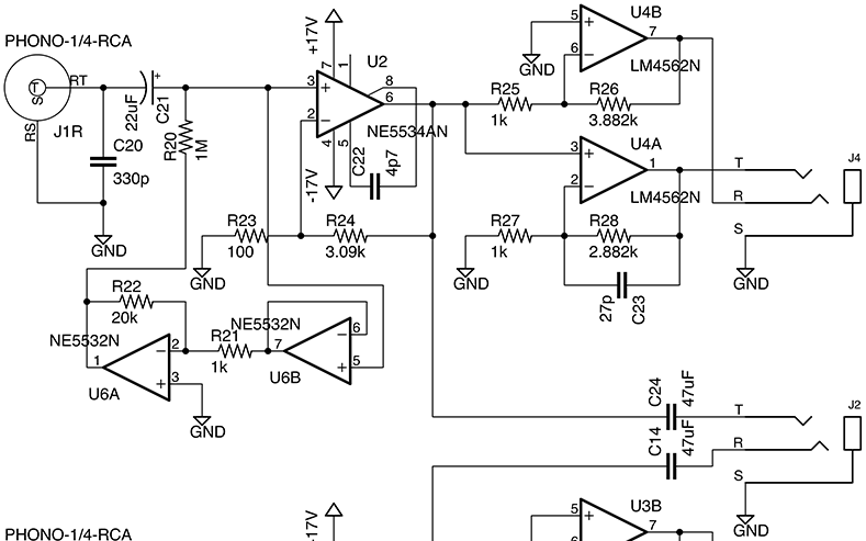

Here is what I have so far. See the attached schematic.
The 330 pF load capacitor will be reduced to 200 pF for starters.
The 1 MΩ input resistor is anti-bootstrapped to reduce Johnson noise on the input, since the typical 47 kΩ load resistor would produce more noise.
The power supply is ±17V for all three op-amps.
The NE5534AN has great noise performance for a turntable cartridge preamp, and it's output is roughly -10 dBV with this gain setting.
The NE5532N is a reasonable compromise dual op-amp that buffers the input from the 1 kΩ gain resistor.
The LM4562N stage is used to produce a balanced output at +4 dBu. Rather than the common balanced stage that inverts the signal twice, but would seem to add multiple stages of noise, this topology splits the signal and sends it through both inverting and non-inverting gain stages. The noise from either half is not boosted by the other half, and it should be reduced by 3 dB when the balanced signal is received. The balanced outputs are DC coupled because I know that my ADC can handle this (it presents a 10 kΩ load). I'd like to discuss balanced output topologies in another thread...

Have you read Bob Cordell's notes on cooled loading? http://www.cordellaudio.com/preamplifiers/vinyltrak.shtml
For the output my illogical preference is a cross-coupled output using THAT1240.
Keep in mind that you can't get below the cartridge noise. In a SPICE simulation the RIAA equalized noise of a Shure V15V cartridge is about 650 NV over the 20-20kHz bandwidth. If you amplifier produces less noise than that you aren't going to obtain a much benefit by reducing the amplifier noise further.
Ray: Reason I asked was that Bob puts the gain first, then the inverting stage as a follower. I've not dug into why that is better/worse, just noting it. A cooled load as Bob noted is useful if you are going to load down the cartridge to give a passive 75uS pole. Either way good to get these alternative approaches being discussed 🙂.
If you consider the ITU-486 noise curve, putting the 75uS pole ahead of the first stage militates against noise in the region in which we are most sensitive.
But that's not what the thread-starter wants to do.
It isn't, just noting that is where you get the most gain from the 'cooled' approach. Hans Polak did some sims last year on this Measuring phono stage RIAA accuracy with a computer . The improvement at 47k loading is small, but very significant with a 6k load, which is about what you need to passively provide the 75uS pole.
Yes, I'm reading Douglas Self, Small Signal Audio Design, where he offers his 'Elektor Preamplifier 2012' as one of many examples. I also just noticed that Bob Cordell's VinylTrak page references the same Elektor article.Schematic reminds me of Elektor May 2012.
