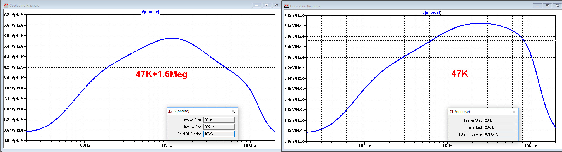

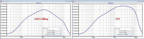

Noise in the figures below is RTI, after Riaa and after A-weighting.Ortofon Nightclub Mkii : 580 mH, DC 1 kΩ, 8 mV 1 kHz, 5 cm/sec
Thanks!
Gain from "cooling" in less noise production is 3,2dB.
Without, SNR ref 8mV is 20*log(8mV/671nV)=81.5 dBA and with it becomes 84.7 dBA.
As you can see in the noise spectra, up to 1kHz both are equal, but beyond the cooled version produces less noise.
I do not understand the 330pF cap at the input, much too high for the cabling if this is what you want to visualise.
Try to keep total capacitance under 200pF to start with, before you add anything.
Hans
Nice. Thanks.Noise in the figures below is RTI, after Riaa and after A-weighting.

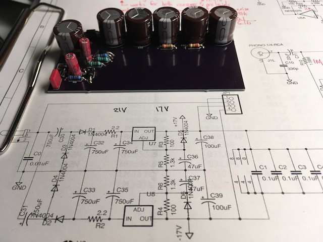

Here is the power supply. It takes in 12 V AC (I may switch to 9 V AC), from an AC wall wart with a standard barrel connector, and produces +/-17.5 V DC.
I used an AC wall wart rather than a DC wall wart so that I wouldn't have to create a virtual ground. It turned out that the circuit suffers from frequency response issues (in simulation) with a passive split rail / virtual ground setup, although that's mostly because I didn't have room in the tiny case to add an op-amp to buffer the voltage.

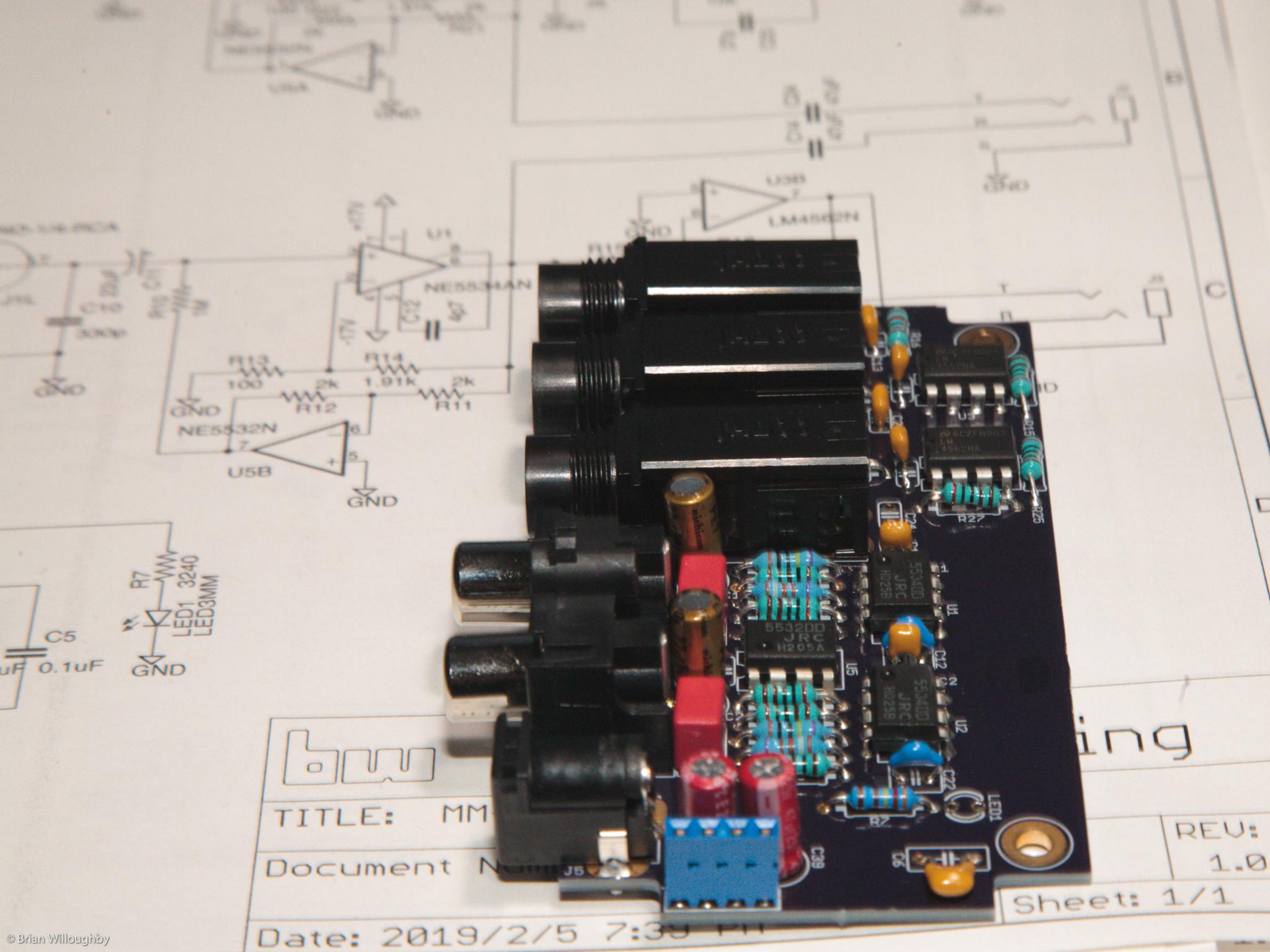

Here is the main board for the preamp. The LED hasn't been soldered on yet (still waiting for a different color).
The dimensions of the boards are constrained by the 32mm x 64mm x 104mm case that I found which has a turntable grounding screw on the outside. I didn't want to DIY the case, too.
With the lower gain, noise improvement is now 3.0dB just a little bit less.I have a 1 MΩ resistor now, and have reduced the gain of the first stage to 20.1x (+26 dB) to create a virtual 47.4 kΩ load.
Hello, great job!. I was looking for this exact thing and found this thread. Do you have any extra boards you would be interested in selling?
Sorry for the delay - I just noticed this.Hello, great job!. I was looking for this exact thing and found this thread. Do you have any extra boards you would be interested in selling?
If you'd like boards, just order from OSH Park. I shared my design there. Looks like they're not that cheap, though, because I designed 4-layer boards.
