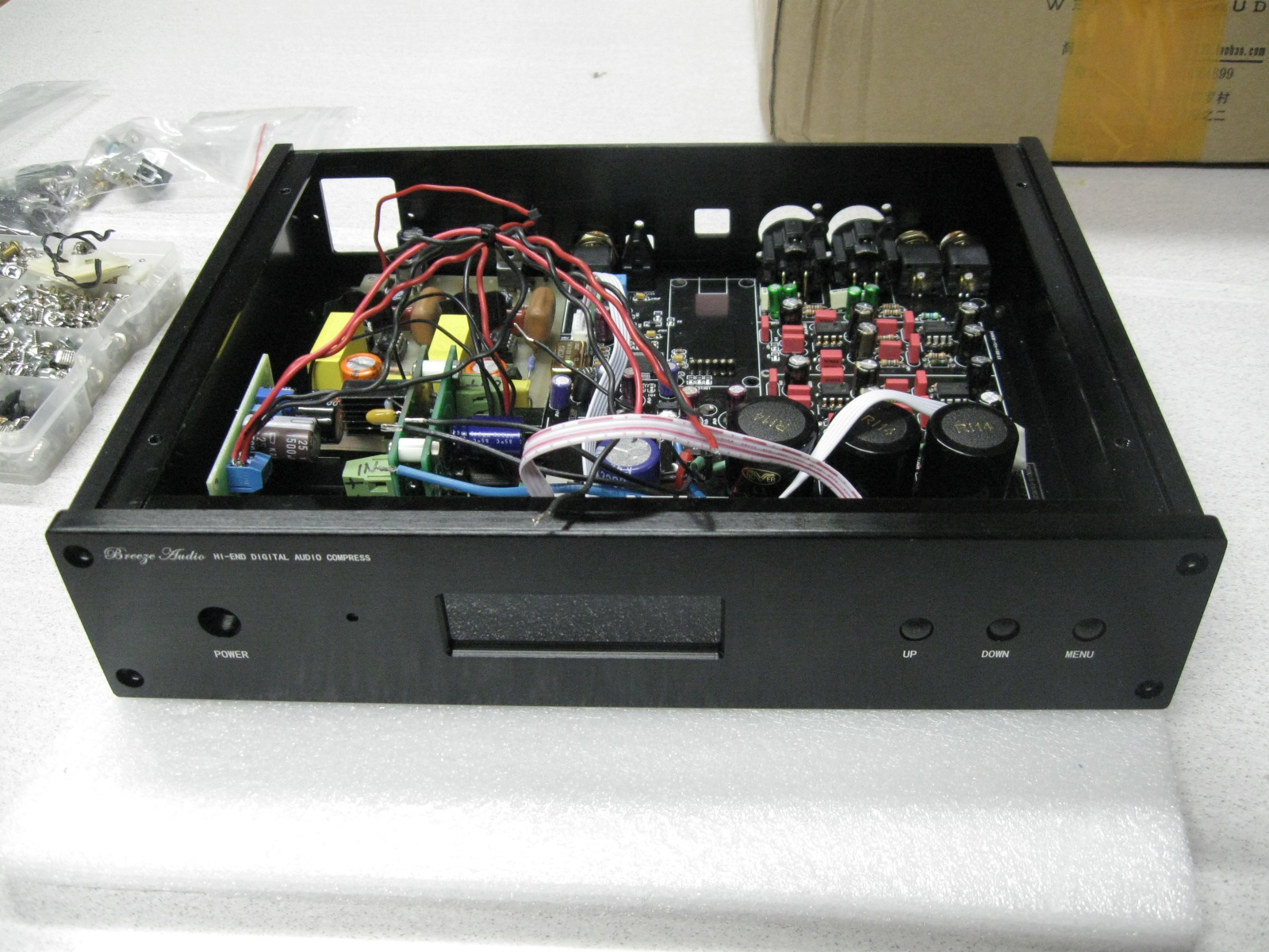

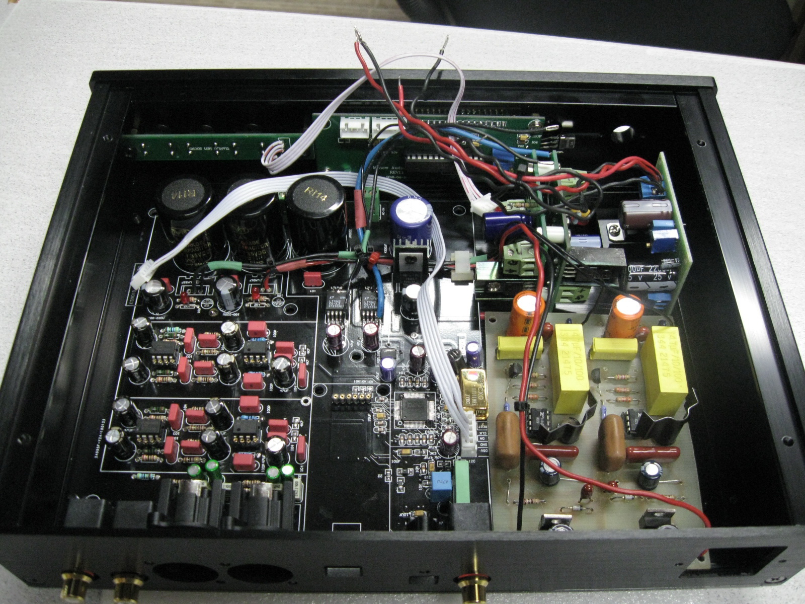

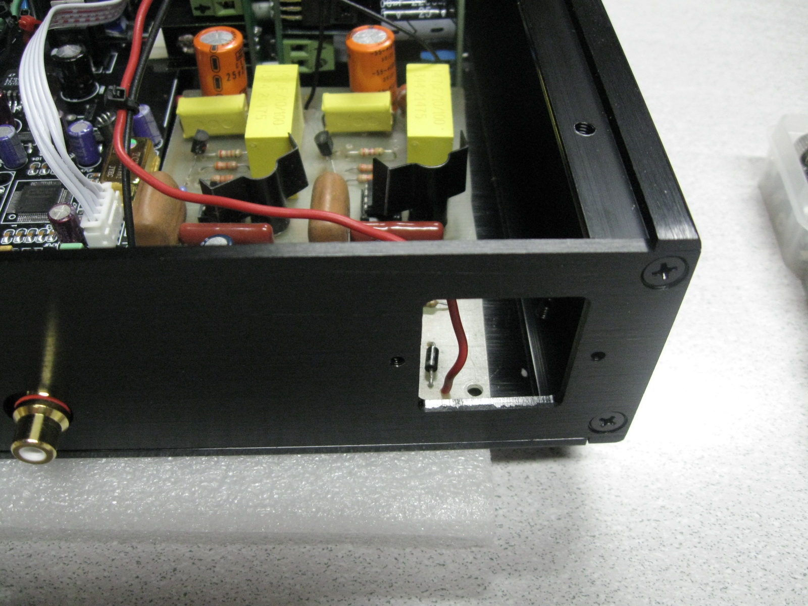

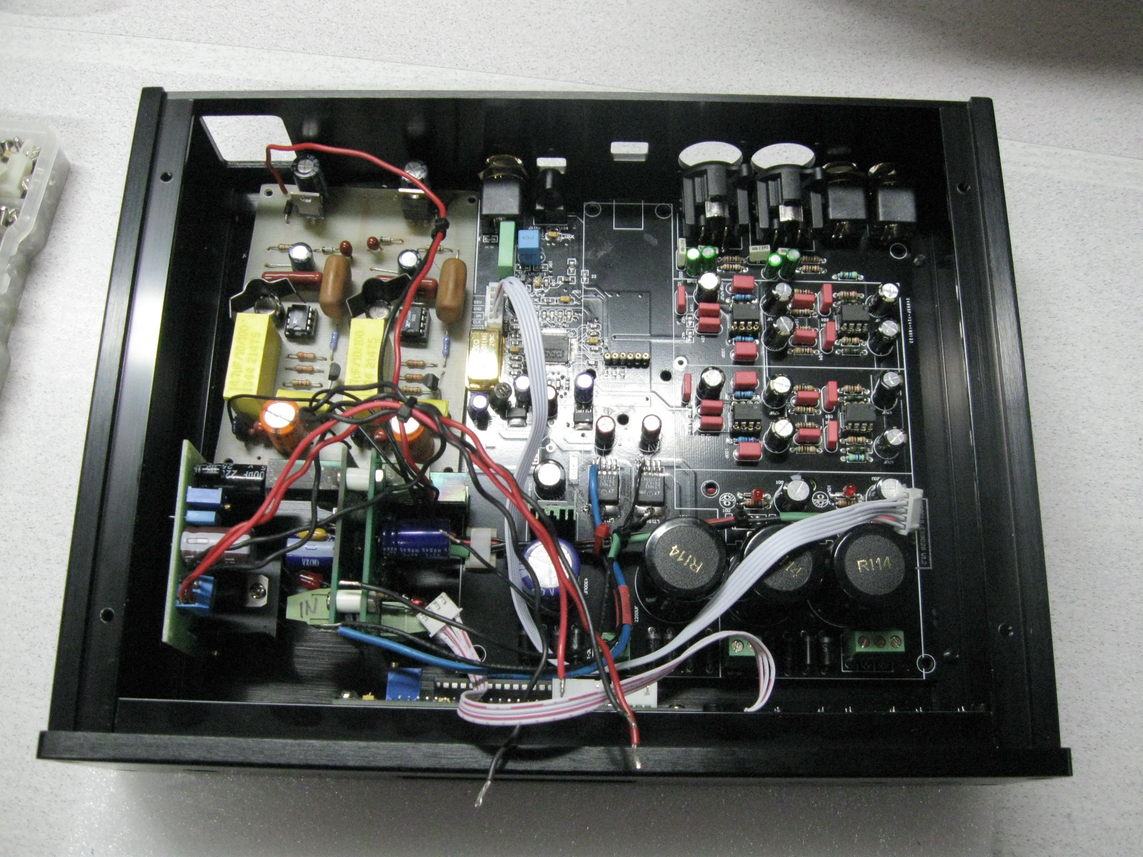

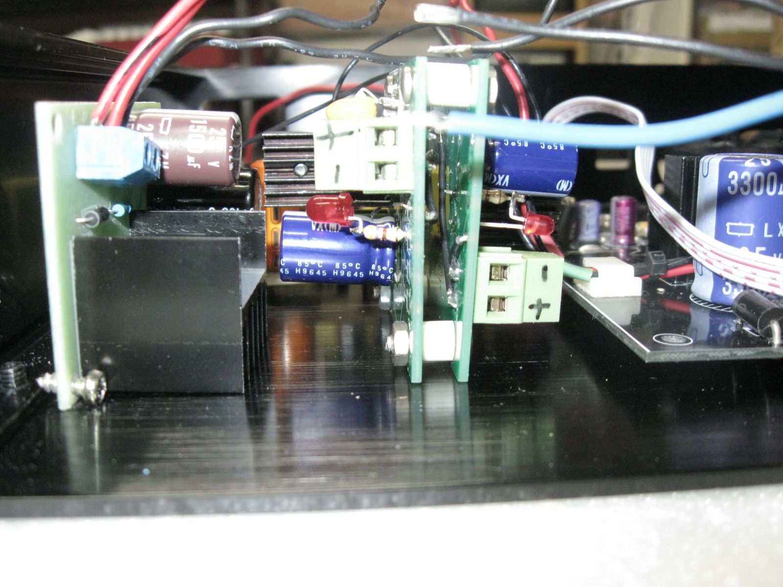

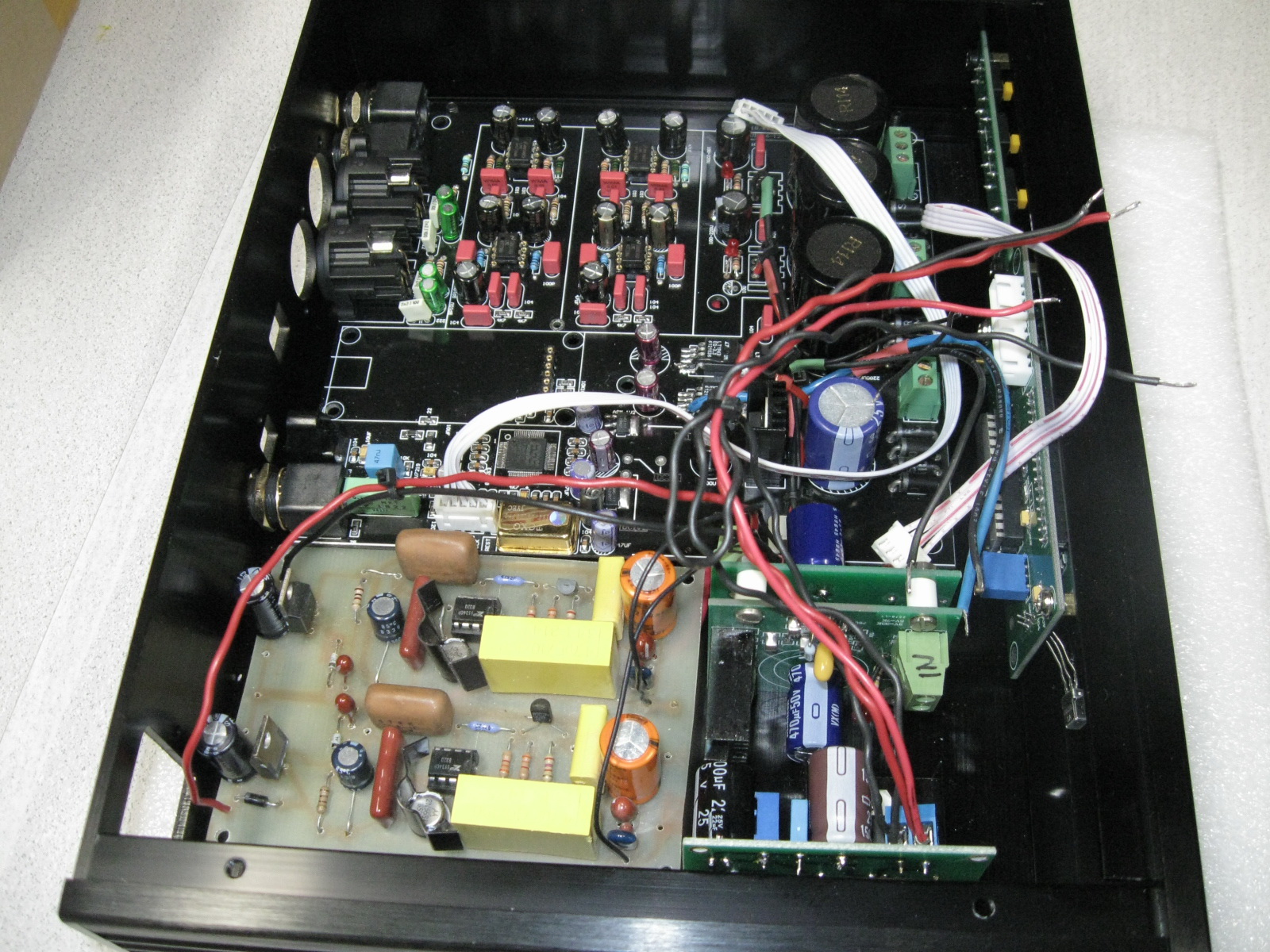

Dry fitting time to make sure that all the boards are physically able to fit and acquire what I will need for the final physical assembly. The wiring is still rough but when installed will be trimmed and new cables put it and routed and tied down. I will need to put in a filler plate over the IEC cutout and on this filler plate possibly put in one or two connectors to bring the AC in.

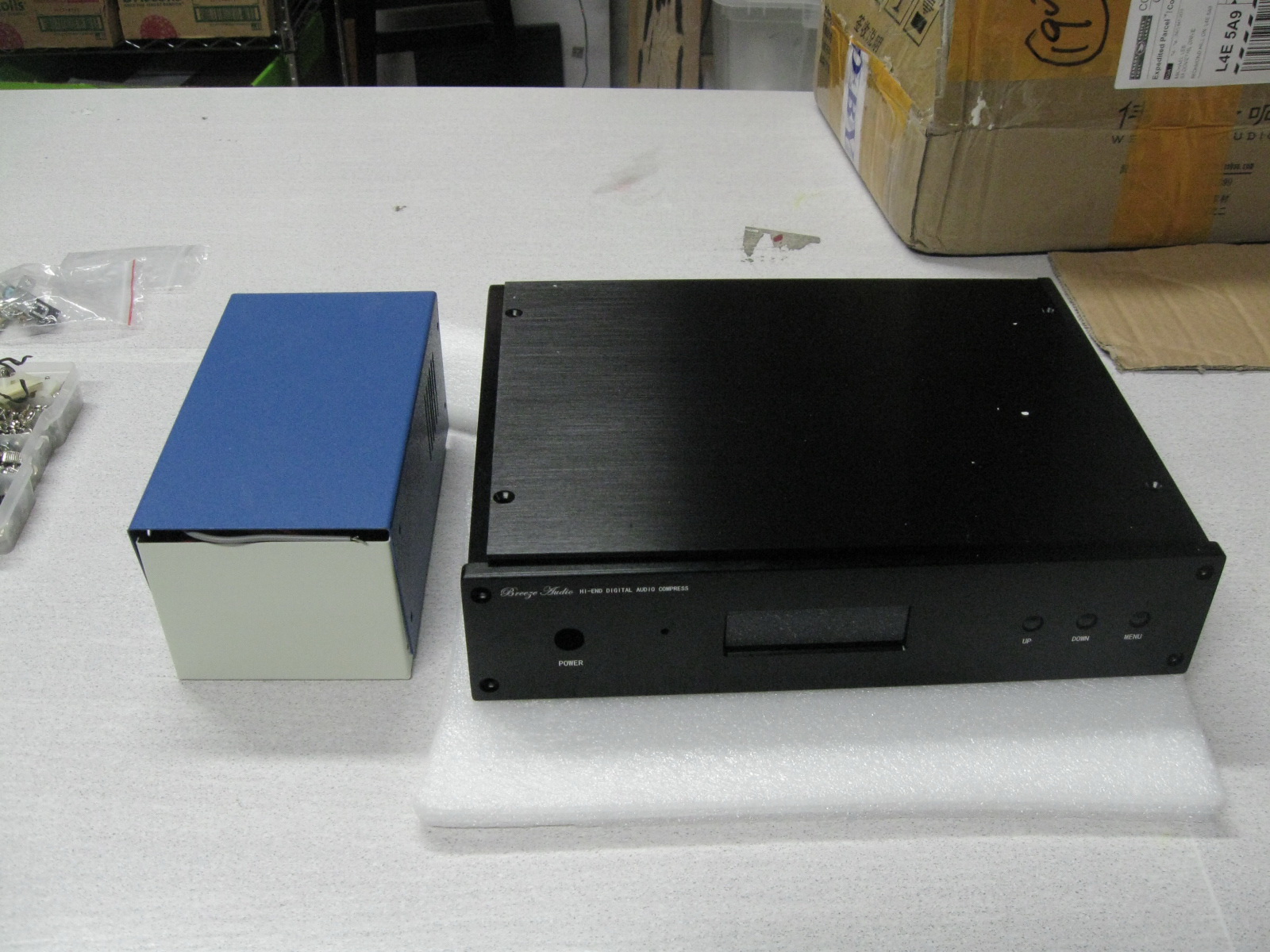

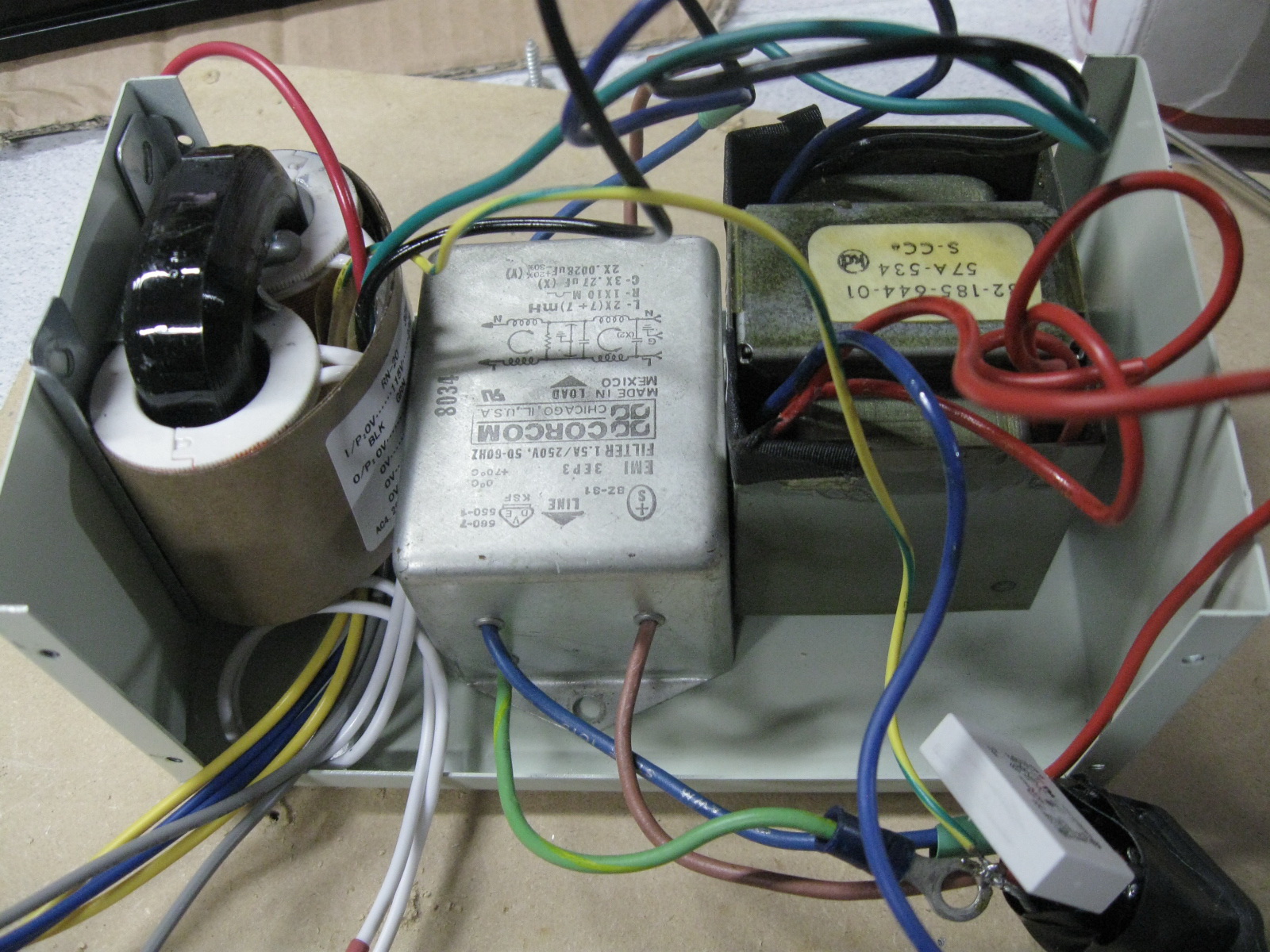

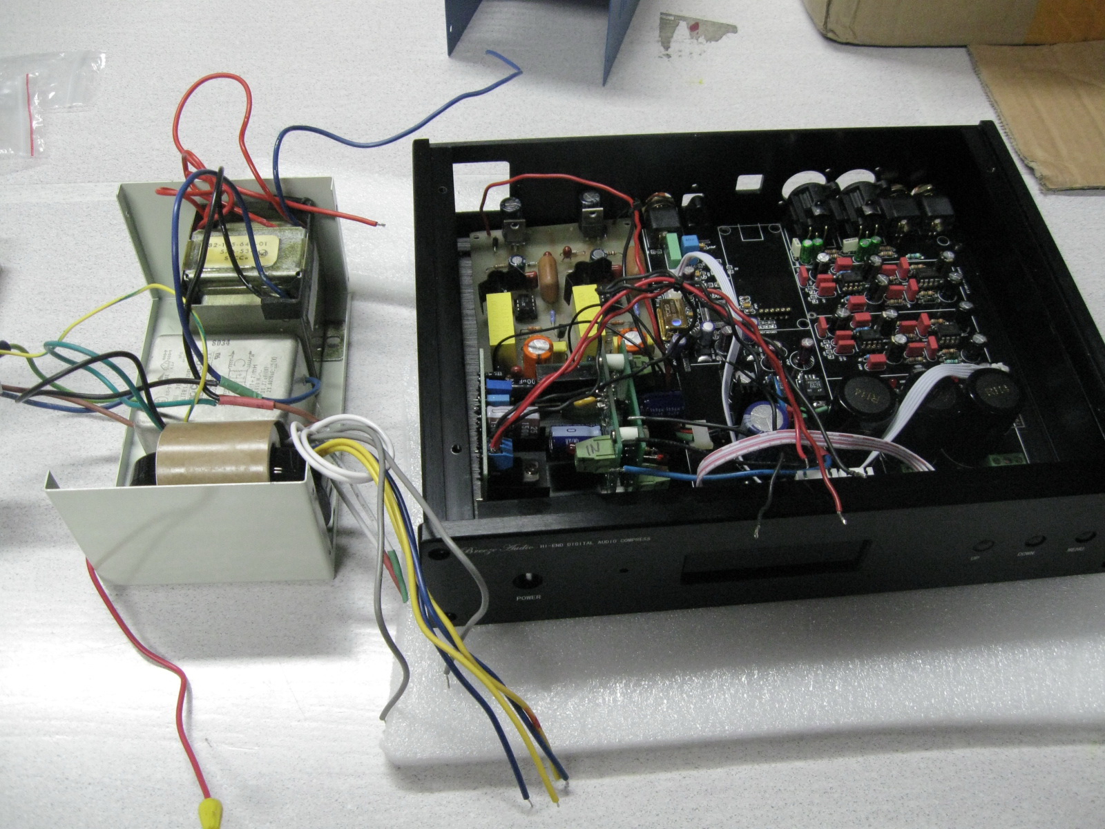

Now comes the transformer or remote power case.
I am trying to reuse as much of what I have in my storage. Last run of projects.
The first case, fit in the two transformers and the last one has some more space but will need some cleaning, spray paint and I will build an acrylic front panel and spray the rear black thus covering the holes already drilled out. Yeah, I could buy a new case that matches the DAC case. Still thinking about it and it could easily be redone in the future. The power is mostly tucked at the back that no one see anyways.

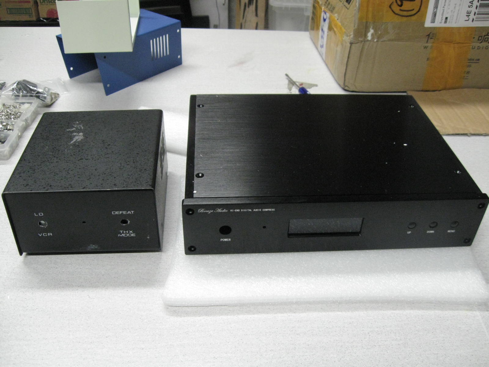

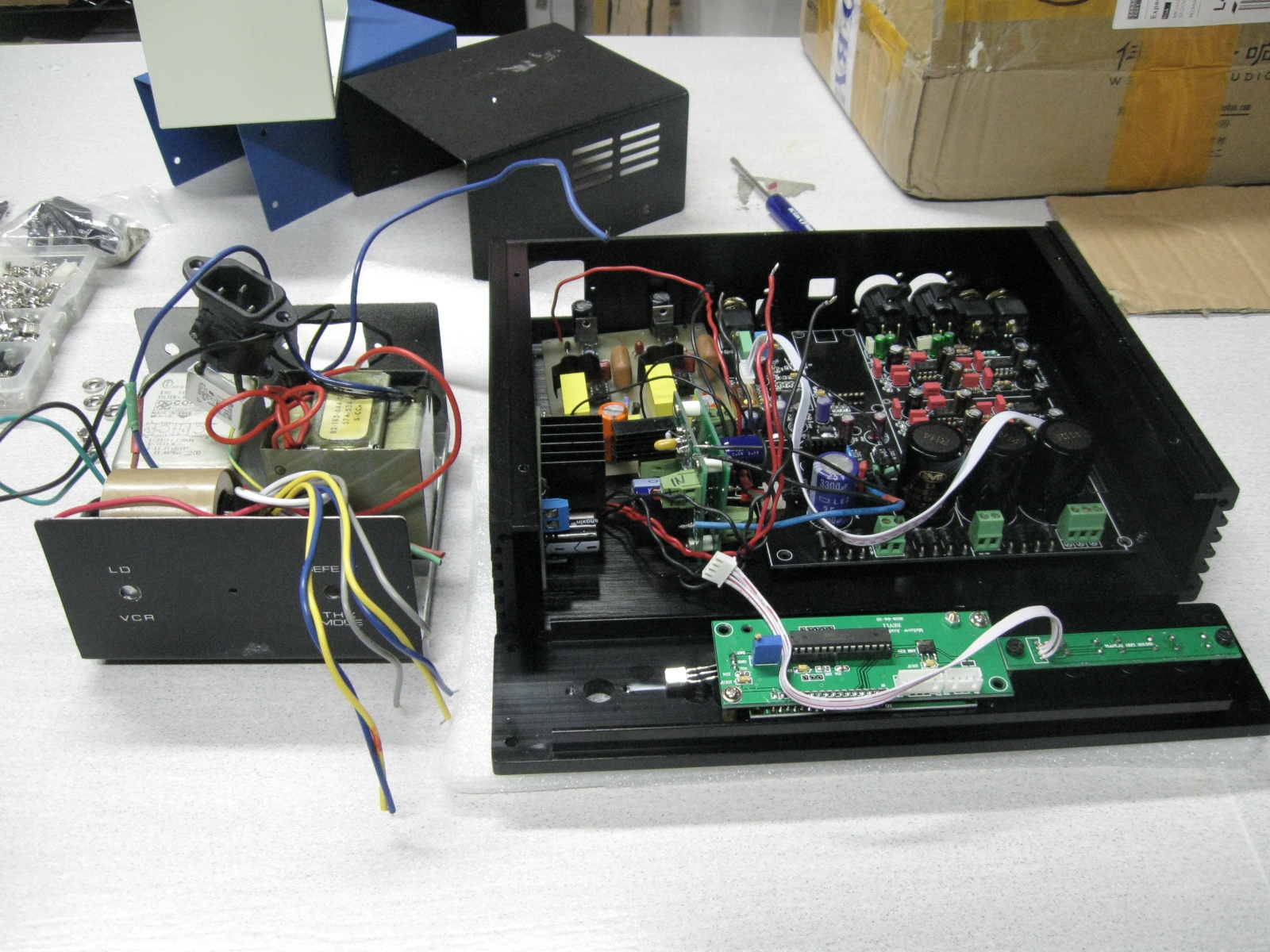

The final picture with the two black cases will likely be the look of the final DAC
That power case is repurposed from a THX EQ box I built in the 90s. Remember LaserDisc and VCR?
