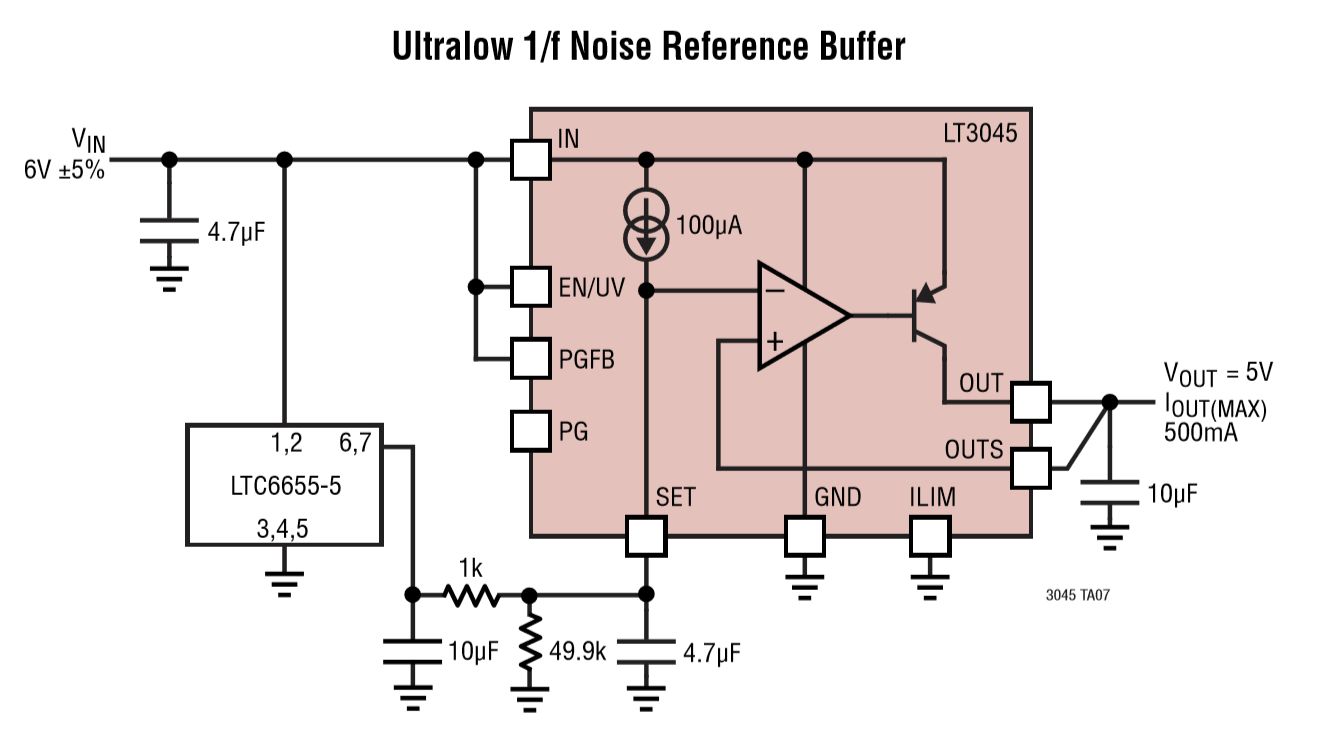

Isn't there a way to cure that LT3042 LF noise? A different or larger cap perhaps?
There are a couple of things. Best way is probably given in one of the LT3042 or LT3045 data sheets. See diagram below. Main problem I have found with using LT6655 is that it requires a physically big 10uf film cap for best performance, but I think Mikett found a prebuild LT6655 module that looks like it would work. Mike?
The usual way people try is less effective, and can be hard to retrofit. It involves increasing Cset in the LT3042 data sheet to the maximum value of 22uf. However, that will increase start up time of the regulator to a few or several minutes. Fixing that requires using the fast start up capability of LT3042 also described in the data sheet using the power good (PG) terminal.
The use of LTC6655 with LT3045 is, to some degre, a conundrum. There are
no measurements of the total (wideband in nV/rt Hz) noise performance on
either devices data sheet.
What we can probably assume, is that the VLF noise limitations of LT3045
are largely a result of ref current noise // set resistor noise as opposed to
the internal opamp itself.
As such a simpler way to get better 1/f noise is just use a much bigger, say x
10 = 220uF set pin capacitor and a pull up circuit on start up.
There are a few fairly simple ways to do this.

That is exactly what I am saying. If there is a benefit in the sub 10Hz
region in using LTC6655, then the LT3045 MUST not be the bottle neck or
it would dominate.
The circuit you have posted above from data sheet merely over rides the self noise of the 3045's CCS and the set resistor. It's internal opamp noise can
not be reduced by this arrangement.
However, we happen to care about that because LF AVCC noise will intermodulate with the dac analog outputs to increase distortion.

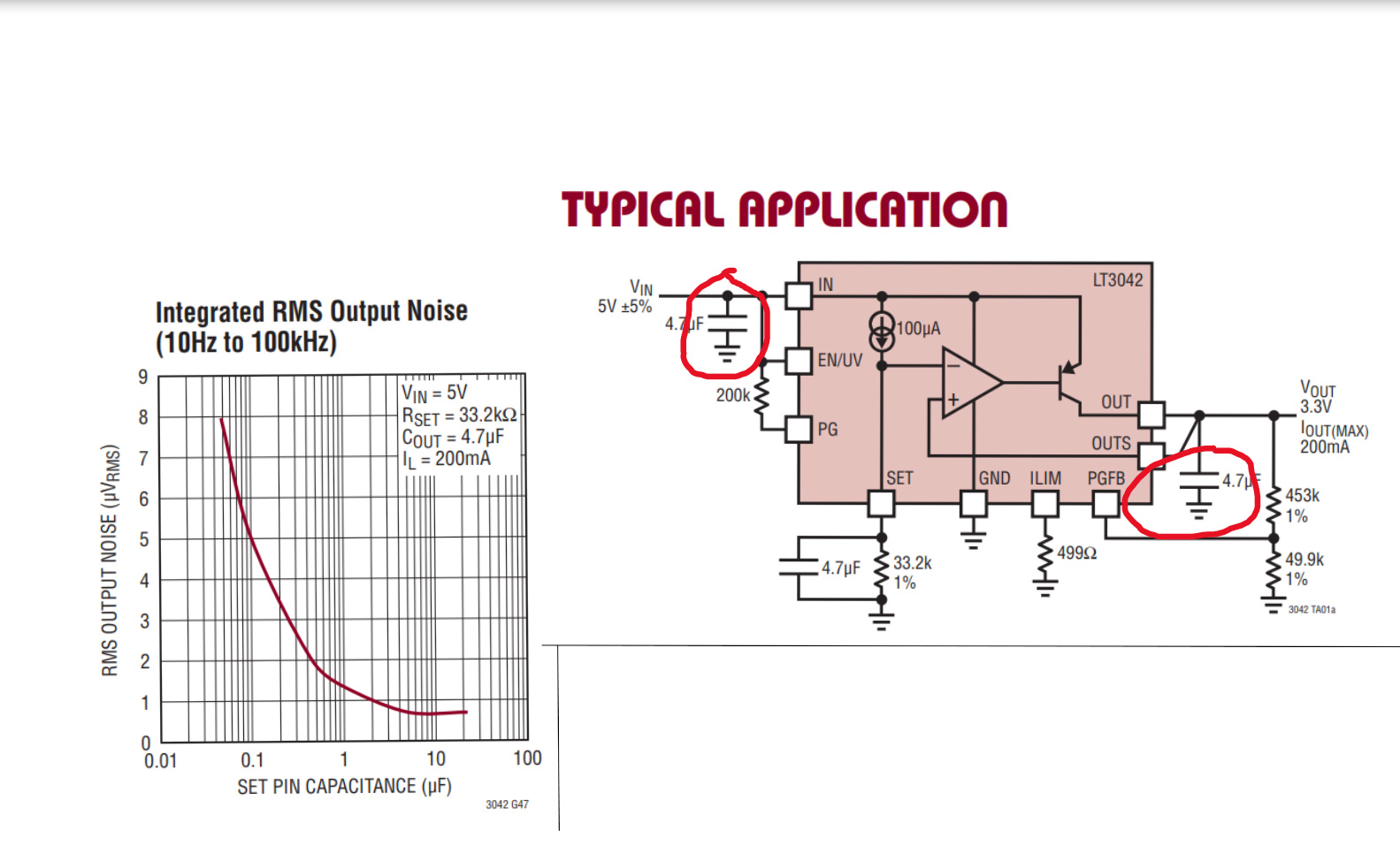

I have a few questions:
1. What would be the benefits of using 7805 instead of 7808 as pre-regulator. Less heat for LT3402 ?
2. Cset capacitor LT3402 are we talking about the caps i red circles? is MURATA X7R apropriate? As per datasheet lowest noise is achieved using capacitance between 4.7 uF and 10 uF. why use 22 uF? In the graph there is a sliught increase from 10 uf upwards.

Cset is the cap connected to the set pin. It is the cap not circled in red. 22uf is the maximum recommended value to minimize low frequency noise, but it also slows down start up time. Therefore, the fast start up option should probably be used if Cset is increased to 22uf.
5V vs 8v would reduce power dissipated in secondary regulators. LDOs don't usually need much extra voltage, although a little more like 8v might be good in some cases. Haven't really tried to see if it helps anything.
