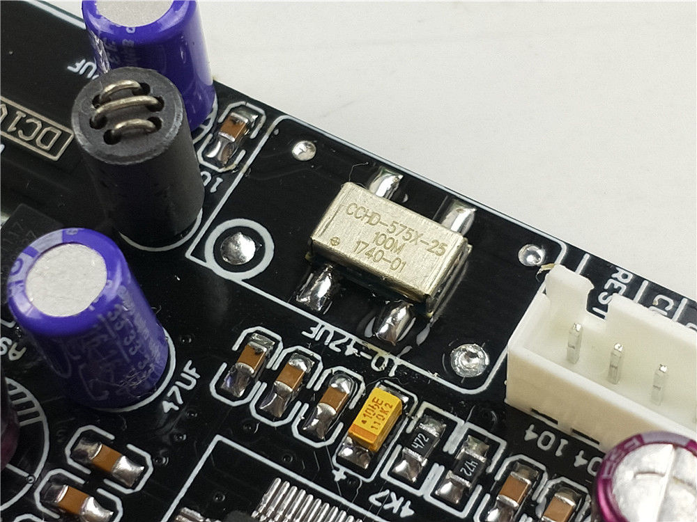

In the next while I will continue to use the DAC at the stage it is right now while I acquire a new crystek clock and await the SuperRegulator power supply PC board to arrive. When these two items have arrived, I will then case up the project.
I added some additional heatsinking for one of LT3042 because the high upsampling frequency is causing the Digital lines of the DAC to consume significantly more current. I will also have to drill some vent holes directly below and above the heatsinks to keep the components cool.
So far this DAC is now at a stage where every change is resolved very quiickly. It is a revealing DAC without harshness, in fact, if a component does introduce some distortion like the 4392 SRC converter, it will reveal it. The nice aspect to me is that all the components to bring it here are pretty much off the shelf. The only real construction will be the SuperRegulator Power Supply which is readily available at the DIYAUDIO store. Thus this can be a straighforward project for the intermediate builder.
Since the last posting I am still listening with the SRC. Each time I listen I come back in awe of what I am now hearing.
Does it get better. Yes. I will be ordering a new Crystek oscillator. The nice thing is that underneath the current oscillator, there should be SMD pads that allow easy mounting of the Crystek 575 oscillator. YEAH. That WAS a nice discovery.
