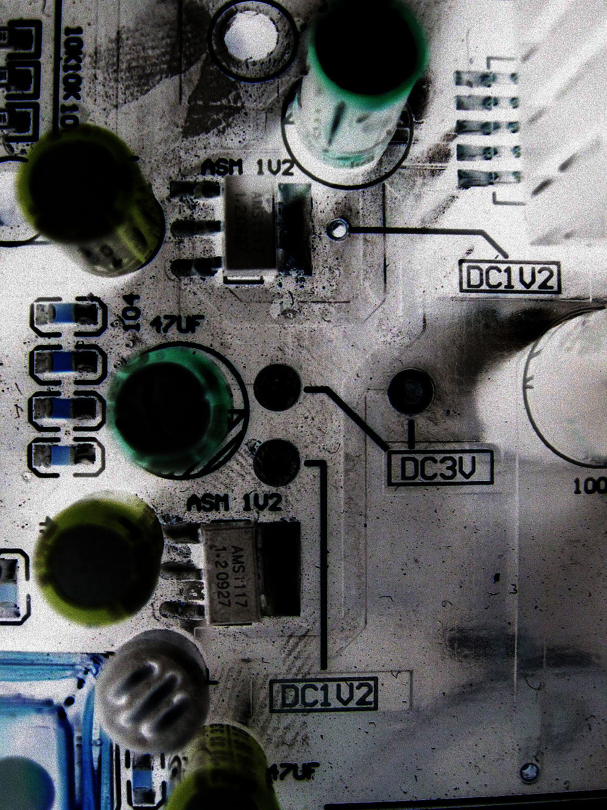

Is that a mulit-layer board for sure? Maybe so, but they usually try hard not to. You can see some traces under the solder mask when a picture is highlighted a little.
Judging by the traces and where they lead to, it has to be because there are points where there are no vias that are visible at all. So unless I am blind and I used a magnifier to check and found the soldering that initially I thought was an error immediately as a result. I think it is at least a 3 layer board. I also looked for raised traces as well.
