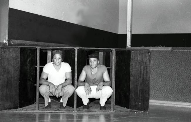

Richard Long's Bertha (2 x 18 bin) and Levan (mouth) was the main stay of the New York club scene in the disco days. The horn isn't for portable installs, the mouth was 42 x 96 inches and a few 42 x 120 inch mouth versions were made. The cabinet was 6 feet from front to back with the horn mouth installed. I helped Richard install a double pair of the 10 foot mouths stacked on top one another on each side of a dance club. The usual driver was a custom Eminence, the expansion was hyperbolic and it covered 25 to 100 Hz. With the increased power hadling of todays drivers I wonder what they could do with several kilowatts. There are a few builders around who build copies. EAW built some as well.
If i am not mistaken Richard was all about appropriate power? A friend of mine learned from him and Dash and installed Twilos system - the Phazon. Things go blurry after a while but I remeber being shocking how efficient they were. Also the bumber car ride on Coney Island has a Long system redone by my friend that had a Long J horn and a bunch of nice gear. Not what you would expect for bumper cars
