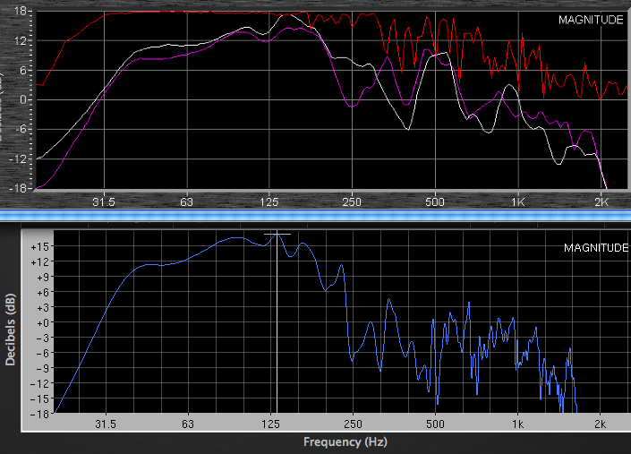

While you are waiting for that, you can compare the frequency response of the DSL TH-115 (purple trace) TH-118 (white trace) and the Welter Systems Keystone 18, (blue trace).Thanks for the info, I like the review of it, waiting on a reply from the dealer to see what that will cost and also trying to contact the guy who gave the review.

The TH-18 is almost identical to the DSL TH-115/TH-118 folding, though the throat is a bit different.
The Keystone folding is quite different from the DSL TH-118, yet the frequency and phase response is quite similar due to similar path length, expansion, cabinet volume, and the same speaker :^).
At any rate, I'd expect the three cabinets to sound pretty similar, though DSL's sensitivity (and hence, max output calculated from sensitivity) seems way high when compared to sims and other commercial subs and my own comparison of the Keystone to a JBL SRX 728.

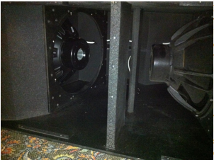

The screen shot below shows the chamber on the left side, the outer speaker was removed to check if there was some physical problem that was resulting in the crappy sound.
IIRC, Hornresp does not have a parameter for the enclosed "isobaric" volume, that area being excessive may result in a low frequency simulation lower than the measured response.
Your sim shows much lower response than the 421's 27 Hz F3, which would also make your sim's output much lower than actual.
