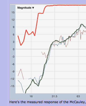

The M421 drops off at about 36 dB per octave below Fb.3) The McCauley sub goes lower than both, but WOW is that a big heavy expensive box. (The drivers alone cost $3400 versus about $203 for a TH-Mini and about $330 for the Pi sub)
One thing that's a bit of a mystery to me is why the rolloff of the tapped horn is shallower than the sims would predict; sims say 24dB per octave but Jeff Knorr's measurements are showing about 12dB per octave. Odd.
The lack of coherency (red line) indicates the bump at 16 Hz is from some outside noise, probably wind or a passing truck.

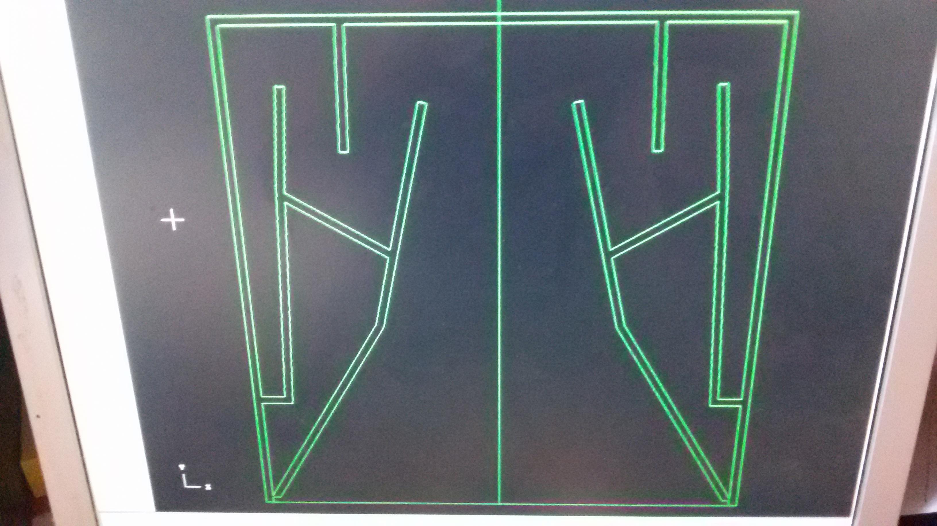

Hi! It's been ages since I've been on this forum. I saw this thread a while now and have always wondered if a single 18" horn can be modeled using the same folding as the Martin audio 215 mk III with consideration given to the mouth size since it will use only a single driver. I I haven't been around to using horn response so I would really appreciate some help. I have heard the mkIIIs and I totally agree that the bass is truly gut wrenching.Martin 215 mk 2 - Speakerplans.com Forums - Page 20.... A decent driver I might say http://www.rcf.it/products/precision-transducers/low-frequency-transducers/l18p400...
I had the help from Neo Dan with my last two subs and is still very happy with them. I just want to explore a bit more on something new...

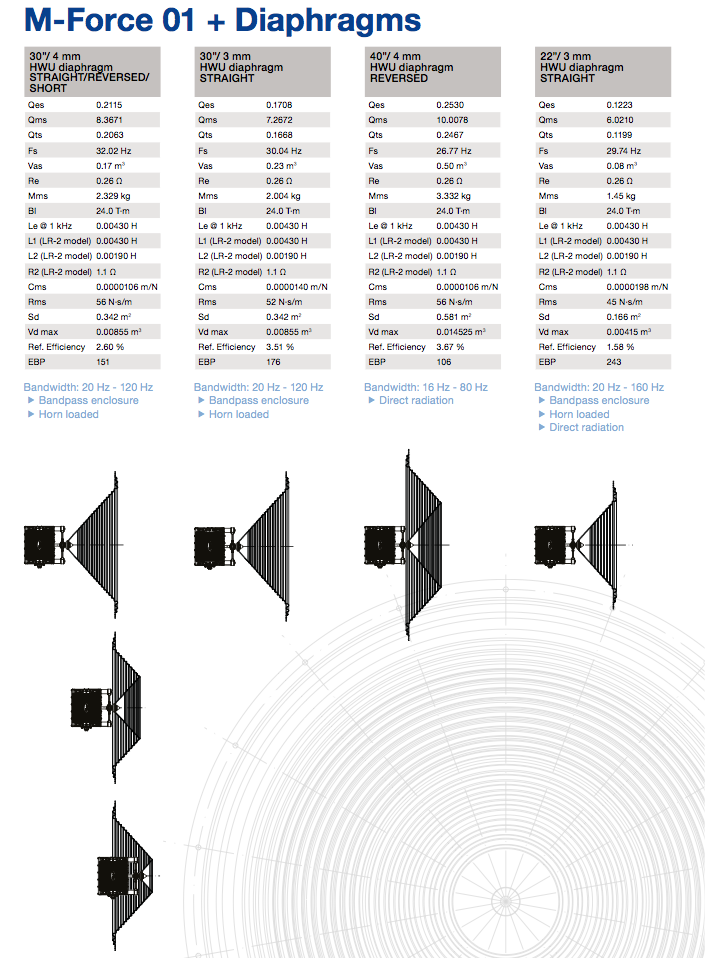

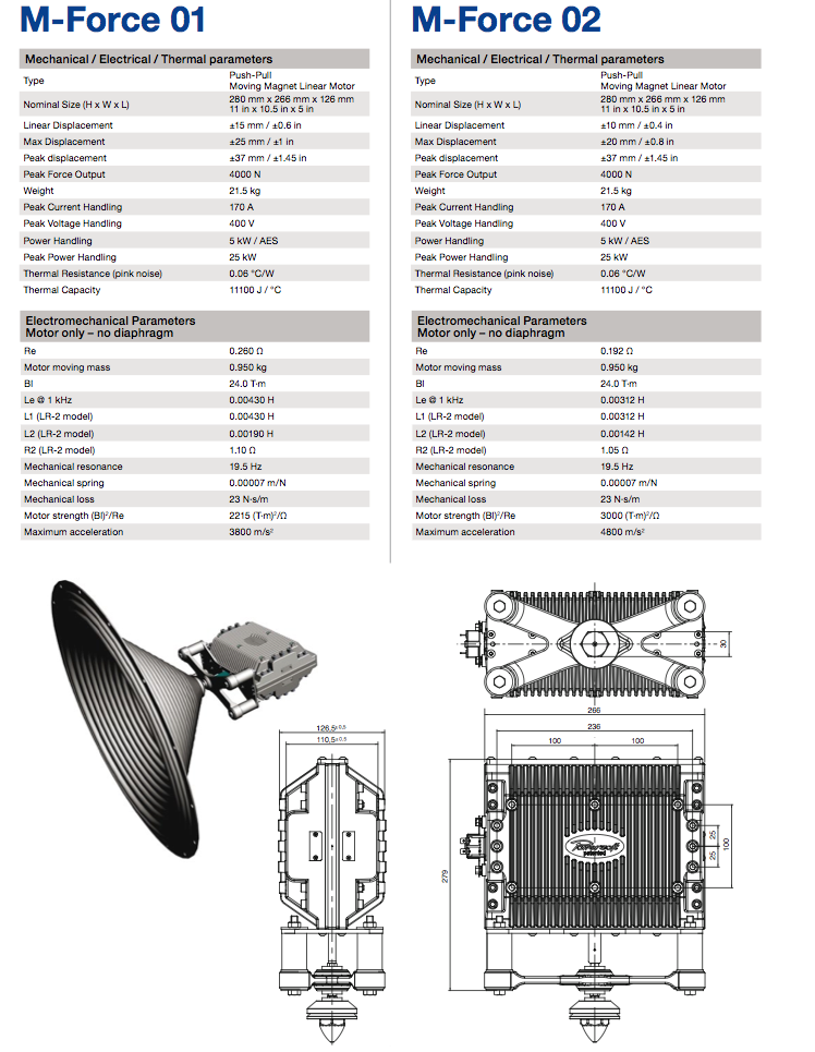

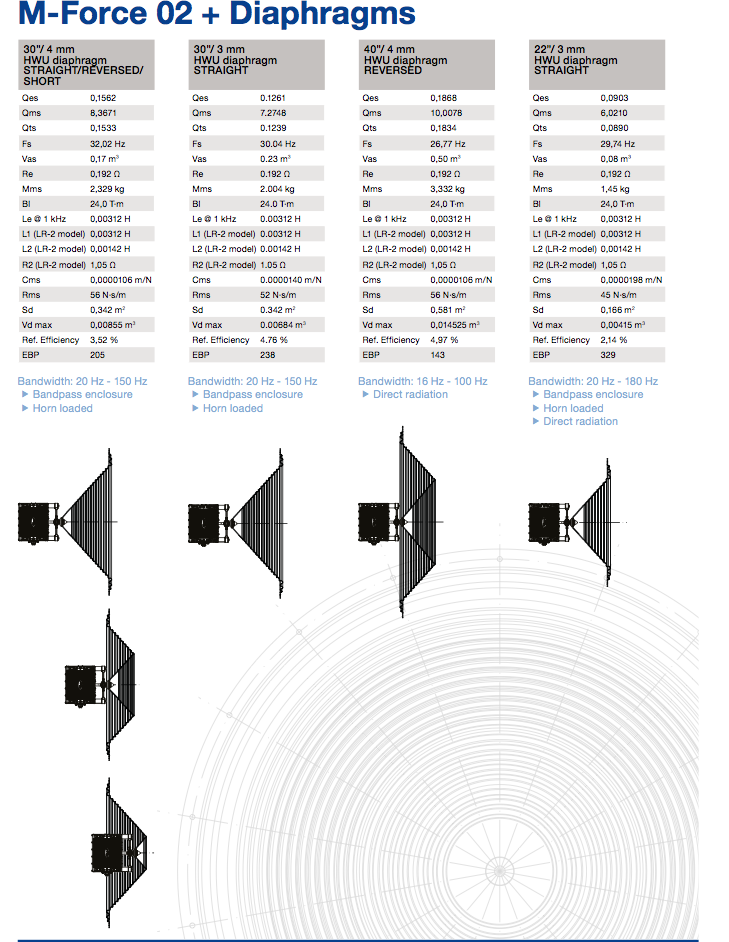

In my previous response I had forgot Powersoft's development of the M-force moving magnet driver since posts 8 & 10. The claims of 150+ dB at one meter from a single driver look very possible, but have yet to see any actual measured response of cabinets utilizing the drivers.thanks welter . which is now the best loud and clear according to your opinion sir??
The M-force is a good design for Band-Pass enclosures and bass-reflex type, it could go to around 145 dB but there is no way it could go to 150 dB in the sub passband. Not even the 40" one. Very hard to get it to work as a sub in a horn even with the flexible parameters.In my previous response I had forgot Powersoft's development of the M-force moving magnet driver since posts 8 & 10. The claims of 150+ dB at one meter from a single driver look very possible, but have yet to see any actual measured response of cabinets utilizing the drivers.
