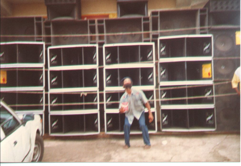

The McCauley M421 as was referred to earlier I think is very close in design to the Martin 215, I do think however that you guys are correct in that I was just told by my friend who had a lot of the Martins in the early 80s that one Martin will not give the effect I am thinking of, he said at LEAST 4 of them will do but under that he's not sure., I have attached a pic of one of his rigs which he had used in 1987 which was what I had heard for the first time.
Ok so we are narrowing this down, for my very small application, which ONE cabinet would you guys recommend will most likely give me the closest effect of the Martin?
That's also meant to be clustered in fours, and the driver is a 24" - where is he gonna come up with that?
That's a sick setup!
Yeah some serious bass came out of that rig which was only half of this guys's total equipment, later on he and all DJ's down there switched to the L36 mainly because the Martins were simply too heavy and odd shaped.
