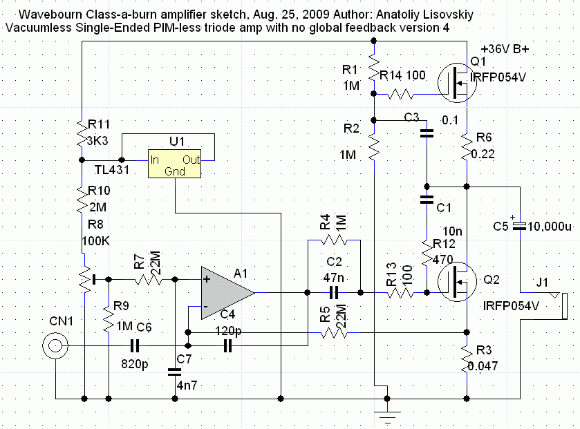

Re #119 Schadeode:
That was smart wiring C1 as an ultrapath.
High impedance at Q1's drain makes all the
power noise B+ common mode, so it can be
rejected.
Would PSRR have been even better with R3
upgraded to CCS?
Great minds... I'm going to experiment with a CCS next. Mainly to make the amp DC stable, but it can't hurt the already excellent PSRR. A cascode V/I converter is also in the works, but maybe for a "real' amp build.

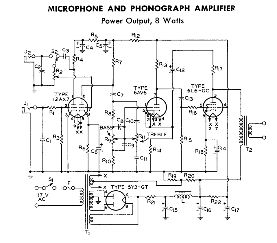

Schade or not?
I am not suggesting the attached schematic (from the RCA handbook # 20) is the latest and greatest, its highly likely just the opposite.
1) However I wonder if there is merit in having the feedback connection attached to the cathode of the driver tube instead of to the anode. It adds another capacitor in the path but are there advantages offsetting it? Perhaps it is something that may work better in (or improve) the Schadeode design?
2) Can this feedback still be regarded as a Schade feedback or is it something else?
3) I noticed the filaments sitting at something like 60VDC above ground and suspect the RCA engineers have done this for a reason. Is this to extend the life of the tube or is it for another reason (cathode - filament diode action perhaps?) Don't know and am interested in finding out.
As mentioned before in another posting: Although the 6AV6 is not identical to 1/2 of the 12AX7 (diodes and lower anode disspation) the curves are identical to 1/2 12AX7 and it can be replaced by 1/2 of the 12AX7. So one can leave the microphone section away and have an amplifier with (dare I to say it) tone control and approx 200mV sensitivity. Or one can leave the tone control altogether away.
I look forward to the thoughts.

1. Schade is parallel feedback by voltage; this one is serial feedback by voltage. Schade requires more current from driver, this one requires more voltage to drive driver. Schade decreases input impedance, this one increases it. This one adds substraction error, Schade does not. Schade shunts Miller capacitance, this one does not.
2.No
3. Hum reduction
PS: speaking for the amp from RCA book, go for it!

I am confused by the above remark (still relatively new to tube audio), does this mean that Schade works better (pentode is looking more like a triode with the advantages of a triode but with more power than the triode)?
Hum reduction: yes that is something that is very helpfull.
... go for it: in your opinion would this a better design than the RH807 (1/2 12AT7 + 807 with Schade feedback) It would be relatively easy to change, same chassis layout just change of driver tube.

"substraction error"
The input to the driver tube is defined as the grid to cathode voltage, so moving the cathode V should be just as good as moving the grid V. Afterall, global neg. fdbk has used the cathode insertion mode successfully for an "eternity".
Since tubes naturally work best with high load impedances, the Schade technique is actually somewhat awkward, since it lowers driver input Z. Putting the feedback to the driver cathode instead raises the input Z, but requires more voltage gain then (which tubes are good at) and is a little trickier stability-wise across two gain stages (but more effective with the consequent higher loop gain, and certainly manageable without an xfmr in the local loop, like Schade's original setup had).
For Schade, the driver either needs a pentode with plenty of cathode degeneration to linearize it's V to I transfer, or a triode with lots of cathode degeneration to raise the output Z, or a series loading resistor to the output grid to linearize it's loading. These all throw gain away too. No clear winner.
The two schemes likely have somewhat different distortion profiles, which RCA (the handbook circuit) may have taken advantage of to tailor the final result by using some of both. Another unseen factor, with either version, is the slight variation of diffl. stage gains by means of common mode feedbacks altering the common mode stage biasing dynamically (unless CCS'd tails).
Some attention to PSRR is called for with either approach since the feedback source is B+ referenced, and the feedback insertion is often ground referenced. Some clever fixes possible with bypass caps or a pentode pre-amp.

Thanks to all for their replies, much appreciated.
It is not yet clear to me if the feedback from the plate to the cathode of the driver results in the pentode having triode like curves. Perhaps someone can enlighten me on this one.

1) I wonder if there is merit in having the feedback connection attached to the cathode of the driver tube instead of to the anode. It adds another capacitor in the path but are there advantages offsetting it? Perhaps it is something that may work better in (or improve) the Schadeode design?
While not Schade I suspect it works extremely well as it is identical to KYWs ideas - which he explains:
Using two stages for feedback (driver + output) allows a very low output impedance to drive the OPT, therefore greatly reducing distortions in it.
These two stages also have some self cancellation of distortion (IIRC) so the feedback loop is not working to hard - so maybe only a tiny bit of THD will be moved up the harmonic scale - perhaps to the 4th?
I'm not sure if miller capacitance is such an issue for driving pentodes but as the output tube is wired as a pentode you do get the easy drive, any miller capacitance can be I think ignored due to a decent current run through the driver (and the feedback loop).
