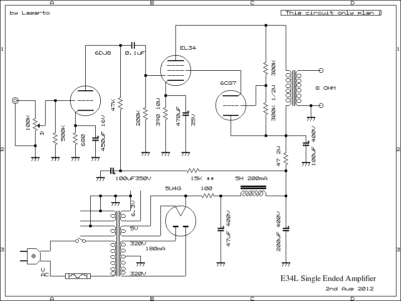

The EL34 plate voltage goes well above the B+ for half the audio cycle. This will make the 6CG7 unable to act as a follower for the screen drive since it only has B+ available at best.
One can either try to bootstrap up the B+ going to the 6CG7, or use an R divider for the 6CG7 grid from between the EL34 plate V and 0 V instead. (the 6CG7 plate supplied from the EL34 plate then.) This reducing type divider works well for TV Sweep type output tubes since they use a lower screen V.
