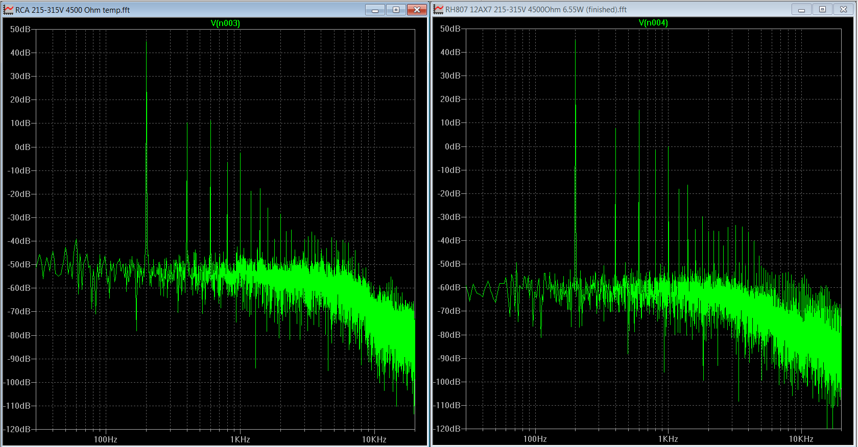

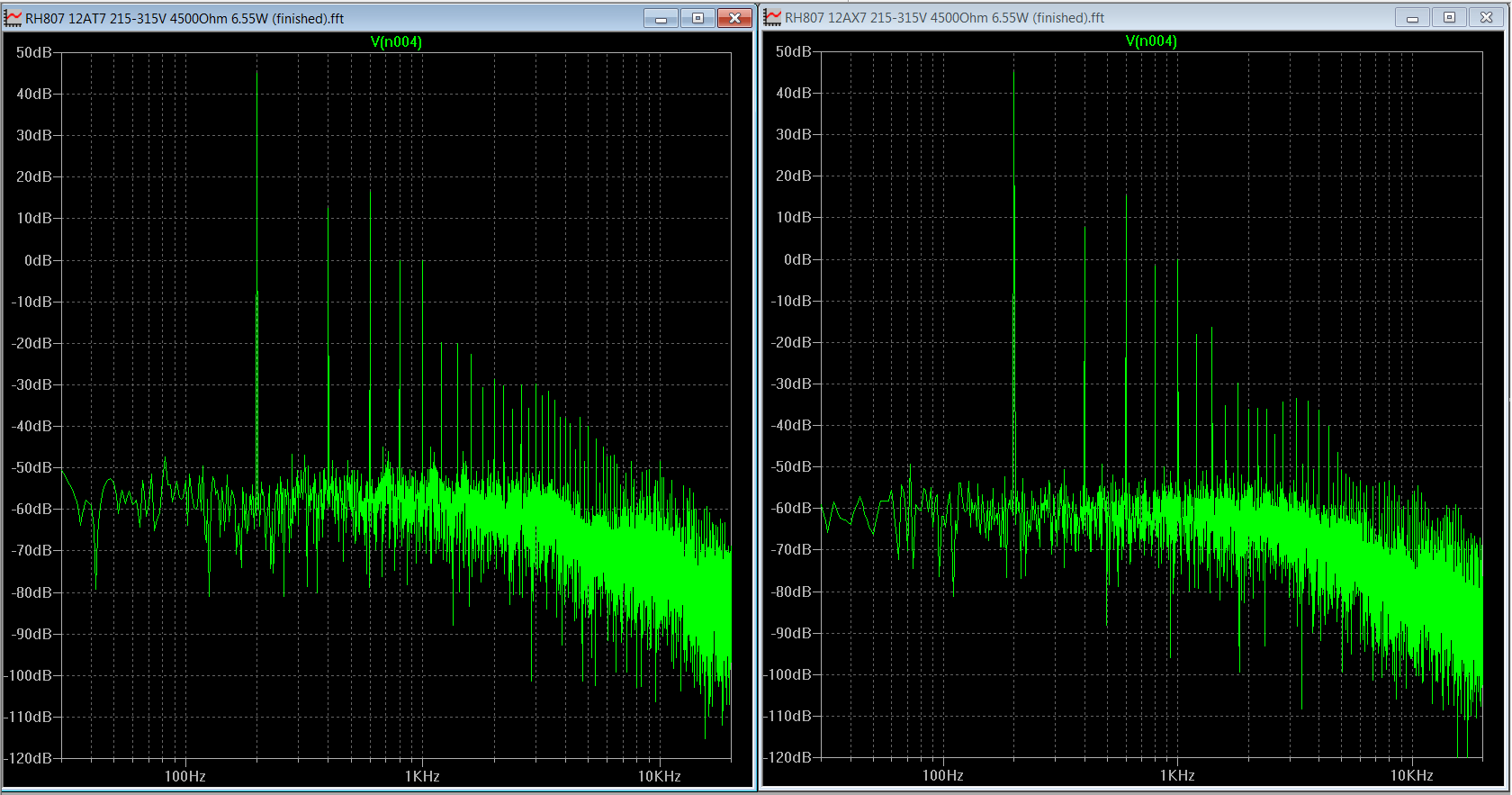

While I am waiting to move into our new house (supposed to be ready over a week ago) I have all my gear packed up. Only thing I am able to use is the computer so I installed LtSpice and have been playing around with it.
It has been suggested to me that the RH807 is inferior to the RCA Handbook #20 phonograph design or that the 12AT7 is inferior to the 12AX7.
I am attaching some screenshots of the FFT that I managed to get in LtSpice with the output in same biasing (Vg2, Va, Rc, Vg1 etc).
The first is on the left comparing the RH807 driven by the 12AX7 and on the right the RH807 driven by the 12AT7 and the second picture is the difference between on the left the RCA with the 12AX7 and on the right the RH807 with a 12AX7. I do not yet fathom all the implications of these FFT but undoubtly the more knowledgeable amongst the readers will be commenting.
To me it appears that the design is of greater importance than the tube itself.
PS I am not saying that these designs presents the latest and greatest results, I am just comparing two different schematics with same tubes and output configuration and only changing the driver configuration.
PS2 the text in the headlines is not correct: all output configurations are the same.
Enjoy
AM

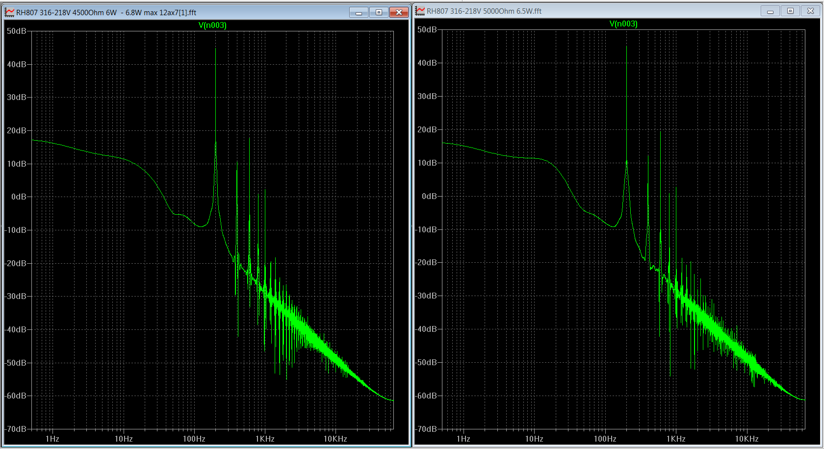

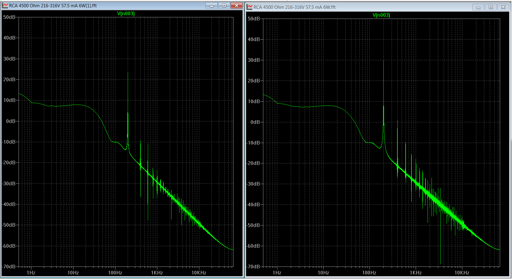

Use a later start time, give DC time to settle, your FFT should not slant that much.
Also add ".options plotwinsize=0" without the quotations marks...
Here the updated screendumps. Text in headings is correct, output stages are identical configured with identical voltages only driver is changed and driver configuration is changed.
Look forward to more comments, thanks.
AM

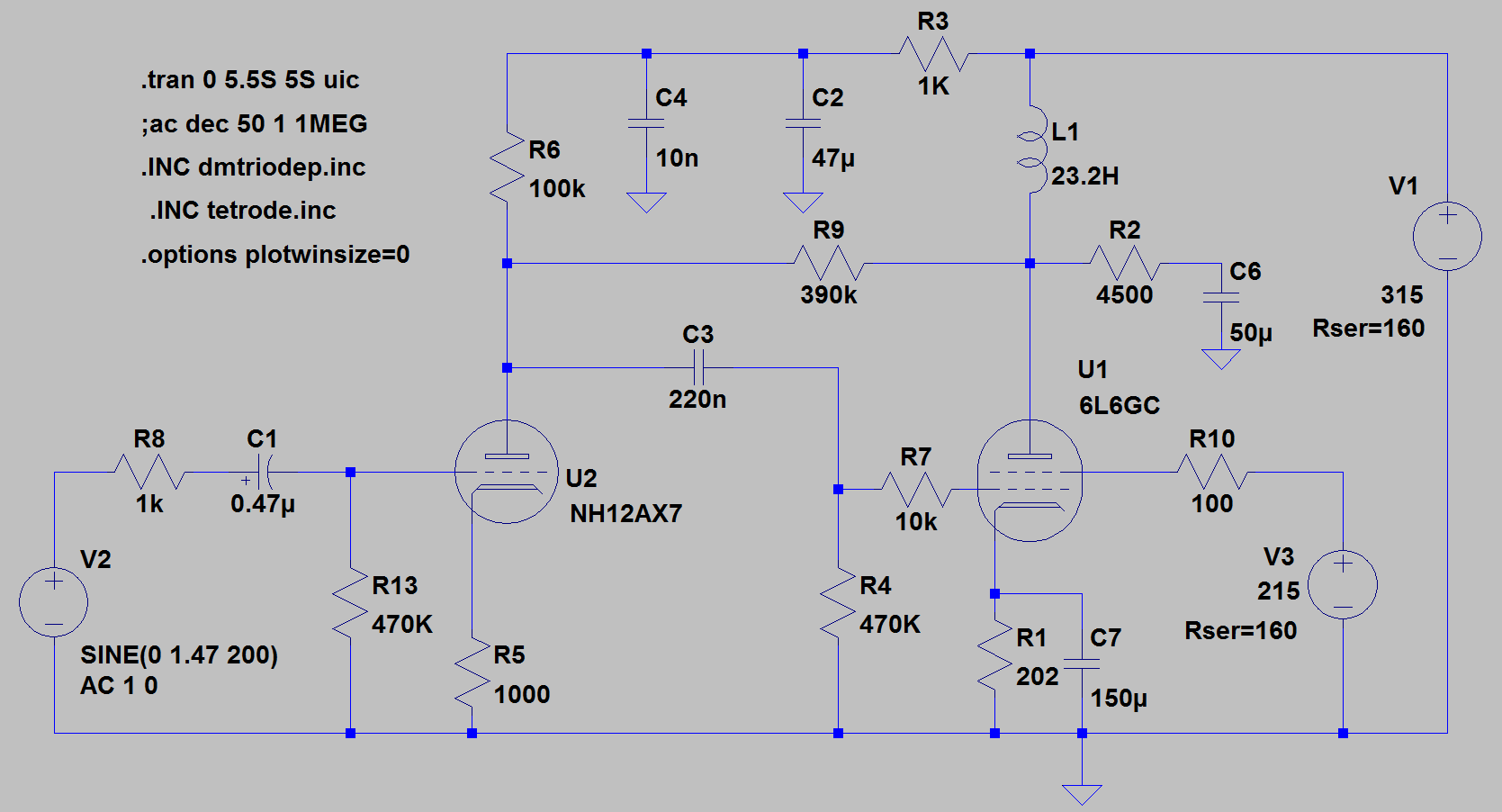

The 12AX7 appears to have a slightly lower noisefloor than the 12AT7. However what is more important is that while I experimented with different values for the "load" on the 6L6GC there are marked differences between the RCA (plate to driver's cathode) and the RH807 (plate to driver's plate).
The RH807 shows hardly any distortion (in plate voltage) when changing the plate load (driven at max power) while the RCA model is rather sensitive. This confirms that the plate to driver's cathode feedback is not as good a selection.
I hope this helps someone, for me the choice is clear: I'll be opting for the lower noisefloor of the 12AX7 (versus 12AT7) and the lower noisefloor of the RH807 (versus the RCA model). Am attaching the schematic.
Thanks :worship: to all for their suggestions and help.
