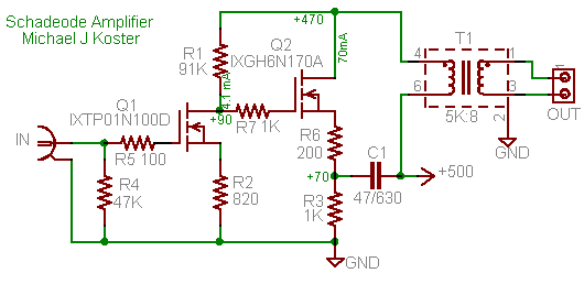

The reason for the 01N100 is mainly that it's my go-to depletion FET these days
datasheet shows it as n-ch enhancement 😕
The IXTP01N100D is a relatively new 1000V depletion mode device from IXYS. I abberviated the part number on the schematic to make things more legible...
It's an excellent part, very low capacitance Crss=5pf. Also has a higher Vth than the others which is nice sometimes.

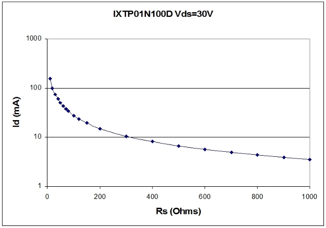

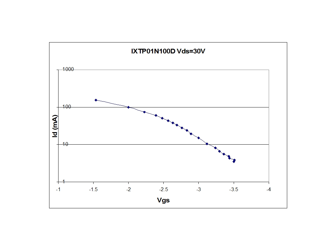

Since the datasheet has no curves, I measured one myself.

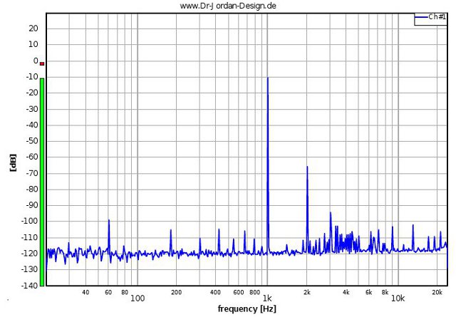

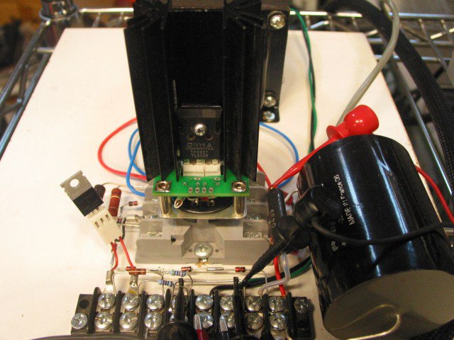

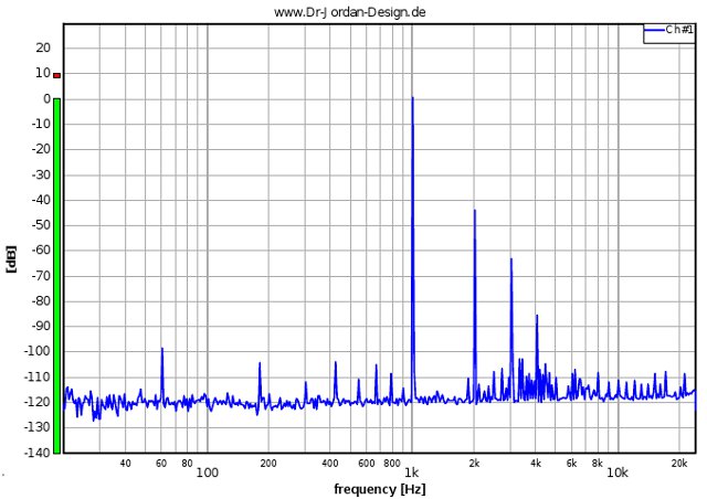

SS Schadeode, A Linear "Triode"
Something I've wondered about that I now have the opportunity to test. Using the same testbed, I mocked up a SS version of a 6L6 using a low capacitance 1700V IGBT (6pf Crss) and a 200 ohm resistor in the source to limit the gm to about 5000 (200 ohms Rp effective, just like the 6L6 Schadeode I tested earlier).
I built it onto an octal plug so I can swap back and forth with only a change in feedback resistor to compensate for higher gate voltage of the MOSFET + Rs vs. grid voltage of the 6L6.
The distortion spectra are amazingly similar, with the SS version producing a little more 4th harmonic above 1W and a little less 3rd harmonic between 5 watts and clipping. Power output at clipping is the same 9W at the speaker terminals.
They also sound amazingly similar; the SS circuit is also neutral to slightly SET-like on vocals but with the same tight bass control and low end punch as the tube Schadeode.
Oops, forgot to show the gate protection zener on the IXGH6N170A. I included it from the start as it's probably needed; I don't want to find out...
