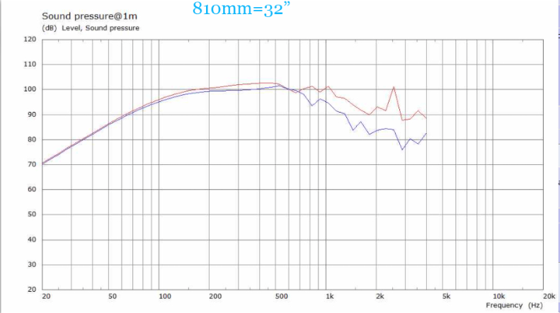

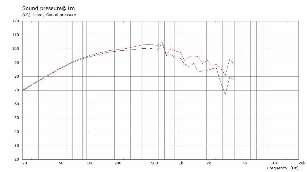

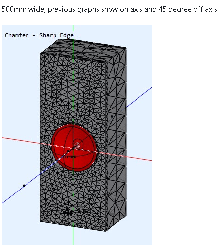

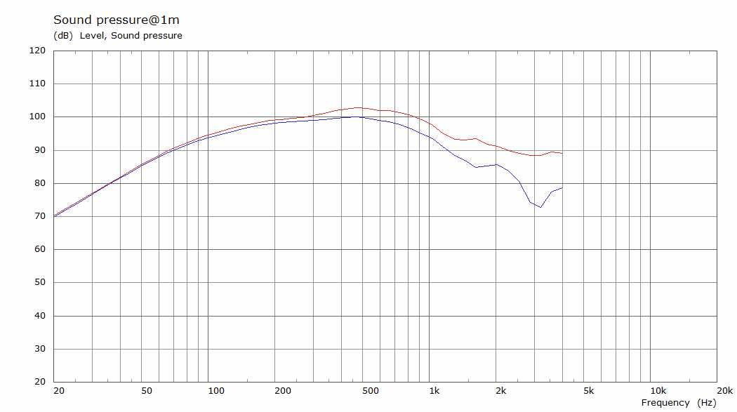

For the 3rd time, no it doesn't. You are speaking technically, not practically, at one point we did model my baffle and the difference between 90degree edges and a proper round over were miniscule. So the "must be" part is where I disagree.if it's wider the roundover must be big enough compared to wavelength = compared to baffle size
Remember that as the distance between sound sources increases (delay increases), the comb filtering at higher frequencies will begin to average out (but it IS still there). The problematic destructive interference will be lower in frequency. Low enough frequencies will simply not care about changing from half-space to full-space radiation. "100 Hz doesn't care about your baffle edge diffraction."
OK above is 500mm with and without proper edges
Below 810mm ~32" with 90 degree edges.
I see now what you guys are saying, if this sim is accurate, there are "issues" in the HF. I don't know to say about that peak at ~2.6khz. Not an issue for those designing towards directivity vs omni

Try a 2 meter baffleView attachment 1269959 View attachment 1269956 View attachment 1269957
