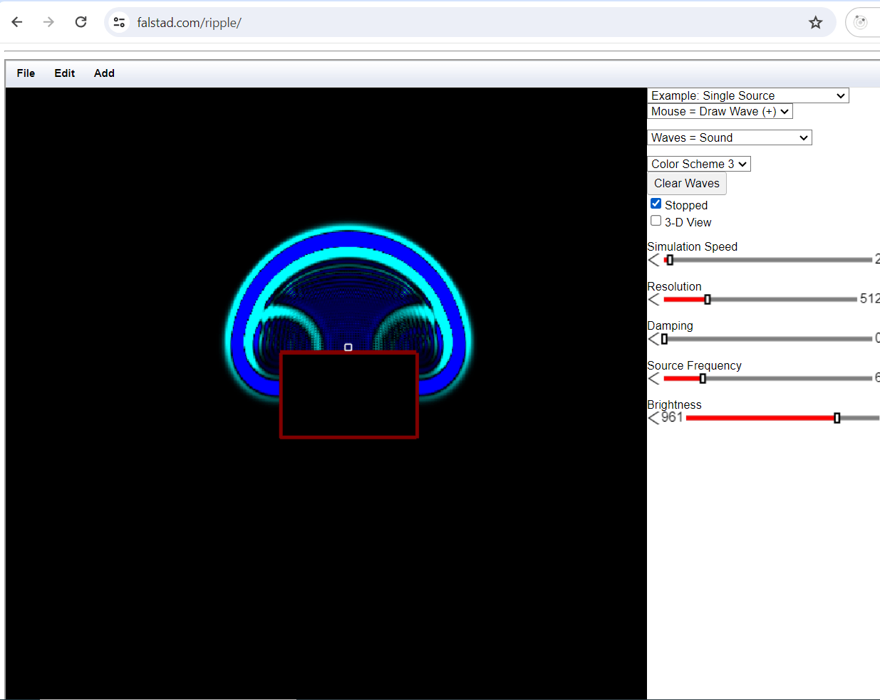

I think absolute dimensions do not matter at all. Only relation of transducer size to baffle size matters for the secondary sound source that forms at the edge. 25cm baffle would make problematic edge diffraction back wave for 10cm driver, but for 25cm driver it would be fine.
Absolute dimensions would affect interaction with room, which is independent of edge diffraction problem, because one can have any sized baffle with more or less edge diffraction making secondary sound source. Absolute size will also make audible difference, but is different issue altogether. Absolute dimensions matter overall directivity of a speaker, but also at which frequency bandwidth any diffraction back wave happens which might make it more or less audible, but "amount of diffraction problem" does not depend on absolute dimensions, only relative dimensions.
If baffle is much bigger than transducers, then it could be problematic sounding. When baffle is no bigger than transducers it makes very little problematic secondary sound source, because the sound that emits at the edge is almost the same as the driver sound, only few centimeters late and in midband basically no different than sound emitting from the cone itself. Response narrows due to secondary sound source even with minimal baffle, but this can be utilized to help with overall directivity unlike the ripple that happens if baffle is much bigger than transducer. Baffle could be 50cm, if transducers / waveguides are ~50cm as well, and thats minimal baffle in terms of edge diffraction secondary sound source, as minimal as 25cm baffle with 25cm sound soures, or 10cm wide with 10cm sources on it.
Diffraction is sound going around an object, which is not a problem here as the sound heads away from listening window (through room reflections it might, this is the other problem). Problem with edge diffraction is the backwave that emits at the edge towards listening window right after direct sound. This is basically low passed sound and has location, delay and dimensions and polarity different from the direct sound. The edge becomes additional sound source whose frequency response and delay is different than sound of the drivers, to any direction, but especially issue within listening window.
If this is hard to imagine, try ripple tank, adjust size of the obstacle relative to wavelength, or vise versa, and see what the backwave that emits looks like. Try line source instead of point source and so on. It is good tool to get intuition through visuals.

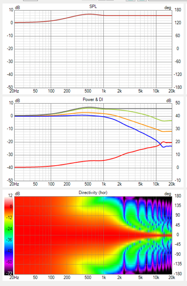

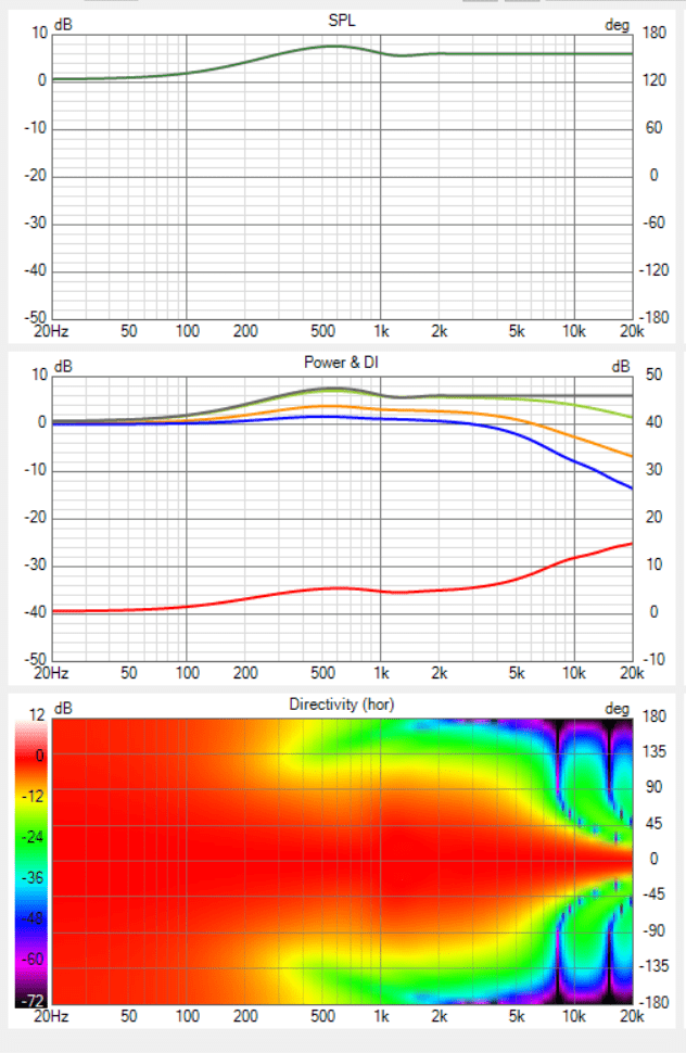

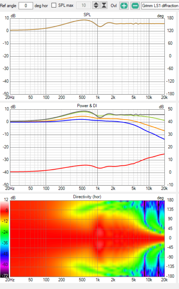

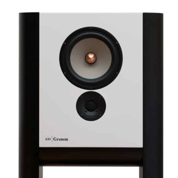

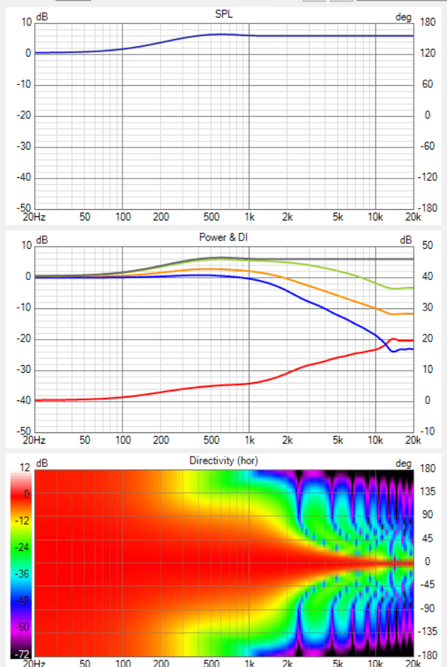

never heard it playing, but if you want to analyze it's diffraction performance it's possible. Found dimensions that it's 520mm wide, and looks to be about that in height as well, and now one can approximate what the round overs do and what the size does. I'll questimate it is 8" woofer and here is example using ideal transducers, using 50mm diameter for tweeter as it seems to have some waveguide to it. Also quessing 100mm radius for the roundover. Lots of guessing, but this example is to look some relative differences so doesn't matter too much.

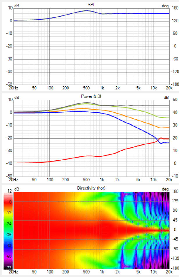

This is ideal woofer like in LS1 without any crossover, left image is with the edge roundover and the second without to demonstrate how much the roundover helps, and what the diretivity is due to big baffle.

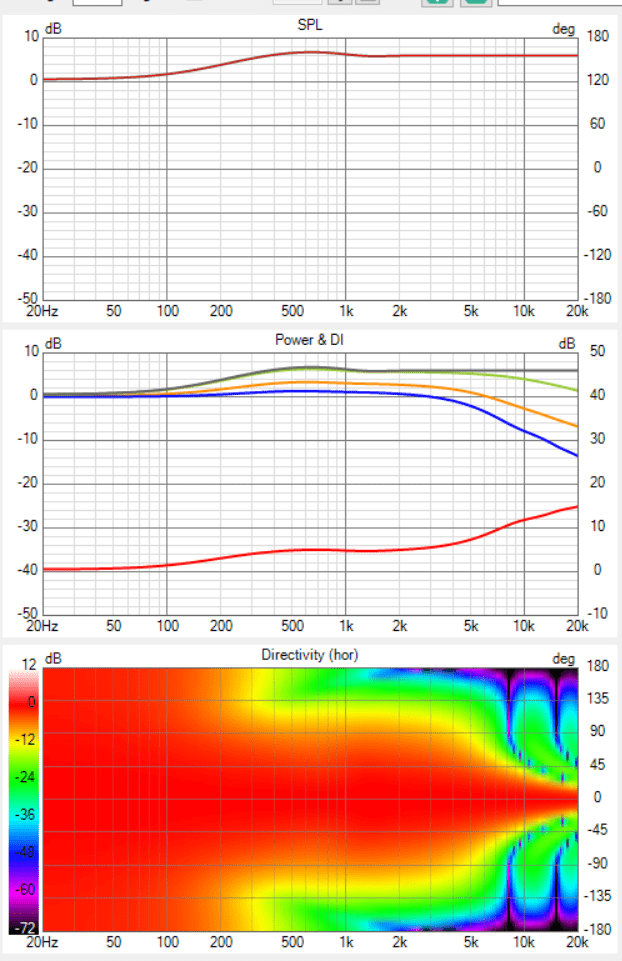

Same for tweeter, without and with roundover.
Obviously the baffle is made wide to increase directivity well below 1kHz and roundovers are to help with the edge diffraction, especially for the tweeter. What roundovers do they remove the edge for short wavelengths keeping the bulk the same for low wavelengths.
If the radius was even bigger, there would be even less secondary sound from the edge. (this would mean the box would be deeper which would again change things. Depth is not included in these simple diffractions sims, only front edge).
ps. it takes longer to compose a post like this than roll lots of simulations with the VituixCAD diffraction tool using ideal transducer and baffle. It really is great tool to get intuition with this stuff, as it's real time allowing very quick tests that help reasoning. I recommend everyone to play with it when ever there is unknowns regarding this stuff. Being simplified and ideal it shows the underlying phenomenon without all the details of reality blurring the big picture 🙂

The sim shows that first baffle step dips start at 1kHz for such a wide baffle. If you care about these you need LARGE roundovers. There are also ripples at higher frequencies - you can do smaller roundovers for these.

by not loading any driver data 🙂 in diffraction tool just input baffle and driver size and hit "new" and thats it. If you want to look at full polars, then you need to "measure", iow check "feed driver" and hit export. This will send data to driver that is selected in the main progam, and you can now inspect the sixpack, impulse response and so on.How do you generate an ideal driver in VituixCAD?
It is usefull to think the diffraction tool similar to your real measurement setup, the data it generates is similar to what you'd get if you follow vituixcad measurement instructions. I say similar, because the diffraction model is relatively simple, and it's all virtual so no need for gating or nearfield measurments or anything like semianechoic real measurements would need. It's similar in a way, that you'd use both diffraction sim data and real measured data similarly in the main program. Sims are nice for playing around.

There are two "woofer" versions of LS1: one with a Seas 8 inch Excel woofer, which is said to work "pistonic" up to the crossover frequency, and a cheaper one with a (when I am right) carbon fibre woofer which will not work pistonic but will break up before crossover. How to model that??
