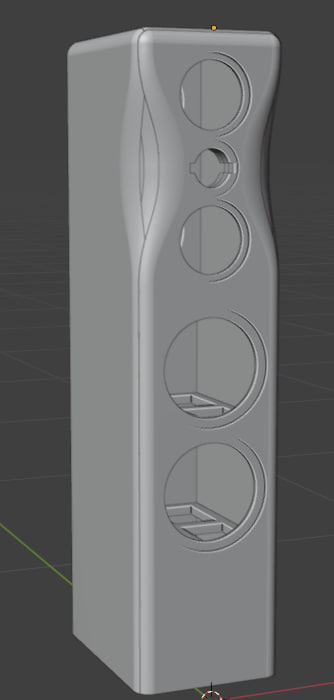

I think there is an underlying theme here. By placing the edge very similar to the drivers width, you have approximately no edge diffraction to deal with.I think absolute dimensions do not matter at all. Only relation of transducer size to baffle size matters for the secondary sound source that forms at the edge. 25cm baffle would make problematic edge diffraction back wave for 10cm driver, but for 25cm driver it would be fine.
This easily understood. I think that with a large enough baffle you also cause diffraction to not be a major issue.If baffle is much bigger than transducers, then it could be problematic sounding. When baffle is no bigger than transducers it makes very little problematic secondary sound source, because the sound that emits at the edge is almost the same as the driver sound, only few centimeters late and in midband basically no different than sound emitting from the cone itself.

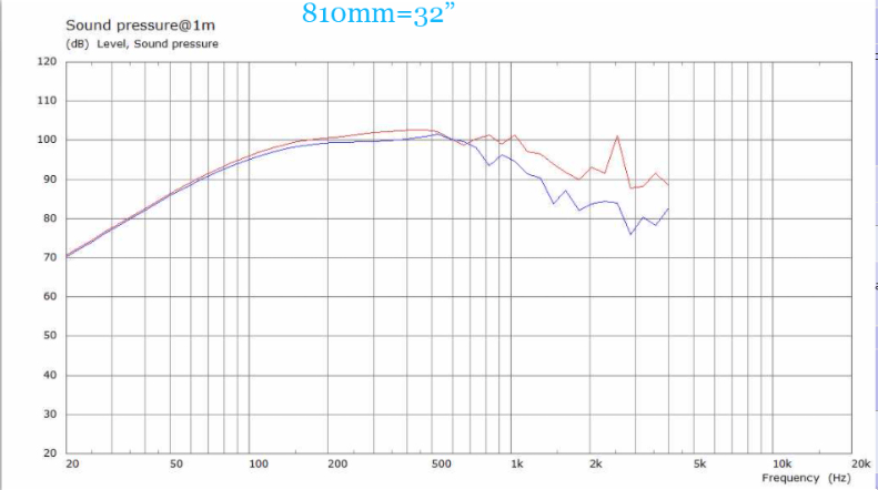

Remember that as the distance between sound sources increases (delay increases), the comb filtering at higher frequencies will begin to average out (but it IS still there). The problematic destructive interference will be lower in frequency. Low enough frequencies will simply not care about changing from half-space to full-space radiation. "100 Hz doesn't care about your baffle edge diffraction."
So what width would be enough and enough for what situation if aiming for wide baffle. When will there not be any driver induced directivity at 2khz? Approximately 6.5" is what I see. A crossband containing 2khz is definitely possible with a 1" tweeter. I believe that less work is needed to treat the edge when the dimension is large enough. The lesser deviation caused by edges at large dimension suggest that lesser technically perfect treatment needs to be implemented in order to achieve desired effect. Since ~423hz doesn't care much about the 90 degrees angle, a round over that satisfied the 2khz area would be plenty as the strongest note exist at whole wavelength not its harmonics. So if a certain roll over satisfies diffraction at a ~6.7" baffle, it would be over kill with the 32" baffle.
Less than a >1" is needed for a proper rollover of a baffle of ~6.7" wide, to deal with ~2khz so a baffle of 32" should be fine with the same. Thats my thought at least, I cannot simulate this to test the theory.
