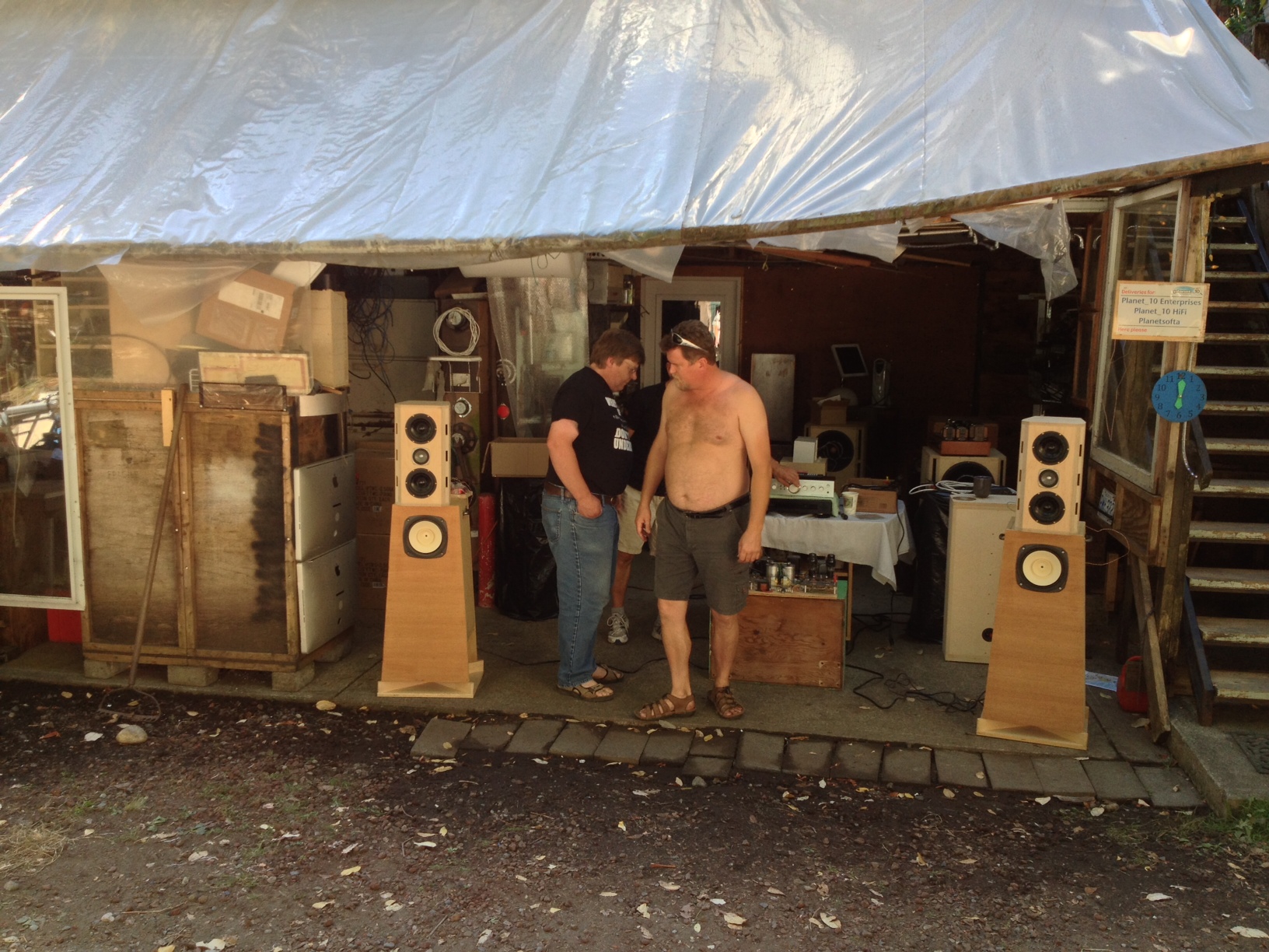

two 5.5" in MTM … because of the soundstage that is less good
These imaged VERY well.
The participants bar eDaveR master series XO guy, and Cal (my ex banned the no-shirts for later diyFESTs).
dave
