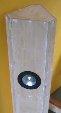

The triangles in question ... The speaker on the left is a JX53/125 system, a 33 litre sealed bass enclosure and a 3 litre sealed enclosure for the 53. GM's MLTL design goes deeper and is actually less resonant on male vocals - either because of the tuning or due to the triangular cross-section of the cabinet.
As you can see, the triangular cabs are not finished yet - I put them in place to test them and haven't wanted to dismantle them since.
Someone is bound to ask, so ... the JX92 is slightly more brash-sounding than the JX53 system but somehow seems more organic. It's not something I mind because the end result is so enjoyable. The stereo image is much deeper. The JX53 has a little more air and delicacy in the HF.
GM's design seems to bring out the best in the JX92s and the system is one of the most enjoyable I've heard. There are a couple of electrostatics I could live with as replacements but that's about it.
Another pic, showing the shape a little better.
The walls are 1" thick so the internal shape is triangular, even though externally they are six-sided. I thought this would make them easier to construct but if anything it may have made them trickier. The next version will be three-sided with the corners rounded and I'll get access to a proper workbench to assemble them on. (I do woodwork to build speakers, not the other way round. All constructional suggestions welcome.)
Incidentally, the walls show very little vibration but there is some in the top panel, which I guess fits with the column resonance aspect of the design. The enclosures are braced just below the driver (you can see the screw hole filler) and the entire top section lightly filled with BAF wadding. I seem to have been lucky in that I've not felt the need to adjust the filling. I may reduce it to see what happens.

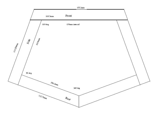

I like the hexagonal shape Colin - an elegant solution. I made mine pentagonal with internal side dimensions of rear panels 106mm, sides 102mm and front 130mm. Angles are 110 (2), 90 (2) and 140. I did an Excel spreadsheet to calculate the internal and external face dimensions of the panels.The angled cuts all come off a table saw set at 20 degrees from the vertical, so once it's set and checked you don't need to keep altering it. The side and rear panels are produced from a larger piece by a single cut.
The narrowness of the panels cuts down resonances, but I think I may put in a couple of bracing rods from front to back. The narrow front makes for great imaging.
I'm attaching a sectional plan. In the event I added corner bracing in the angles which meant the dimensions had to be changed a bit to keep GM's cross sectional area. I have the final plan on another computer which I can't get at for a while.
I used 18mm MDF. Assembly was trial and error, but I've learned enough from it to do it properly next time out of a better material. I've been promised some iroko (teak) recycled from old school laboratory workbenches and planed to 20mm. It will be interesting to hear how it sounds, as it's much denser than ply or MDF. Anyone have experience of using it or similar?
