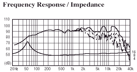

There are actually a few issues related with this.
First is the the dynamic range. Do not get this mixed up with sensitivity as normally shown in the specs. If the driver does not have good resolution, then you will tend to turn up the volume to hear the details, what this will cause is you quickly hit the power limits of the driver making the music sound loud but compressed. If the driver has good resolution, then you will not need to turn the volume up so much. In a full orchestra, each instrument is at a lower level. So when you start to turn up the volume, you start reaching the dynamic range limit.
Second is the driver characteristics. If you look at the Foxtex curves. Notice that the impedance curve is not so smooth, and the FR also has some peaks and valleys. The things they don't show is phase of the FR or phase of impedance. Non-smoothness in the impedance curves and FR curves concurrently with the impedance curves will reveal cone resonances and phase shifts. In simple musical instruments, phase will make the instrument sound somewhat different, but not so bad. If you have complicated instruments playing together, the ear can no longer distiguish the individual instruments, and the total music will soound a bit noisy and compressed.

If you look at the F120A, what do you see regarding effeciency, cone material, power rating, Xmax.
Then look at the impedance plots and post what you think of those.
There are lots of information behind words of recommendations, and lots of assumptions as well. If you find someone with similar tastes as yours, then take their recommendations, otherwise it is best to learn more detail.

If unsmoothed impedance curves look smooth, generally this means the cone vibration modes are quite tamed. However, signal resolution is not part of standard released test data, so the only way to compare is to listen to two similarly designed systems at the same SPL you normally expect to listen, and compare.
Most people will not provide head on comparisons amond competing products because of conflict in interest. So you will just have to find out for yourself.
I think if you just like a pleasing sound and are budget limited, The FR125S, W3-871S, etc. probably all have good sounds. If you want more detail, the Jordans are probably your best bet.

With conventional drivers, such cone characteristic shows up in impedance plots if the data is not smoothed. Also with conventional cones, if the material is not hard enough, there will be loss of resolution. So in technical terms, how fast is fast enough for the Mangers? I think most certainly commercial amps could go way beyond 50K 😕
