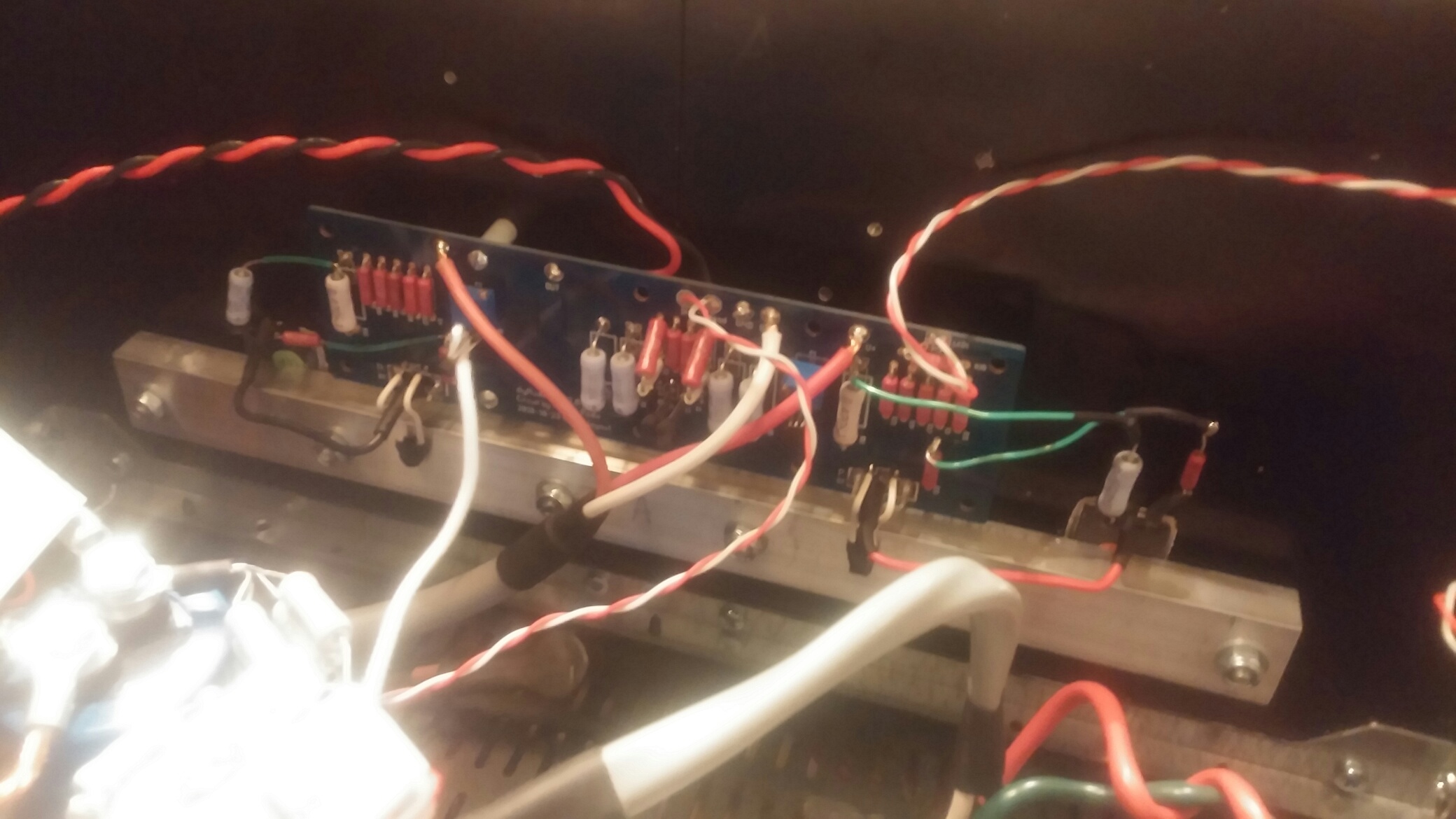

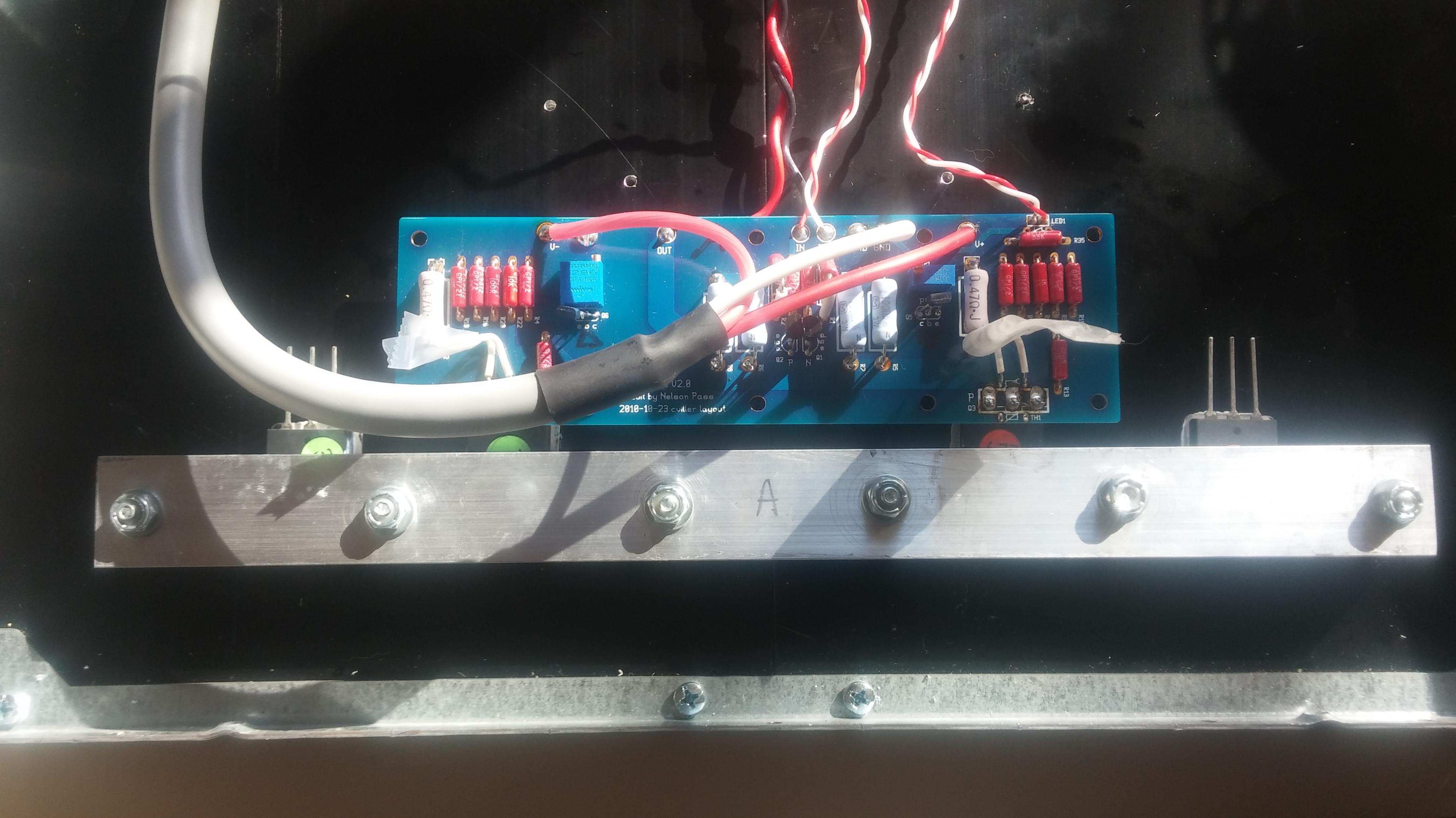

OK, stupid question:
I have one channel up and running at .5V across the .47R source resistor.
Is this 1A bias (.5/.47) or is it 2A bias becasue I have doubled up the mosfets (I am using 2 pairs)? I understand the bias calculation (voltage across source R / source R) but when using 2 pairs do you multiply that by 2 to get bias?
With .5V across .47R I can hold my hand on the heatsink forever. I am using the 5U case.
Easily done.Thank you. Hoping to get to 2.5A for all class A down to 4ohms.

Andrew. there is no need for that. each device will have a lower dissipation then the original F5.
2.5A/2=1.25A pr device VS 1.3A for a standard single output pair F5
The check for Max:quiescent dissipation should not be omitted.
You have done a comparison based on a design where the check has already been carried out.
exactly my point. the test has already been carried out.
same rail voltage, just about the same current pr device. so what has changed?
there is ~30W dissipation pr device.

I'll keep an eye on the temp and make sure the bias stays stable. But .5v across the source resistors was not very hot. That's 2A bias. I can't imagine it's close to the limits. And 2A with 4 pairs is less dissipation per device than a stock F5. 2.5A is the same dissipation per device as a stock f5 and as long as the heatsink temps stay low enough I should be good. I wonder if the 1/2" aluminum bar stock I am using to "clamp" the mosfets down is helping to dissipate the heat? I know I have more even pressure this way.
Don't worry. I've only had two amplifiers catch on fire, I'll do my best to not let it happen again.
No it's the fact that the 5U case can easily dissipate 140W per channel without issue.I wonder if the 1/2" aluminum bar stock I am using to "clamp" the mosfets down is helping to dissipate the heat? I know I have more even pressure this way.
