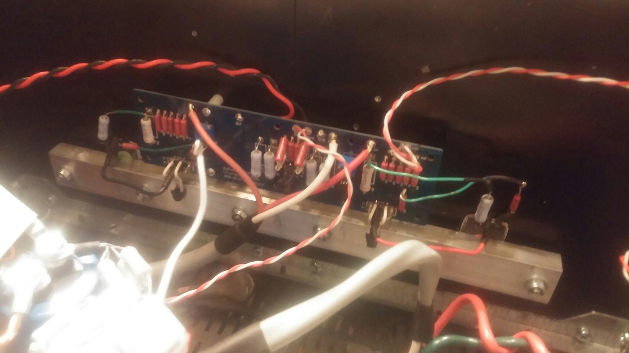

I'll keep an eye on the temp and make sure the bias stays stable. But .5v across the source resistors was not very hot. That's 2A bias. I can't imagine it's close to the limits. And 2A with 4 pairs is less dissipation per device than a stock F5. 2.5A is the same dissipation per device as a stock f5 and as long as the heatsink temps stay low enough I should be good. I wonder if the 1/2" aluminum bar stock I am using to "clamp" the mosfets down is helping to dissipate the heat? I know I have more even pressure this way.

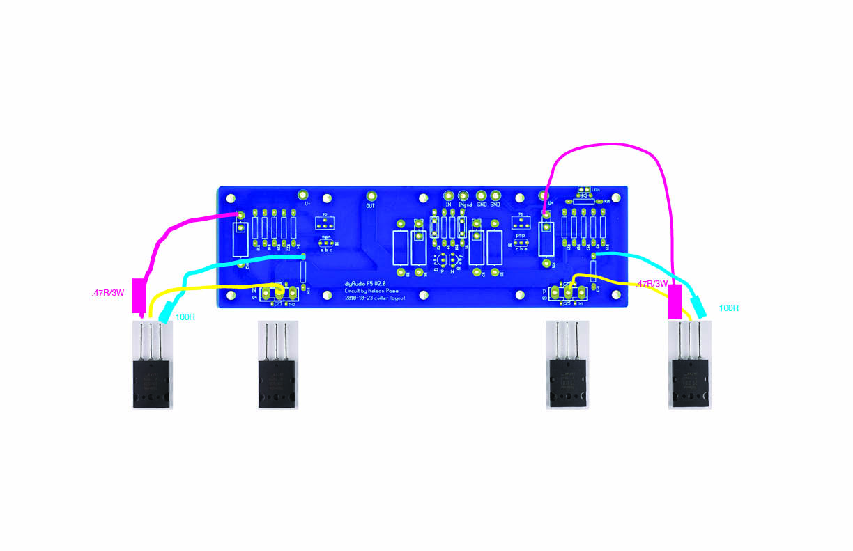

Well, the other channel didn't go so well. I can get bias across the source resistors but dc offset stays at 0 regardless of pot setting. In fact, I can get negative (!) voltage across the source resistors when turning p1, dc offset remains at 0. Mosfets not getting warm even with .5V across the source resistors.
Any ideas what's going on? Other channel works fine.
post schematic with measured values on it
It looks like this...
0.5V across a 0.47 ohm resistor means there is ~1A current through it. Whether it is going through the MOSFET or not is a different matter, though I can't see where it would go unless you had a gross wiring error, like swapped MOSFET polarity. Are the feedback resistors getting warm? Does moving the pot affect the bias?
Moving the pot effects bias but not DC offset. Both pots effect bias but DC offset is always zero. I'll double check everything again later tonight. Source resistors not warm. I didn't check the feedback resistors.
Guess I should check my multimeters too....maybe it's the leads or something.
