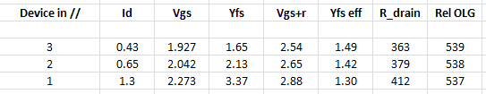

Let’s use the F5 circuit as an example and make some further assumptions :
a) first stage bias = 7mA
b) 2nd stage bias 1.3A
c) Source resistor for second stage 0.47R
d) When using n MOSFETs in parallel, each MOSFET has its own source resistor = ( n x 0.47R )
Using actual curve traced values from a 2SK1530 (as an example), the following values are obtained (see attached PNG file).
The drain current is (1.3A / n), where n is the no . of devices in parallel.
Vgs is the corresponding value for the MOSFET itself, i.e. at (1.3A / n).
Yfs is the transconductance at (1.3A / n).
Vgs+r is the Vgs voltage plus the voltage drop across the source resistors, the latter being (1.3A*0.47R =) 0.61V.
Yfs eff is the total transconductance of all parallel MOSFETs including source resistors degeneration.
R_drain is the resistor value to give Vgs+r at 7mA bias.
Rel OLG = R-drain x Yfs eff is an indictor to compare changes in open loop gain.
With the aforementioned assumptions, it does not appear to be beneficial to go for parallel devices.
That is already ignoring the corresponding increase in capacitances.
Patrick

Hi Patrick,
With parallel devices the effective source resistance drops, for 1.3A total for example the drop is only 0.188V when three pairs are involved as the current is shared between three pairs (the effective current is 430mA as per your image, so with the same source resistor value the drop would be less).
What happens when you account for this?

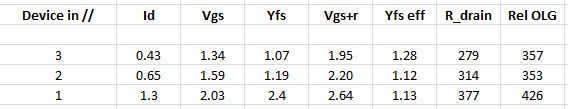

You are showing transconductance as proportional to bias current, but I seem
to recall that the relationship is a square root of bias current.
:cool:
You are right.
There was a small bug in the derivation of Vgs & Yfs from curve traced data.
This is now corrected and double checked against measurements.
If you just consider paralleled Yfs, there is some gain in going parallel.
If you take R-source and R-drain into account, then they are pretty even.
And you get lower junction temperature, but pay the price with capacitances.
Patrick

Nope, the voltage drop for 470mOhm resistors is about 188mV when the bias current per pair is 430mA. Ohm's law. You're not accounting for that either.
I agree about capacitance though, it is a price. Not sure how a little cascode jfet can discharge few nF of gate capacitance. However seeing Nelson's commercial amps routinely paralleled 10 pairs, there's obviously another side to this story.
Maybe I did not explain myself well enough in the original post or we have a language barrier.
I said that one of the assumptions was :
"d) When using n MOSFETs in parallel, each MOSFET has its own source resistor = ( n x 0.47R ) "
So in case of 433mA, n = 3, and R_source = 1.41R.
I consider this to be a fairer comparison than using R_source = 0.47 for n = 3.
Because then I can also argue that I can use R_source = 0.15 for a single device.
0.47R is not a holly number, but just a design parameter.
I have use anything from 0.1R to 1R, depending on the application.
In the F5X for example, R_source is 0.22R.
