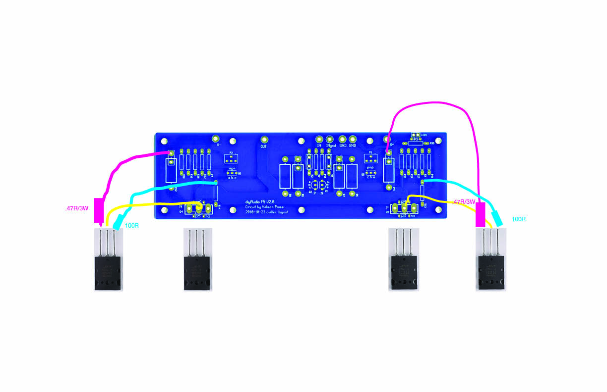

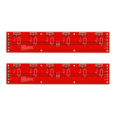

It looks like the Burning Amp Complementary output stage boards from the store would be a convenient way to experiment with adding pairs...since they have mosfets, source and gate resistors on them and nothing else. Just hook this board up the the F5 board sans mosfets and bias.
F5 is common drain

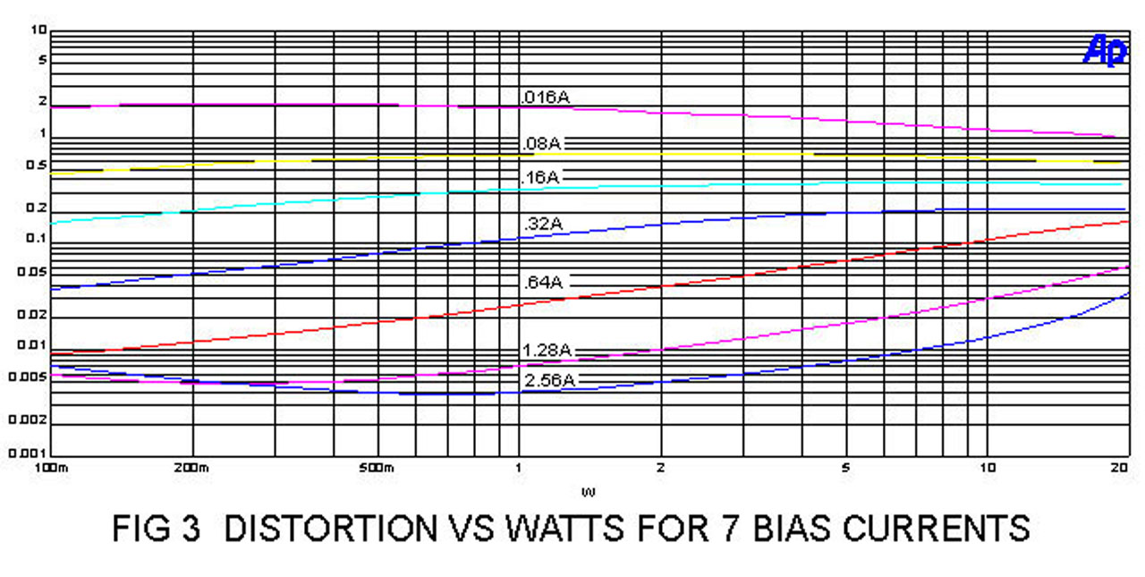

Although I haven't compared the single pair version vs. multiple pair version at same overall bias yet I am thinking that a lot of the "more relaxed, more powerful, smoother" reaction to the multiple pair versions of the F5 come from more bias. It's not really fair to compare a single pair F5 biased at 1.3A to a multiple pair F5 biased at 2.5A and say the differences are because of the addition of mosfets...
I was more interested in understanding the differences between single and multiple pair at same bias, which you guys have explained well.
But I guess that's the point...more pairs usually equals more bias.
My single pair F5 is biased at 1.8A now...I wonder how much more bias I could get out of it w/multiple pairs. The heat being more evenly distributed over multiple mosfets might let me reach 2.5A...if not, and I can only get to say 1.9A then I have increased the number of mosfets (and added the potential downsides you guys have mentioned) for little to no increase in bias.
