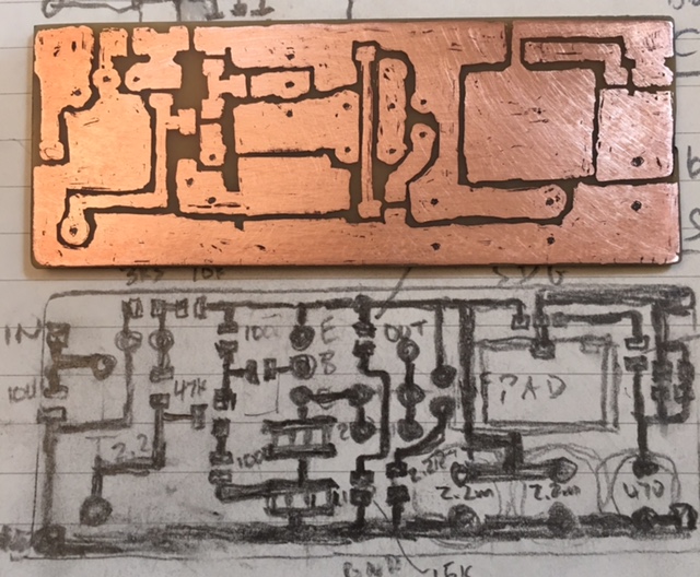

Here is my PCB layout (note I have an error on pinout of BD140 and had to cross legs 2&3 in practice. Otherwise, layout works well and has excellent amount of PCB area to dissipate heat from power resistors and cap Mx.

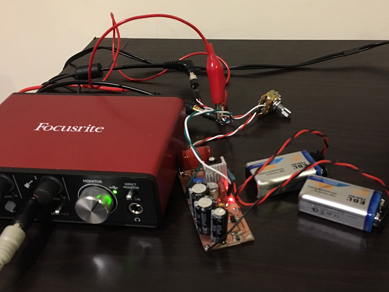

I know you have been waiting for this one... I hooked up the amp to the Focusrite Solo Gen2 audio interface and took some data. Initially with the SMPS and DC-DC converter. When using the DC-DC converter, too many HF artifacts showed up in the FFT so I removed it and connected a pair of fresh Li-ion 9v batteries (measure 16.0v) after the cap multiplier. The HF components were fairly low in the -100dB to -110dB range but I wanted to give this amp a fair test.

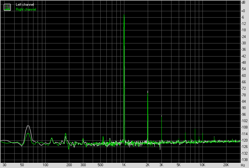

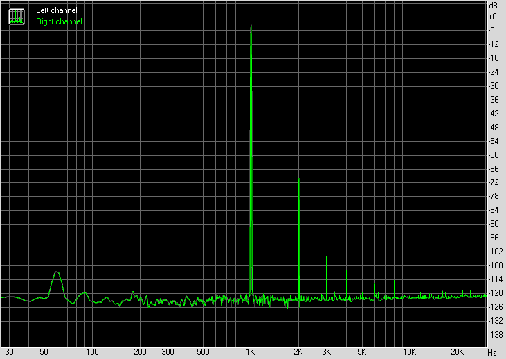

Here is a typical FFT with the DC-DC converter and 12v SMPS as power source:
So with batteries, I took data with R6 set from 0ohms to 100ohms in 25ohm steps. The trend is that at lower degeneration resistance values, the THD is lower, and increases pretty much linearly with increasing resistance. Note that there is a 60Hz peak but that is probably EMI pickup due to fact that amp is not in a metal box as everything is battery powered. The -120dB noise floor is quite flat otherwise.

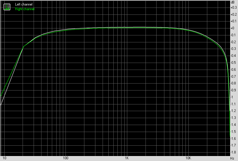

Here is a typical frequency response plot (multi-tone and not swept), you can see that this amp measures exceedingly well with a -0.5dB point of about 17Hz and upper limit is really just the sampling rate (set at 96kHz and 24bit):
So we can see the trend of the H2 and H3 increasing with R6. The stated THD was as follows:
R6=0ohms, THD=0.033%
R6=25ohms, THD=0.046%
R6=50ohms, THD=0.068%
R6-75ohms, THD=0.101%
R6=100ohms, THD=0.123%

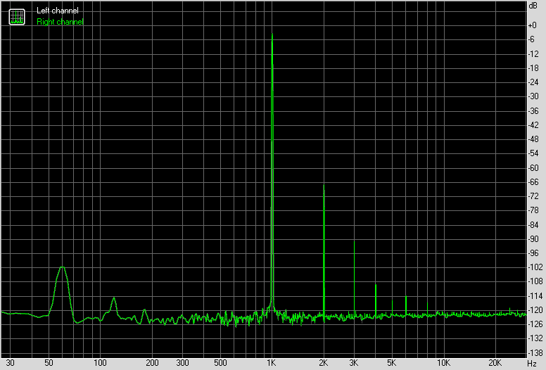

FFT with 10w trafo and CRC
I was curious what the noise performance would look like with a traditional mains connected trafo and CRC prior to the cap Mx. I am using an Antek 0115 10w 15vac toroidal trafo with 20mF//0.33R//20mF CRC. The voltage after the cap Mx is 16.4vdc. There appears to be about a +6dB increase in the 60Hz peak which is now at -102dB - still very reasonable and inaudible as far as I can tell. This is at the midpoint 50ohms Niceness setting.

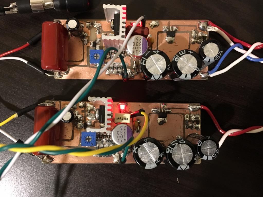

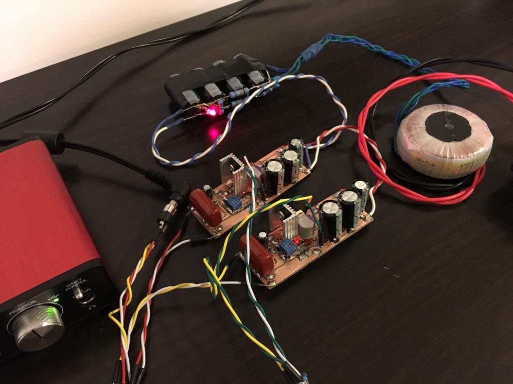

JFET-BJT Headamp in Stereo
I built up the second channel and it fired right up no issues. Measurements of HD spectra at 0 ohms, 50ohms, and 100 ohms look consistent between left (new one) and right channels and behave similarly to earlier measurements. Now I can listen in true stereo and the sound is very nice. Will give detailed impressions later - it's real late now and need to get some rest...
Setup with trafo and CRC PSU. I am sharing the PSU for this initial test but will make dedicated second CRC for a true monoblock in the future:
Closeup of the two boards:

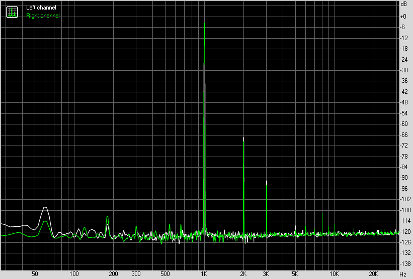

FFT at 1kHz and 700mV output into 270ohms (96kHz 24bit DAQ) w/ R6=0 ohms:
FFT at R6 = 50ohms:
FFT at R6 = 100ohms:
Frequency Response (multi-tone) at R6 = 50ohms:
Measured THD was 0.027% at R6=0ohms, 0.057% at R6=50ohms, and 0.099% at R6=100ohms.

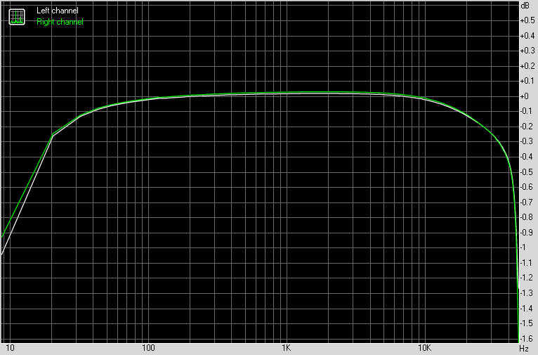

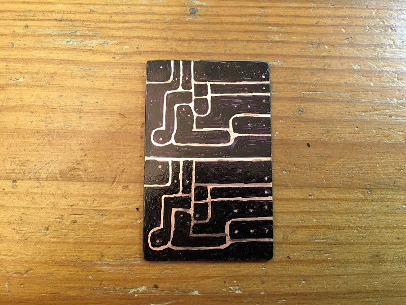

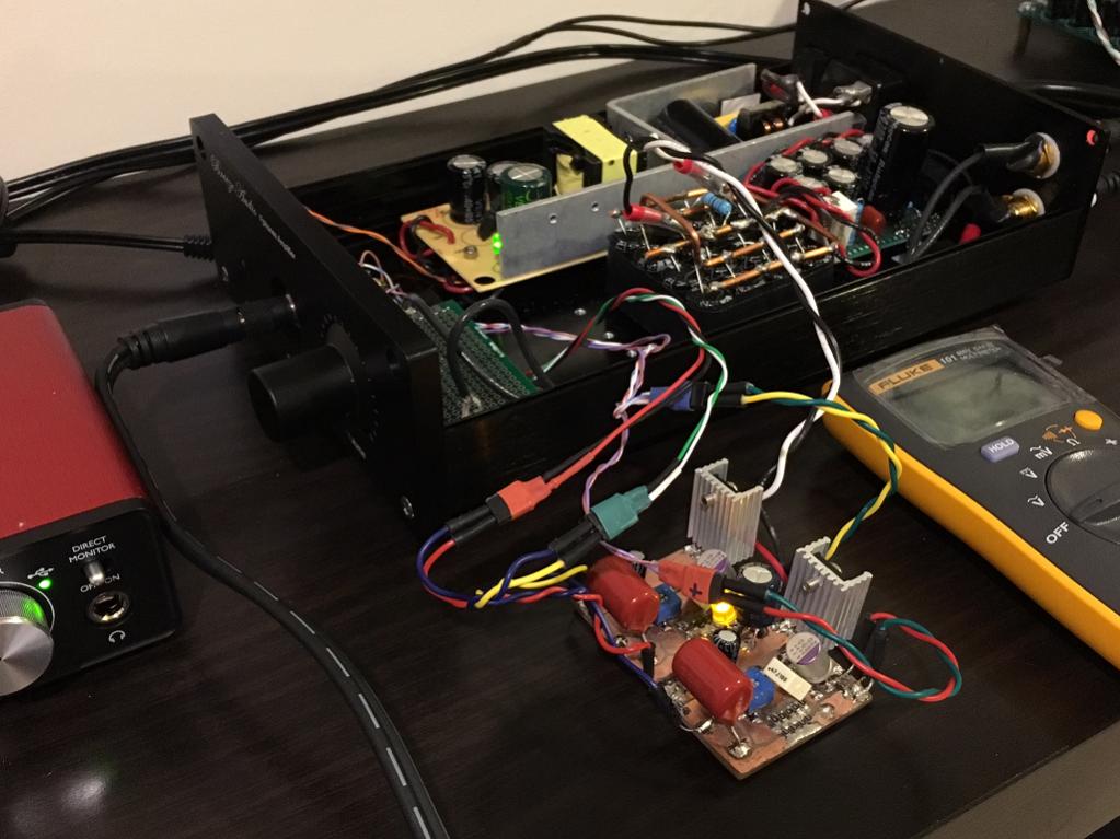

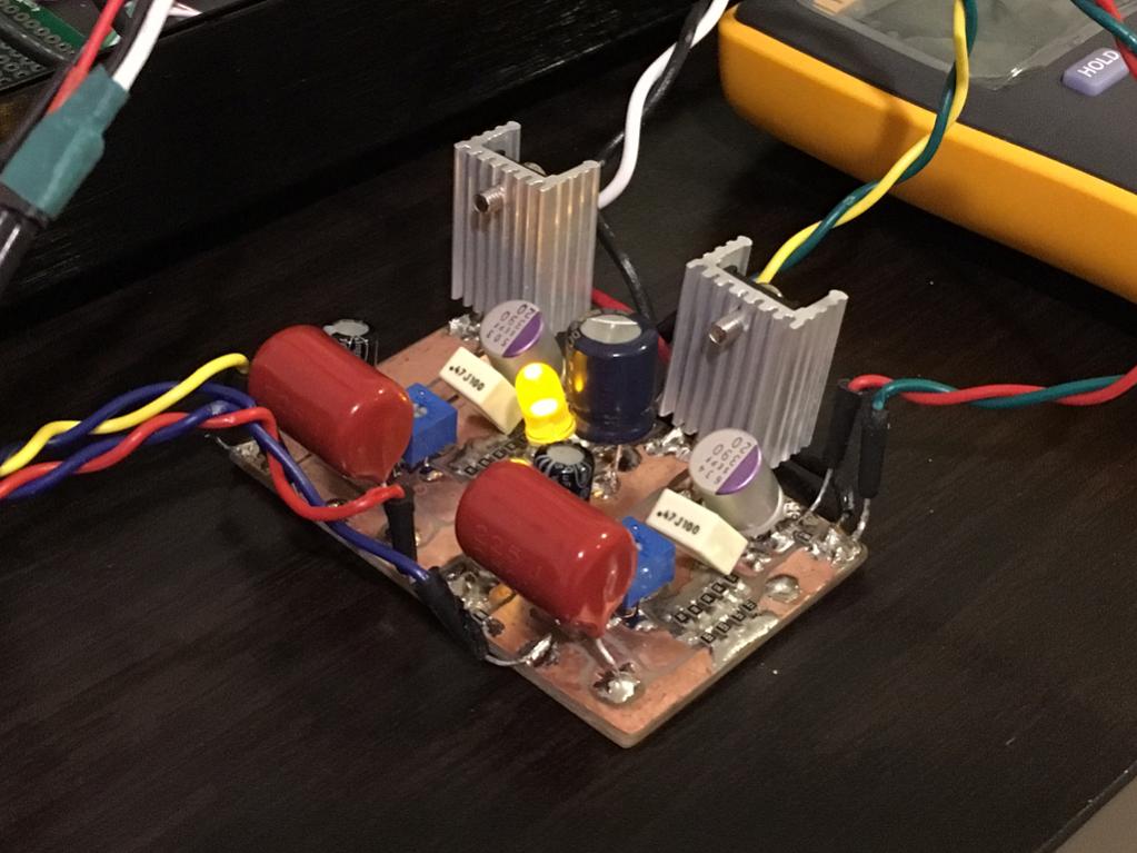

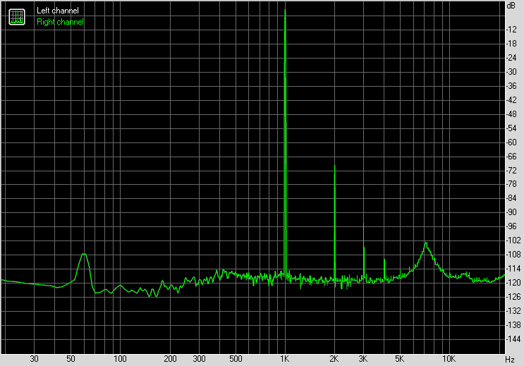

BF862-2SA1837 Headamp
Aksa helped me to adjust the circuit for a desktop high-bias version of the JFET-BJT using the venerable Toshiba 2SA1837 BJT driver. The bias current is set at 135mA with a 20.0v power supply provided by a 24v SMPS and a Juma cap Mx (IRFP240 based), followed by a low ESR 24mF cap array.
Here is the PCB layout as drawn using a Sharpie marker just before the acid etch:
Here is a closeup of the amp as built using SMT components where possible. I have 2.2uF 250v MKT input coupling caps, 390uF 20v Panasonic OSCON output coupling caps with 0.47uF 100v MKP bypass caps. The Niceness trimmer is set at 68R:

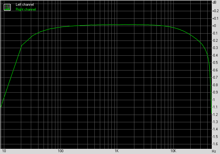

Here is the setup with the power supply consisting of 5amp 24v SMPS, cap Mx, and cap array:

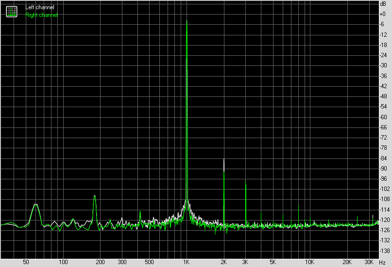

With the above setup, I measured the following harmonic distortion profile for 1kHz excitation and 700mV output into 270R load. The stated THD was 0.0037% - a very nice low figure resulting from a superior output stage BJT and a nice hot running bias current. Some switch mode noise is still managing to leak through but it's down pretty low at -90dB to -100dB. However, the measured H2 component is -90dB (lower than predicted!) and the H3 is -12dB less than H2 and the rest is down in the weeds. This is an excellent result for such a simple amp and the profile is very nice:
Here is the measured (multi-tone) frequency response:

Thanks for the feedback. It's quite impressive given that the source material is MP3 (not flac) playing through a DAC and then amplified by the DUT then recorded with ADC and presented back to the listener as MP3. This is using a fairly inexpensive audio interface (Focusrite Solo 2G) at 48kHz and 24bits.
Had the source started as lossless FLAC and everything played and recorded at 192kHz and 24bit in FLAC, it would probably sound even better.
