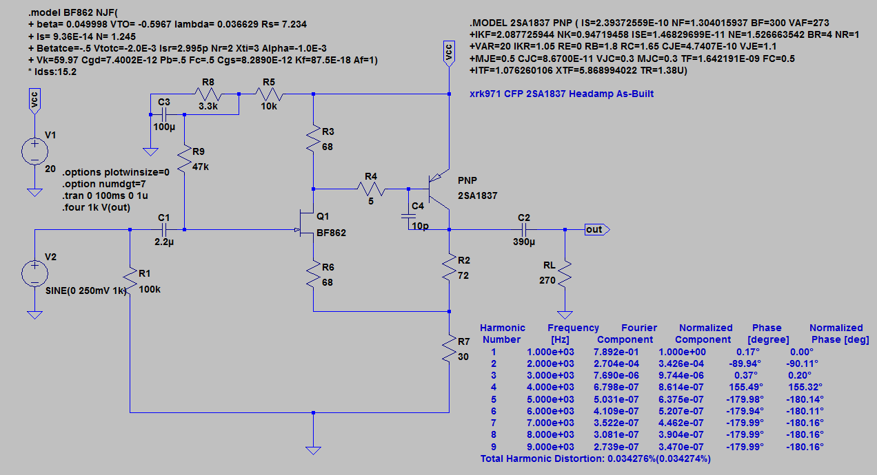

xrk,
Can you post the schematic with the desktop version as built?
I have few queries regarding the components. May be you have answered some of them earlier in the thread.
1. R8 (220) and R9 (100) when passing 135mA will dissipate lot of heat. I see for 220 ohms, dissipation is around 4W? Is this correct or the value of these are different in the built circuit?
2. The coupling capacitor value of 47uF and Rload of 250 ohms is good for enough for headphones with 50 ohm impedance?

Are you referring to the BF862-BD140 amp or the BF862-2SA1837 desktop amp?
Hello xrk,
I was referring to BF862-2SA1837 desktop amp. I was looking at the schematic posted for BF862-BD140 and assumed you swapped BD140 to 1837 but was not sure if other components were shifted.
Hello xrk,
Oh it's quite different. Here is the schematic as-built. You need a bigger output cap depending on how low the impedance is. The fc is calculated using the relation 1/(2 x pi x R x C) where R is the headphone impedance. A 470uF cap should give about 11Hz fc.
The Complementary Feedback Pair (CFP) amp topology using the 2SA1837 indeed provides a very nice result. The settings were provided to me by Aksa and I modified them slightly to take advantage of parallel resistors (5 x 360R gives 72R and 4 x 120R gives 30R) for higher dissipation powers.
Here is the as-built schematic. Note that you need to provide a very low ripple power supply as the amp itself has hardly any CMRR. A cap multiplier is highly recommended.

Is it possible to measure HD that is lower than the theoretically predicted value from the sim? I supposed so, because that is what is happening on the CFP 2SA1837 amp.
I am now getting measured THD of 0.0056% at 700mV output into 270R. Usually, the measurement is worse than sim. Burn-in may have something to do with it - I left it on playing music for 24 hrs straight.
